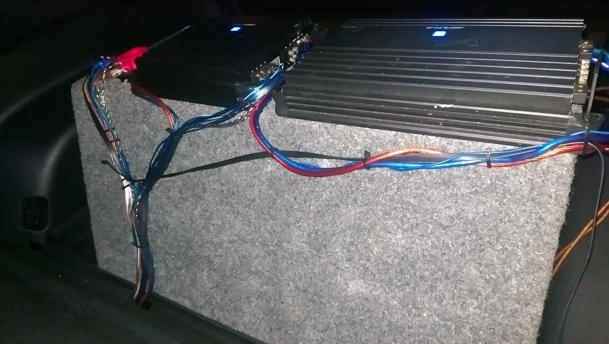

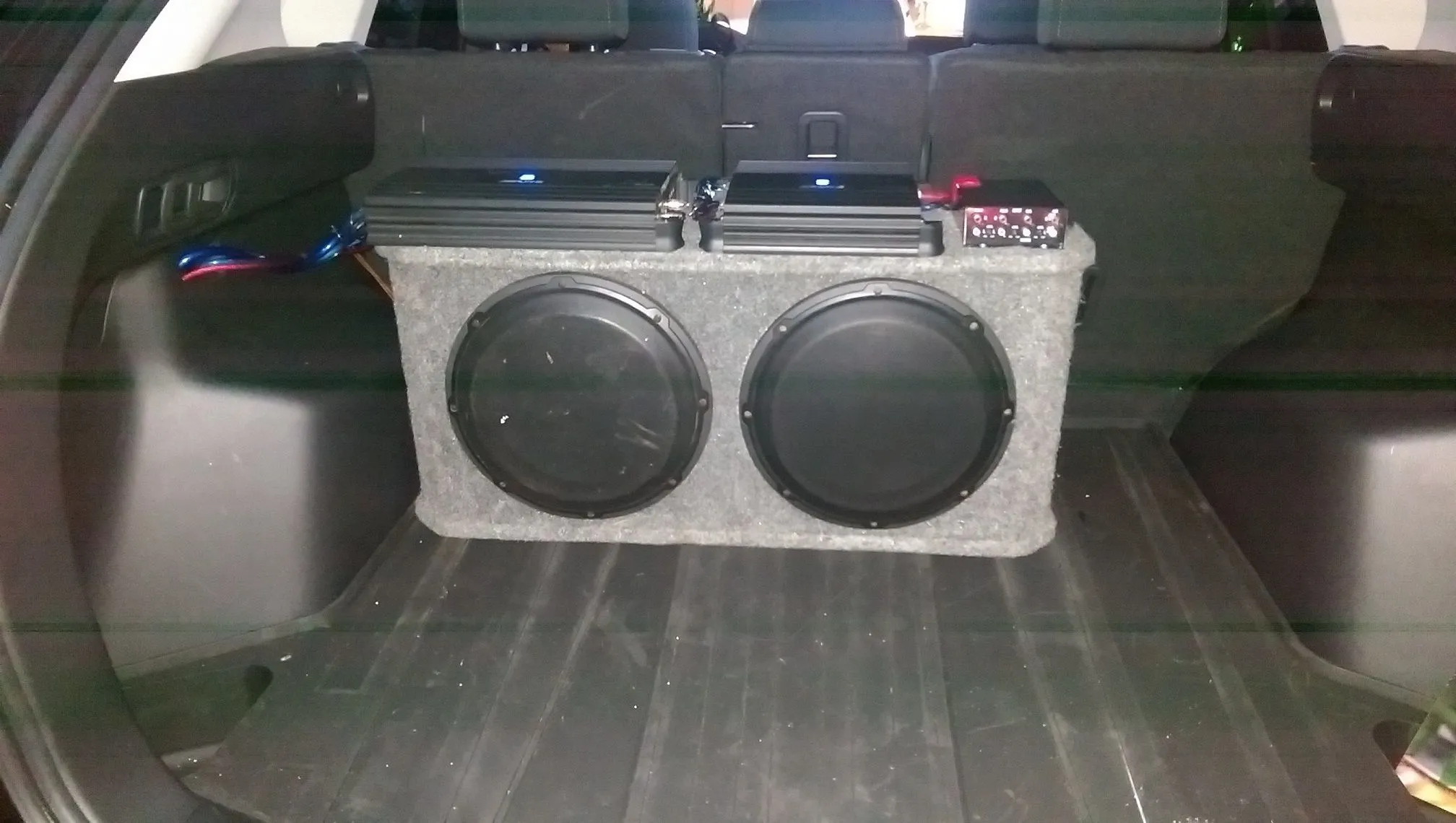

If your looking for some sub's for your Mazda you might want to check out the ones I'm going to try. They should fit under the rear seat but you will need to pull up the rear seat to mount them. They will be out of sight so no one will know their there.
Pioneer TS-SWX2502 compact subs
Which amp are you going to use with the Pioneer TS-SWX2502? Will it be on one side of the seats while the sub is on the other side? How do you plan on running wires? I have the non-Bose 6-speaker, while the front seat got some bass, the rear seats basically have none, having a sub back there would be great if it can be out of sight. If you are going to try, please take pics and document the process, very appreciate it. Thanks.

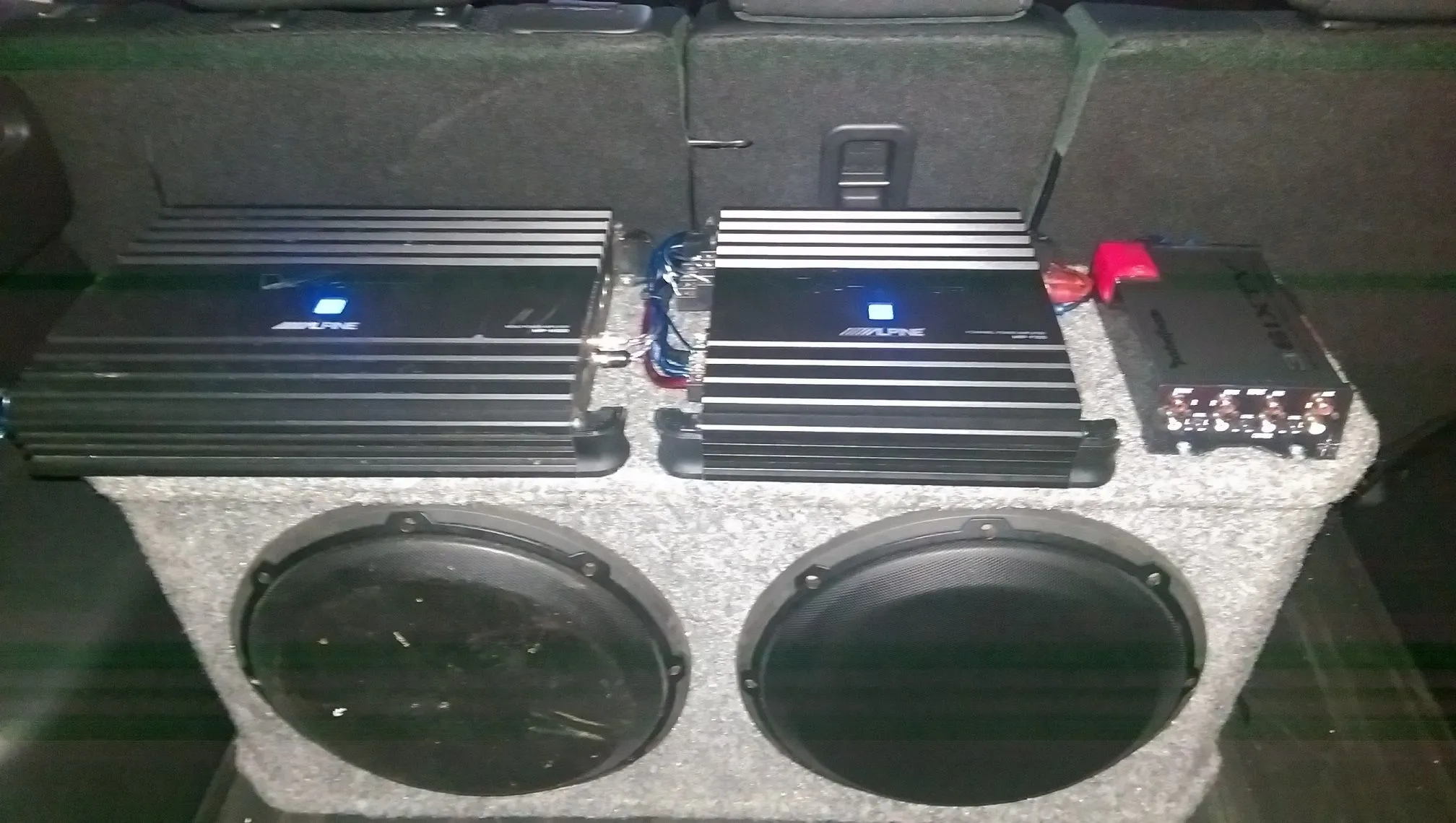

Signal processor - Well I got a Rockford Fosgate 3sixty.2 coming soon.
Door speaker amp - ALPINE MRP-F300 600w 4 channel class ab amp
Door speakers - ordering soon still looking for what will be best ( tis the season and got kids to get for )
Then of course I have my 1000 watt alpine mono class D amp and 2 12W3 JL AUDIO subs for my heavy bass.

I'm going to run a hifonics zeus zxr1216.1d mono block amp. I'm going to try and put one sub on each side under the seat with the amp in the middle. I'm going to run the amp at 2 ohms pushing 600w rms. My plan is to mount the Zeus 4 Chanel under the front passenger seat for my door speakers. I was thinking of running all the wiring through the center console.
A stiffening cap is a must!!!! I have a boss audio 1farad cap that will support up to 1000w rms. I did see a sticker on the altenator that said 100A. I'm going to assume it's a 100 amp altinator but don't quote me on that.
With a cap you should be fine tho.

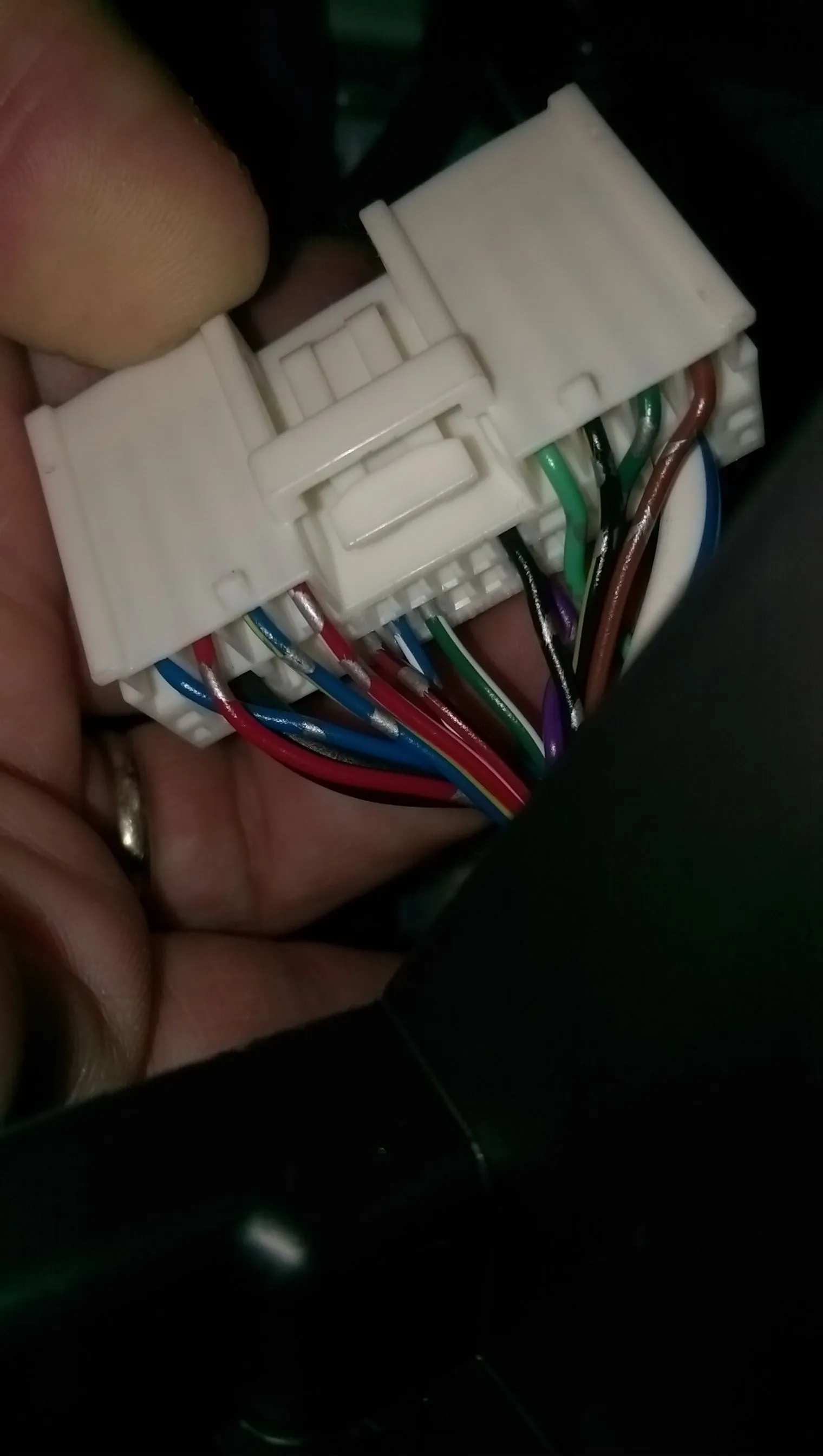

I replied in another thread as well and searched for a bit. Anyone have a 2016 cx-5 6 speaker pin out ? Also does the 6 speaker setup have a stock amp as well? Or was that a Bose one I read. -.- so many versions of speaker sets ugh.

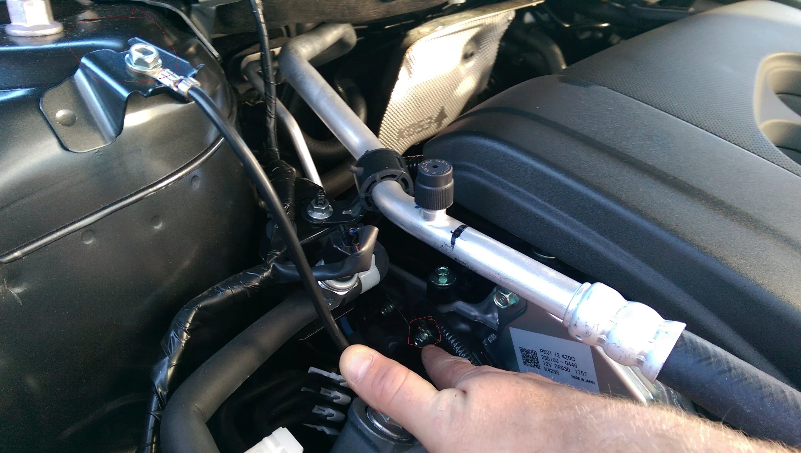

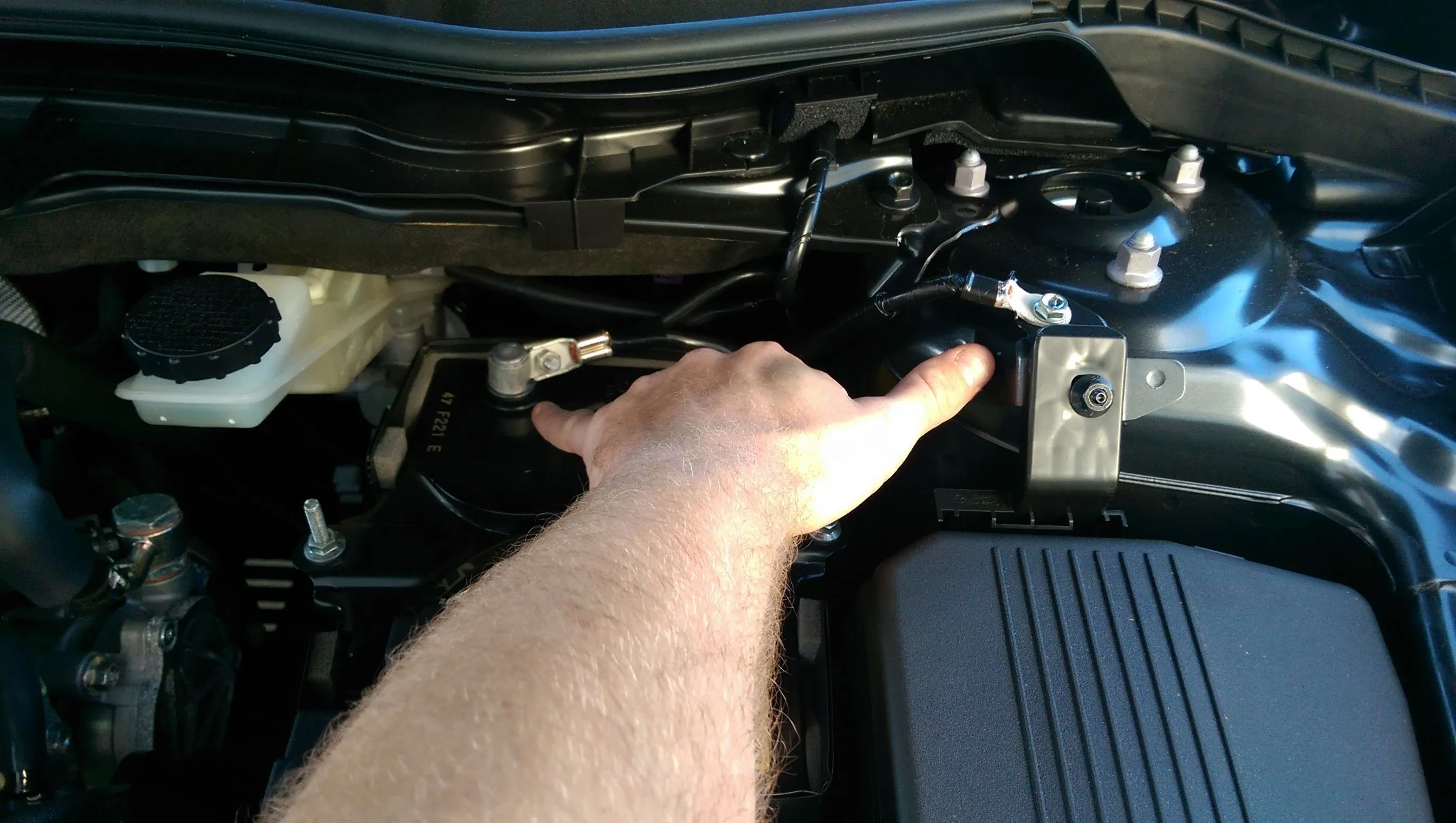

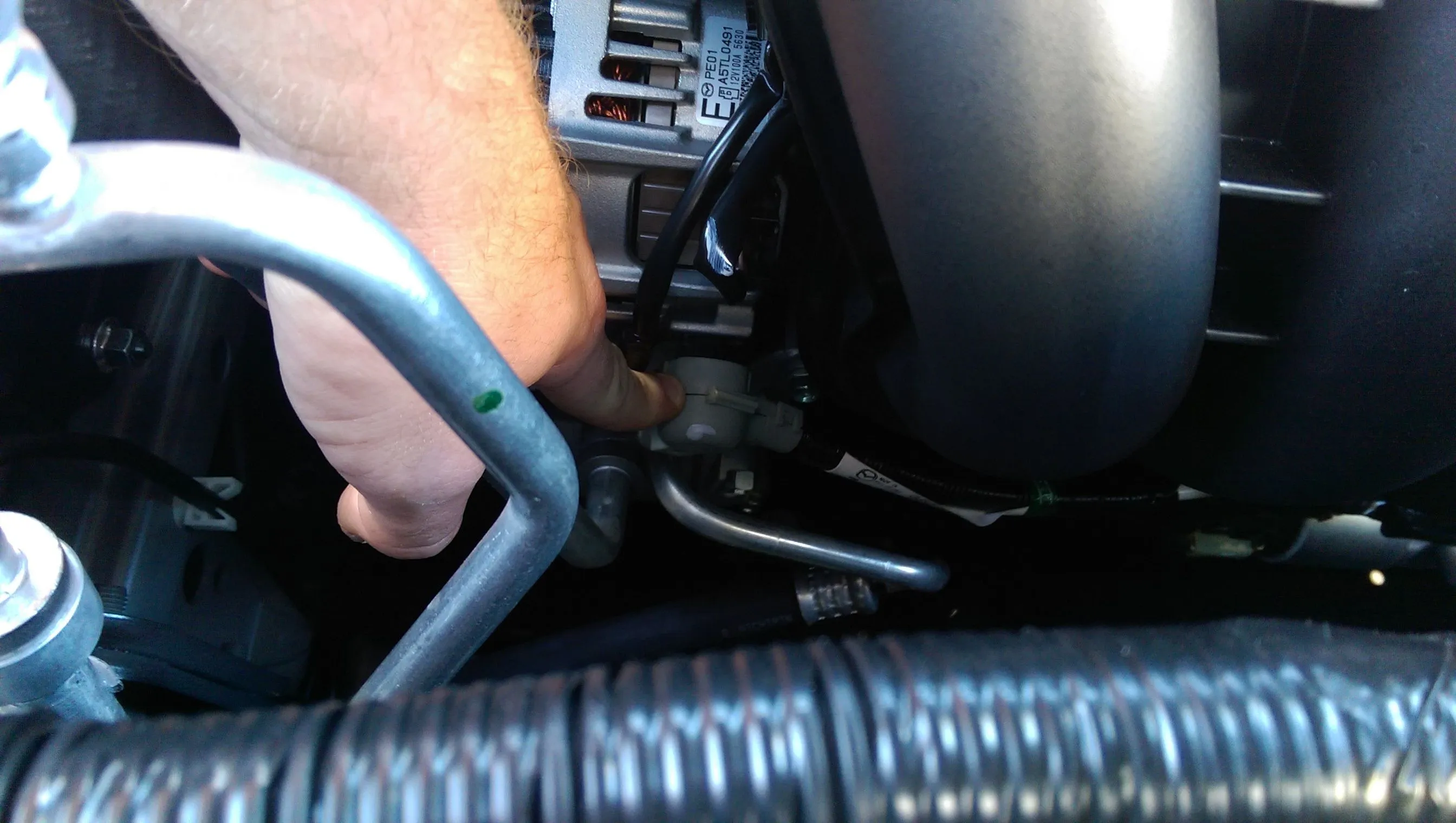

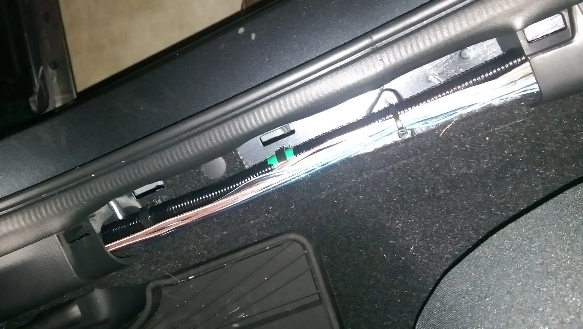

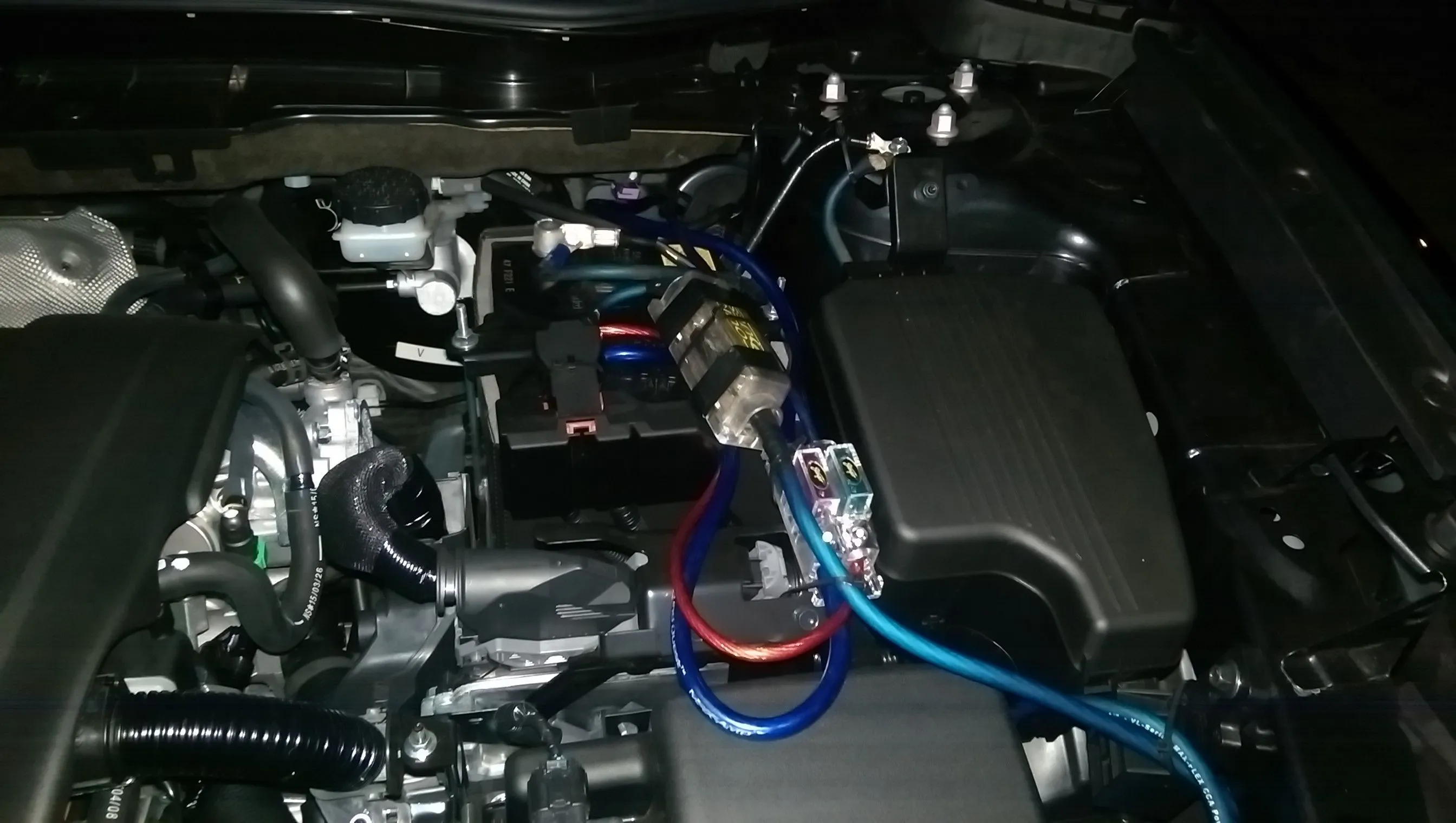

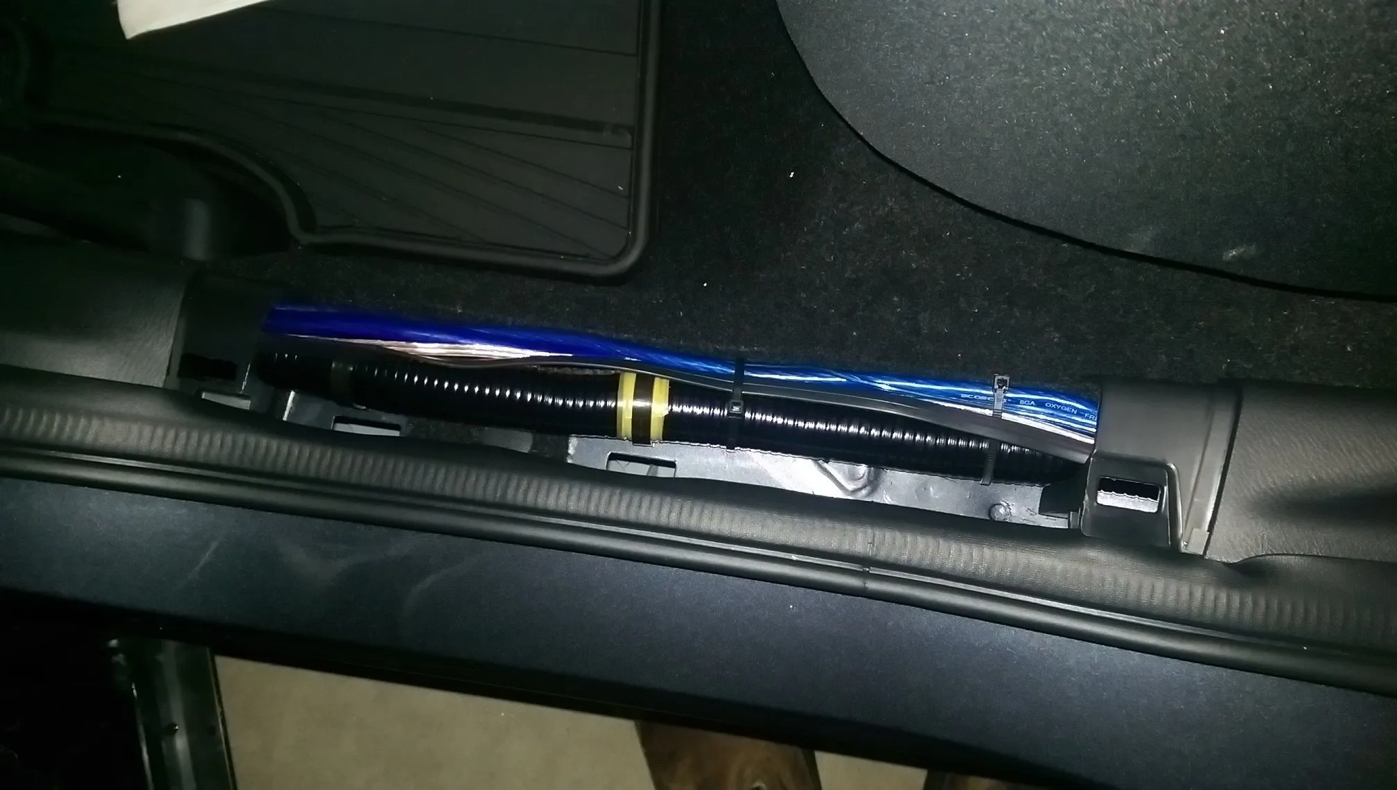

Well finally had a moment to look and get into the CX-5 to see what I am dealing with:
Here are pics of the big 3 if im not mistaken :

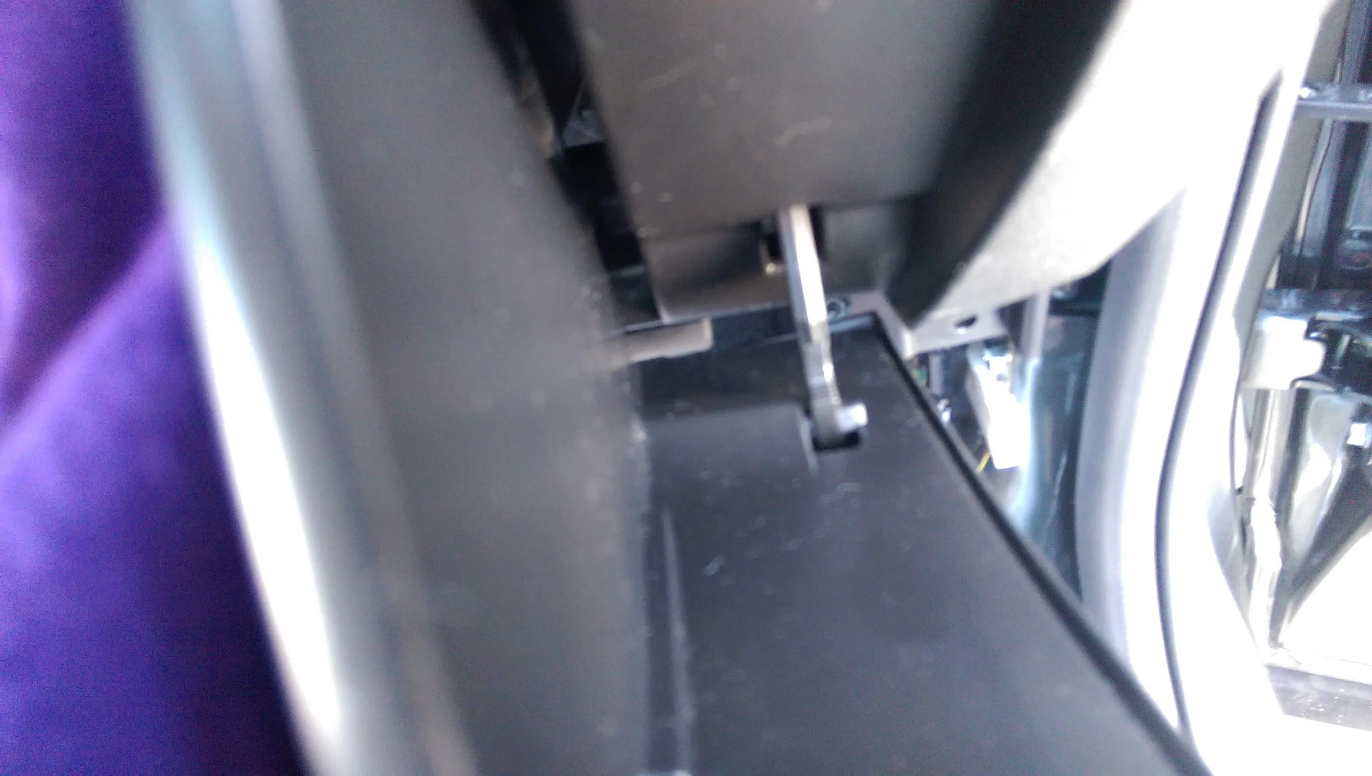

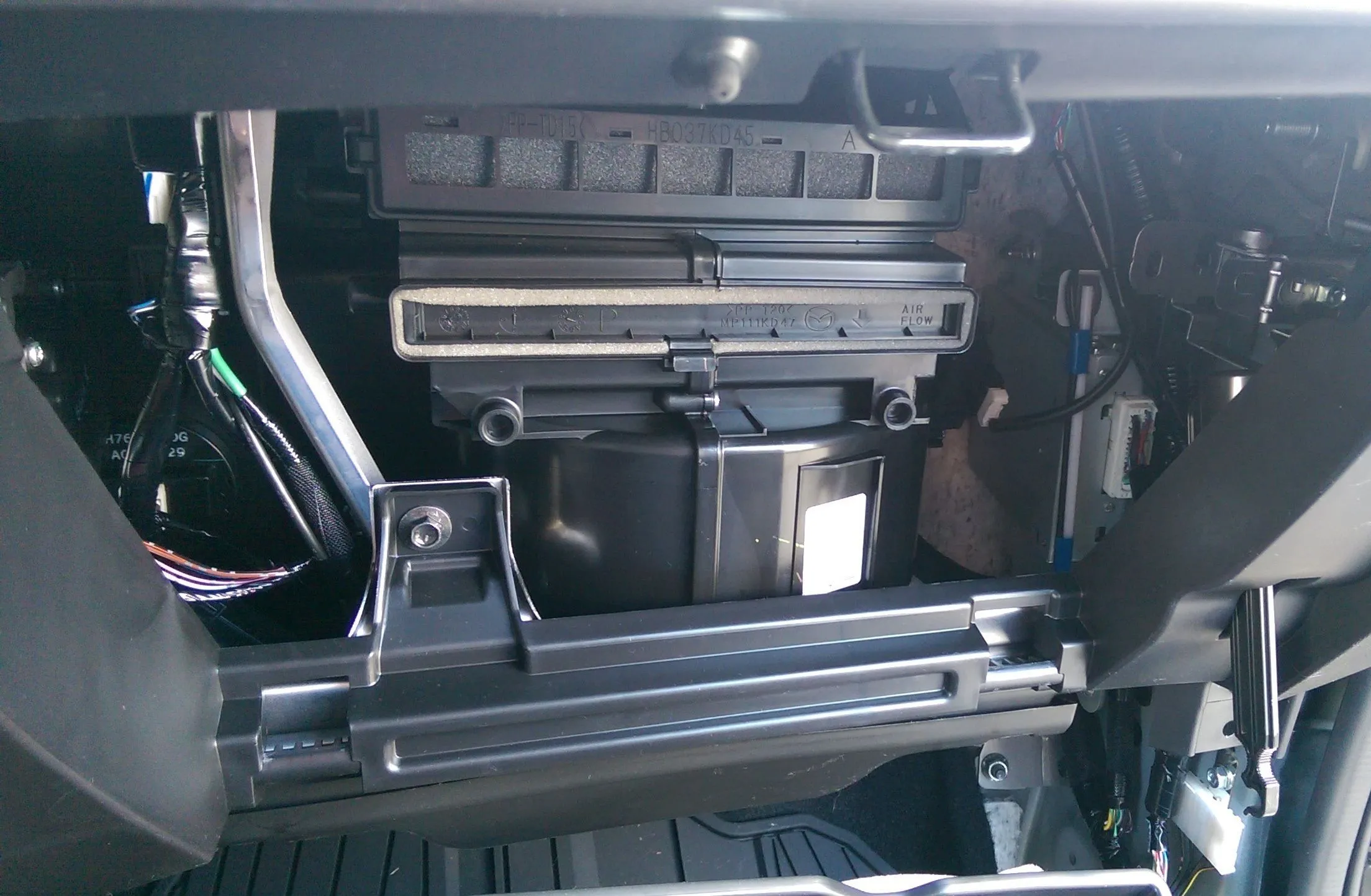

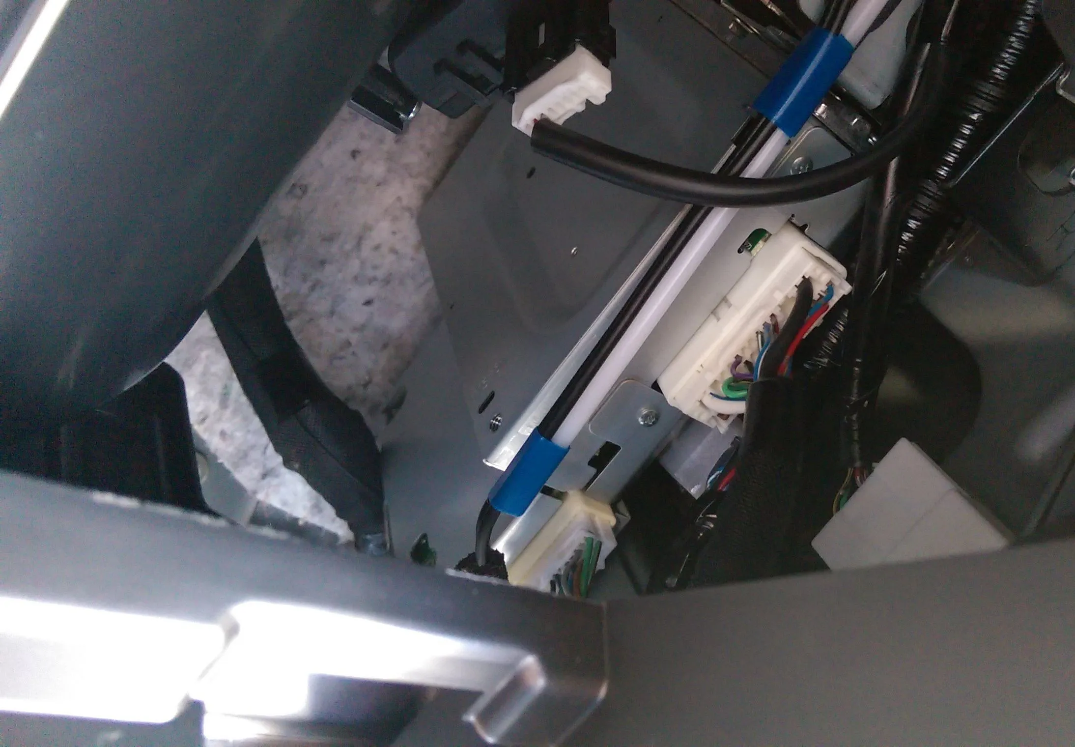

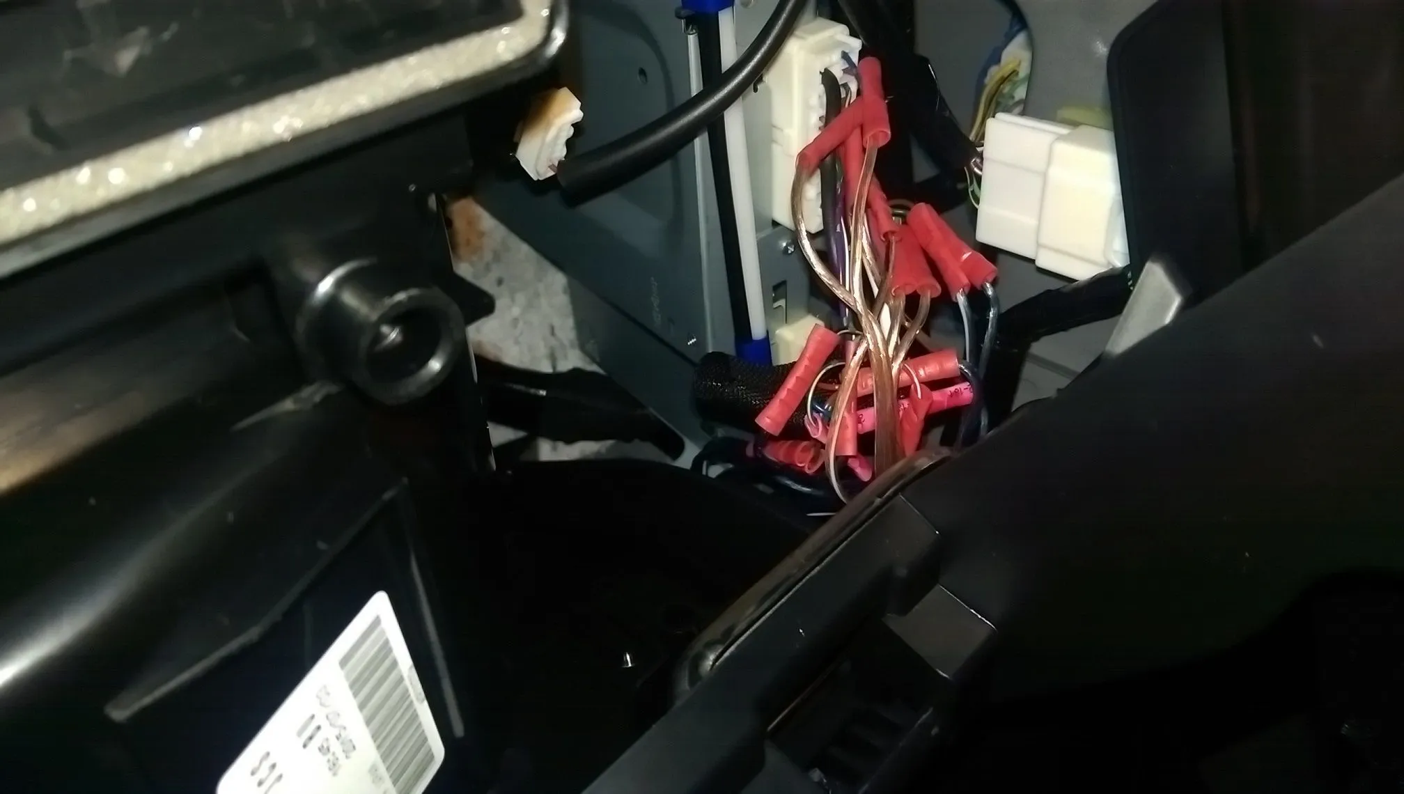

Easy way to get to the stock amp! simply take the glove box out and bam. its right there, no tools - no awkward positions - just easy as can be!
So what's your suggestion out of the two options you gave, adding to or replacing them? And I'm assuming by adding two, I'd be simply having 2 wires going to and from each location. Grounds I usually only add where amps are and usually to a seat bolt, ( and of course grinded or cleaned of any imperfections or obstruction ) what's more grounded than anything in the rear than seats bolted to the chassis. :p
I usually will just add to the factory wiring. Takes the complexity out of having to try and remove wiring that runs with other larger loomed harnesses. You got the alternator covered. As for the grounding locations you can be creative. I probably wouldn't re-use the factory spots but go to other locations. For instance the strut tower bolts or any other bracing brackets that are connected to solid pieces on the car. Same thing for the engine. Any solid metal points are good. I used to always use the intake manifold but they are almost always plastic now on cars.
Can also change out the factory battery terminals to a higher quality aftermarket one. Also leads to a cleaner install.
Yea I got some nice gold plated terminals.....if this battery were like my last car with screw in side mount :(. But I will. Already did the two grounds and will be throwing the aktenator part when I do the amps. Rather disengage battery once than multiple times. Btw, anything special in the cx 5 you have to do in the case of disconnect/reconnect battery?
Does that picture seriously have a remote wire hooked up to the battery -.- hahaha. Well besides doing 2 of the big 3, I have changed all Amber lights to LEDS, and hardwired a dual cig/usb charger and mounted it to unseeable area in the driver side footwell for hidden wiring of my GPS / ect and with the fuse insert it will also become my furture remote wire to the 3sixty.2.
With this said it's getting about time that I need to seriously debate how I'm going to wire these speakers to the 3sixty.2.
How I wire these speakers determines which speakers I buy.
Ways to wire the 3sixty.2
---- the 3sixty.2 has 4 speaker input/outputs, 1 center, 1 sub. Looking at wiring schematic and amp I see 4 speakers (8 wires +/-) this is the first confusion. Are the 3.5 dash and the front door speakers wired together??
Possible 3sixty.2 setups
1.) Hook dash/front doors together on the same output and put bass blockers on the dash to help preserve them from full range.
2.) Hook front dash alone and wire both front/rear speakers to the same output.
3.) Dash on their own / front door on their own, and rear on center ( no left right )
***of course sub will be for the sub on all setups.****
**also where is the dang dash speaker wires grrrr****
Can stock doors/dash handle the 600watt amplifier temporarily?
And per schematics. Dash and front doors are hooked together so hookup shouldn't be hard.
