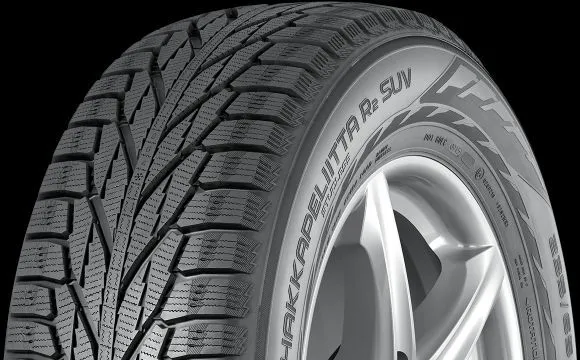

Now I can sit back and wait for the fall rebate promotions to come around on the winter tires and do some more research on the many choices. The Pirellis are maybe still on the contender list along with the WS80 Bridgestone Blizzaks and Nokian Hakka R2 SUVs.
attachment.php
attachment.php
