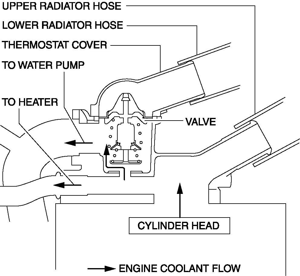

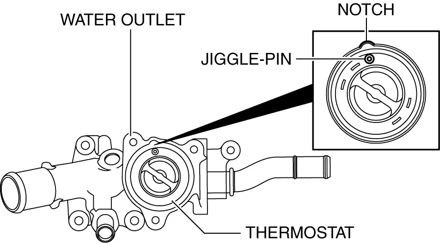

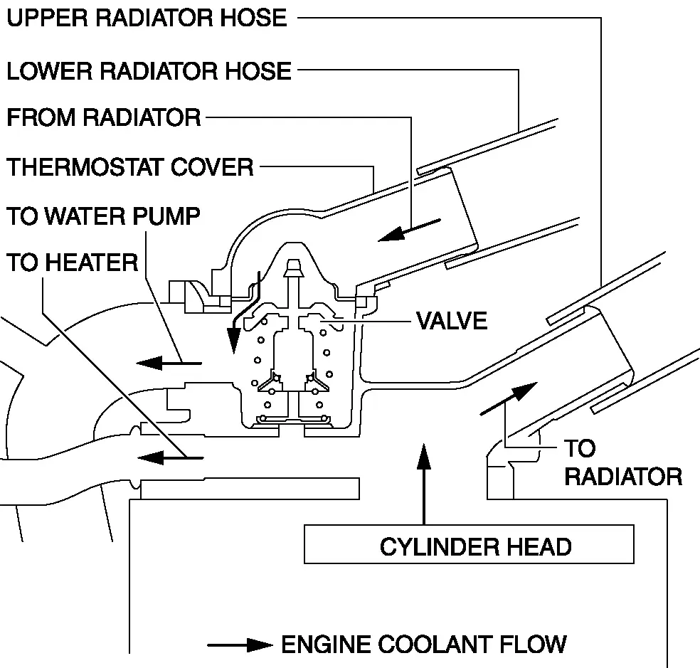

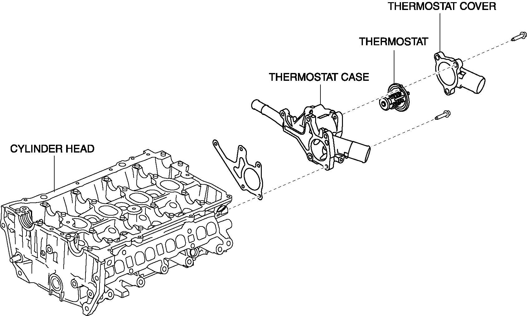

See if your thermostat isn't backwards.
Update. I have a few diagrams on the thermostat and it is in the correct way. I just heard back from the dealership. I reluctantly agreed to let them flush the heater core themselves even though I already did it. They said it helped a little but its weak, pointing to a bad heater core. In case anyone is wondering how much that costs, The dealership quoted me $1,078.80. The car isn't even 2 and a half years and the heater core is bad! I called my usual shop to see what they would charge. They told me they would be calling mazda corporate because its ridiculous. So I called and they're supposed to call me on Monday once they confirm an answer. The car is around 43,000 miles and has regular maintenance done on time. Some people may have good experience with mazda quality, but I'm not one of them. I don't think I'll ever buy another mazda.The funny part is they told me replacing the heater core "should" take car of the check engine light.
