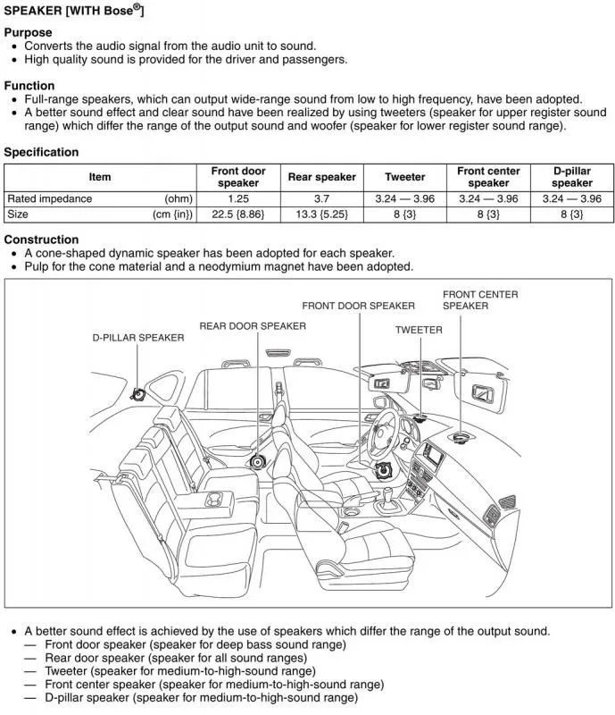

Since the Bose system is rated at around 1.25 ohms for the front door speakers, I'd be concerned that any 4 ohm speaker (which both of those options appear to be) would not have adequate volume/ooomph unless an amp designed to drive 4 ohm speakers was added. You also likely have to consider the power rating for any replacement speaker--most midbass and woofers are designed for use with an amplifier that is more powerful than what the Bose amp is probably sending to the front speakers. I've never run across the individual watts being sent to each of the Bose speakers from the amp, but I seem to recall that the total amp rating is "only" around 225 watts or something like that.
Finally, based on what others have noted, I think that one might be able to fit an 8" replacement, but I suspect 10" is too large.
One more related note--while helping my neighbor, I ran across this alternative speaker adapter which may be a better solution for the rear and eventually the front door. It seems to line up exactly with the factory mount points, and thus won't require any additional drilling as I had to do with my rear doors and the Scosche speaker adapter Crutchfield sent me. I also think the mount points for the non-Bose and Bose speakers are identical, but am not absolutely sure:
http://www.car-speaker-adapters.com/items.php?id=SAK112
http://www.car-speaker-adapters.com/items.php?id=SAK102
FYI for ease of reference
I may be able to live with a 4 ohm (2 ohm even better yet) speakers in the front doors depending on how much volume is lost. That said I've altered (not physically) the sound of my BOSE system by first changing my settings to fade 3 clicks to the rear, disable any center point crap, set treble to + 3 clicks, and set bass to + max clicks. My audio sources are 1. via a Samsung Galaxy s2 through bluetooth with some an app EQ intended for a flat EQ with slight emphasis for bass. It made the car's sound surprisingly better to my ears. 2. CDs it sounds less muddy to my ears with better bass response.
