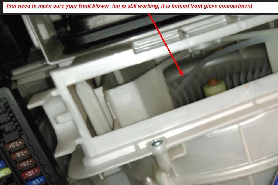

Absolute very first step is to check if the front blower is still operational.
First, we need to make absolutely sure we have a known good relay for the front circulation system
(rear relay has been confirmed by you that it is good, so go ahead and swap the rear relay to the front,
now we know for sure it's not a relay issue)
Next, go ahead and remove the front glove compartment box and cabin air filter cover so you can see the front blower blades.
Start the car and turn on full blast front mode air and check to see if the front blower blades are moving
If the fan blades are not moving, then that's your culprit, and you need a new front blower, the clogged condensed water line must have short circuited and damaged it.

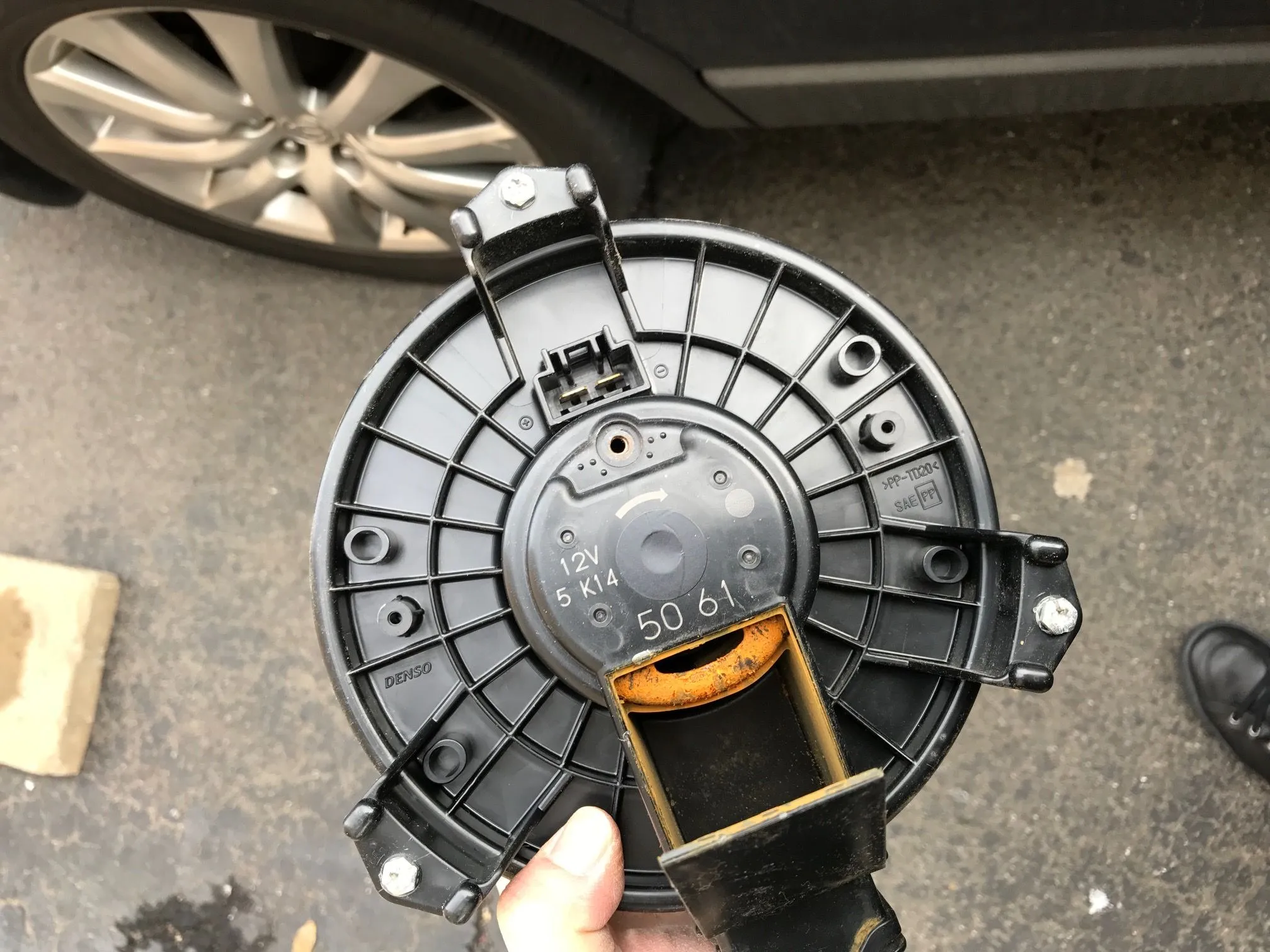

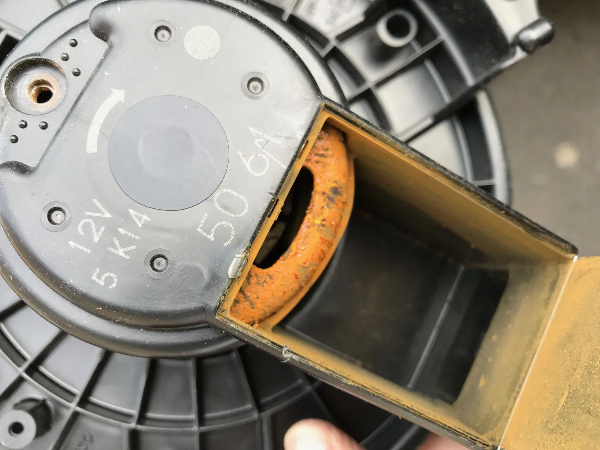

1st image show 3 screws that hold motor, lid and rust/corrosion. 2nd image is up close of rust/corrosion.
View attachment 218050View attachment 218051
That's what mine looked like, too. I dried it out the best I could, but it never was the same. It would run, but only at wildly inconsistent speeds - if you manually set it to full blast, it would spin up, slow down, stop, etc., for random lengths of time and intervals.
I replaced it with a much cheaper aftermarket blower (1/10 the price or so of OEM). The aftermarket part is louder, and has lasted a couple years now. However, it is now making some "musical" noises periodically, so it might be time for another.
Thanks for additional information about aftermarket part.
