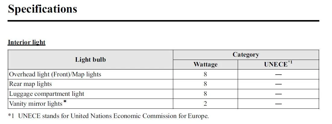

All bulb types for the 2016 are shown on page 9-7 (Specifications section) of the owners manual that came with your car(you can also download it in pdf at Mazda.com)
Not trying to be an A**hole, but thanks for nothing: interior light.JPG
