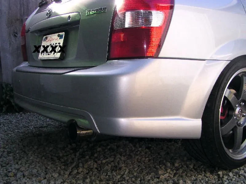

I loved the JIC exhaust I had on my P5. No drone, but a nice grumble.
attachment.php
