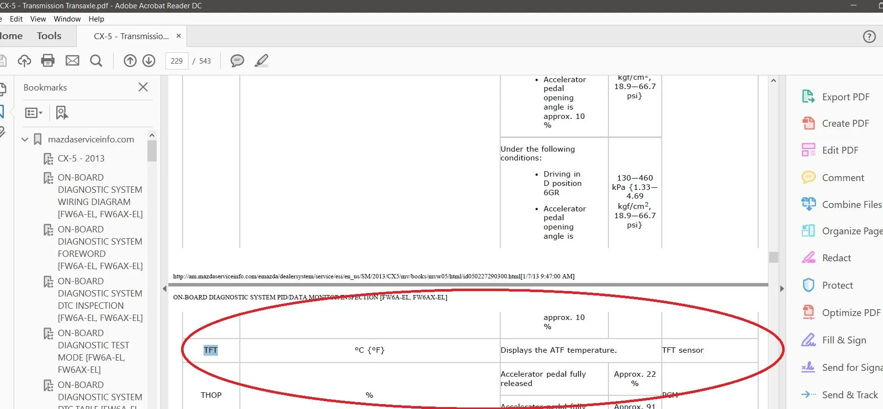

    Has to be a trans temp sensor somewhere, this is out of a 2013 service manual, the manual makes numerous references to trans temps

    I assume it would be onboard the valve body itself within the AT if not a separate sensor.
    I've also been looking around at AT rebuild documentation. It is listed as---> FW6A-EL
    http://www.makcotransmissionparts.co...df/FW6A-EL.pdf
    I thought I saw 3 different M-MDS temp sensors listed in FSM in regards to that ECM with #465 i diagram above.

    Here...I think it corresponds to number 446 on your diagram
    http://www.mcx5.org/transaxle_fluid_temperature_tft_sensor_fw6_a_el_fw 6_ax_el_-1000.htm

    Nice!!! Excellent find. :-) That seals it for me. It's there..
    EDIT: Just for the METADATA searches :-) ... CX-5 has an AT Automatic Transmission Temperature Sensor
    "The transaxle fluid temperature (TFT) sensor is integrated with the coupler component and installed to the control valve body."
