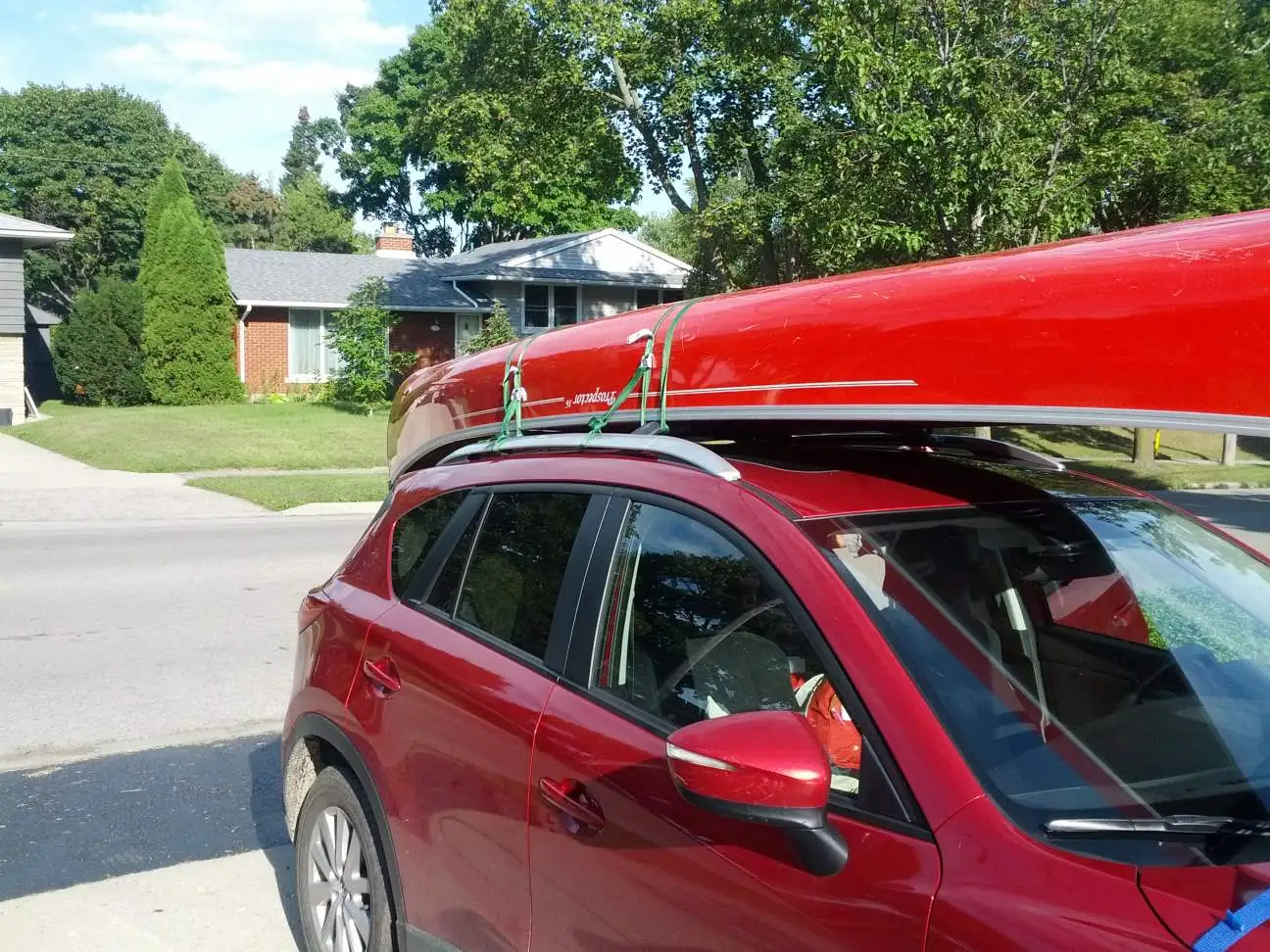

Just thought I'd post an update with my solution.

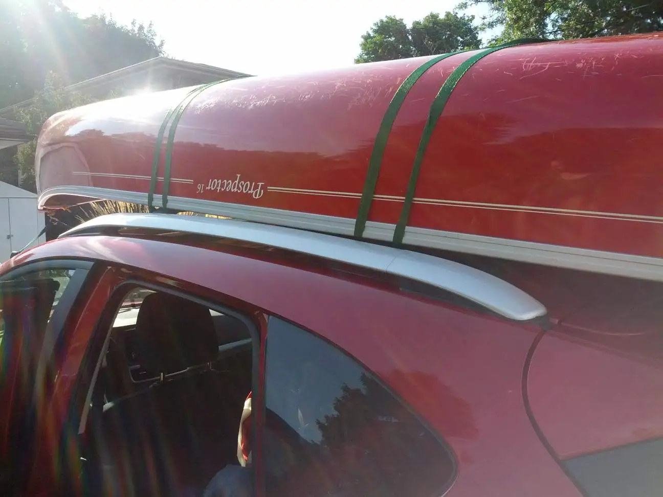

My canoe was too wide to fit on the flat part of the standard cross bars. I figured I'd buy a third party set which are wider. I tried SportRack SR-1009 and they didn't actually fit. Their fitting guide indicated that it works with the factory rack for 2013-2015 models, and all I can find indicate that the 2016 uses the same model of rack. Strange.
Anyways, I just put the canoe right on top of the cross bars. The canoe shifted to one side, but was stable anyways.

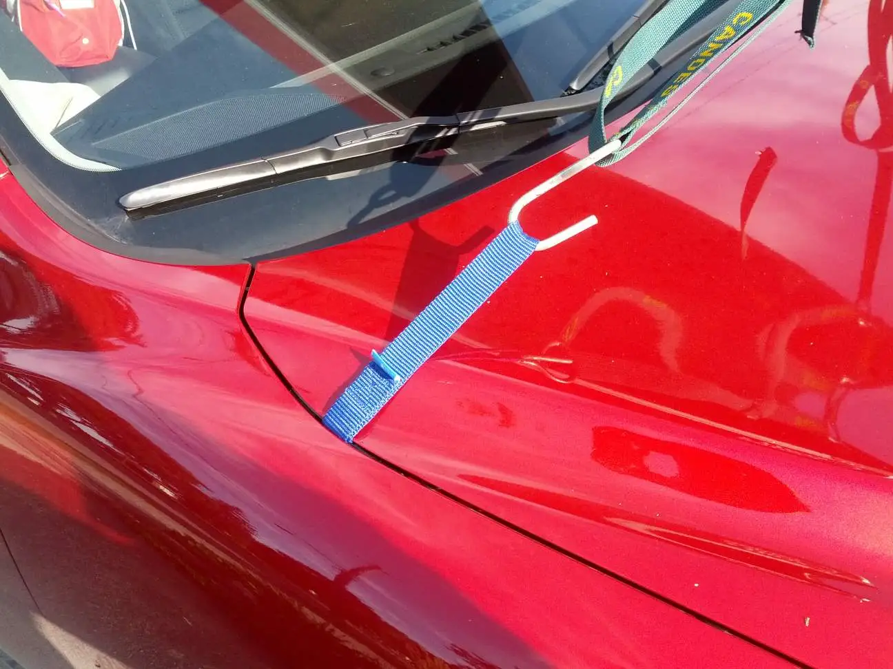

For tie down points, I picked up some hood tie downs: http://www.canadiantire.ca/en/pdp/hood-trunk-tie-down-0792477p.html
They worked great.

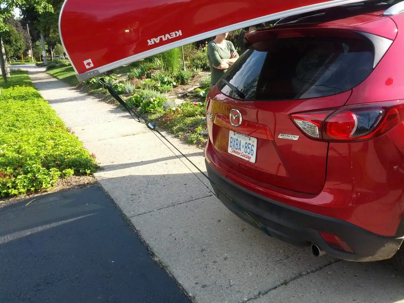

For the back, I just found a few holes under the frame and hooked in to them. Here are some pics:
