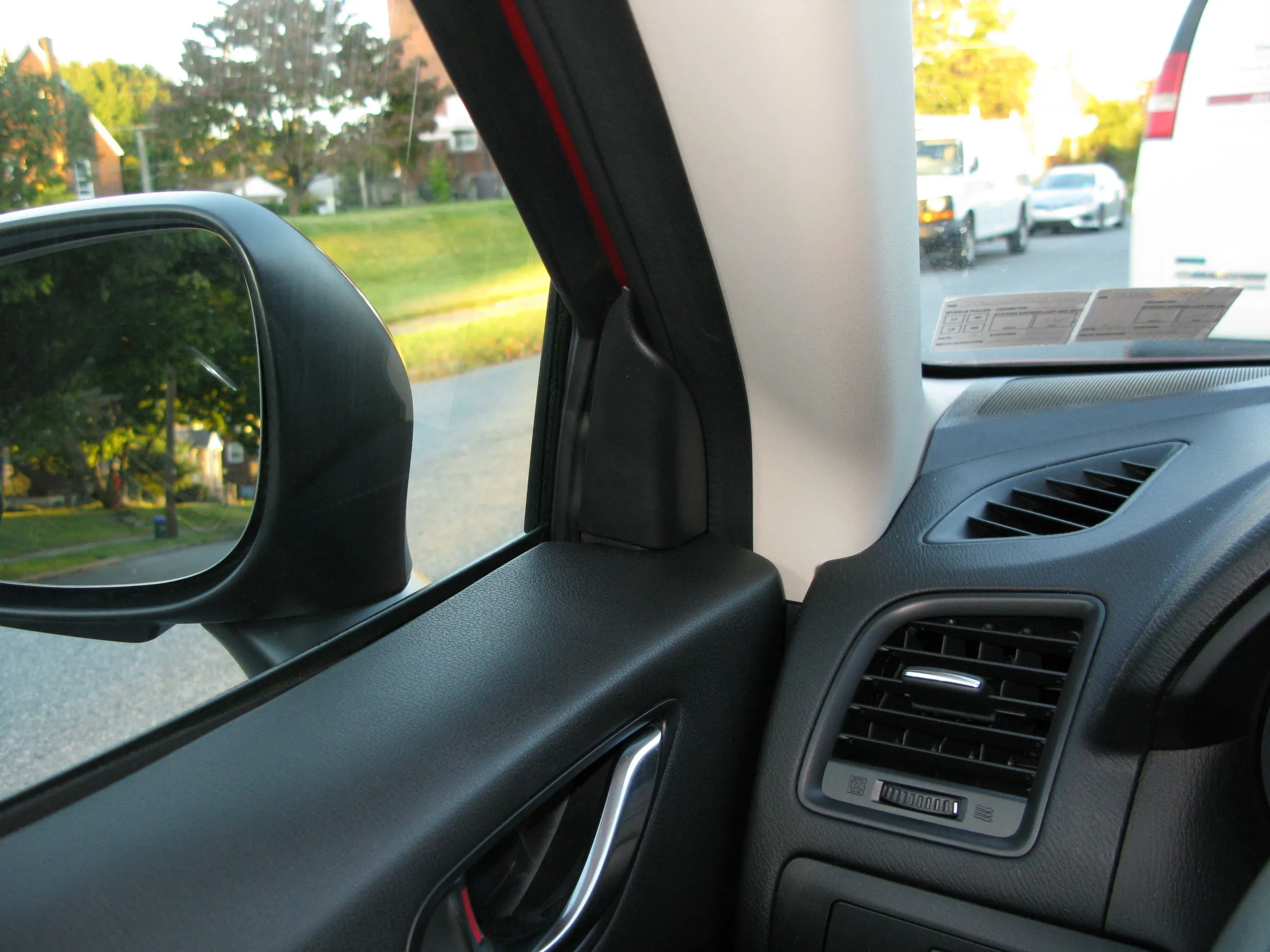

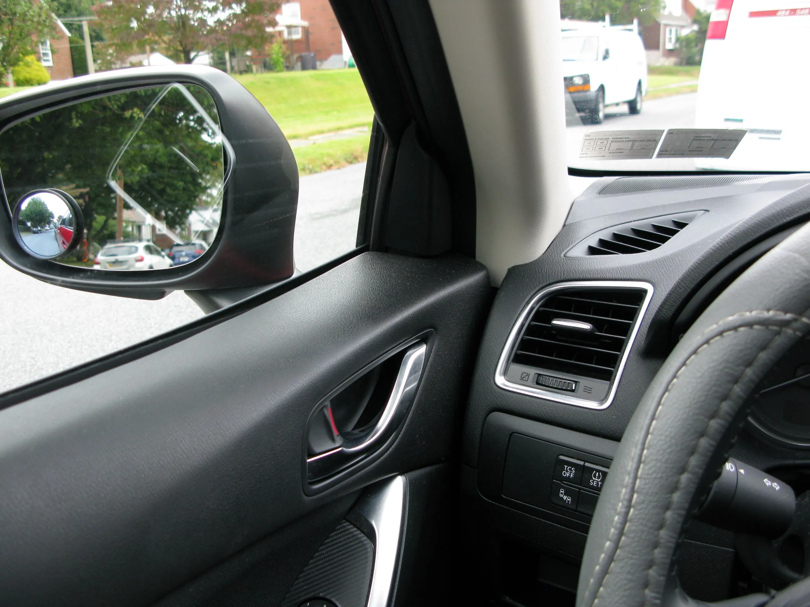

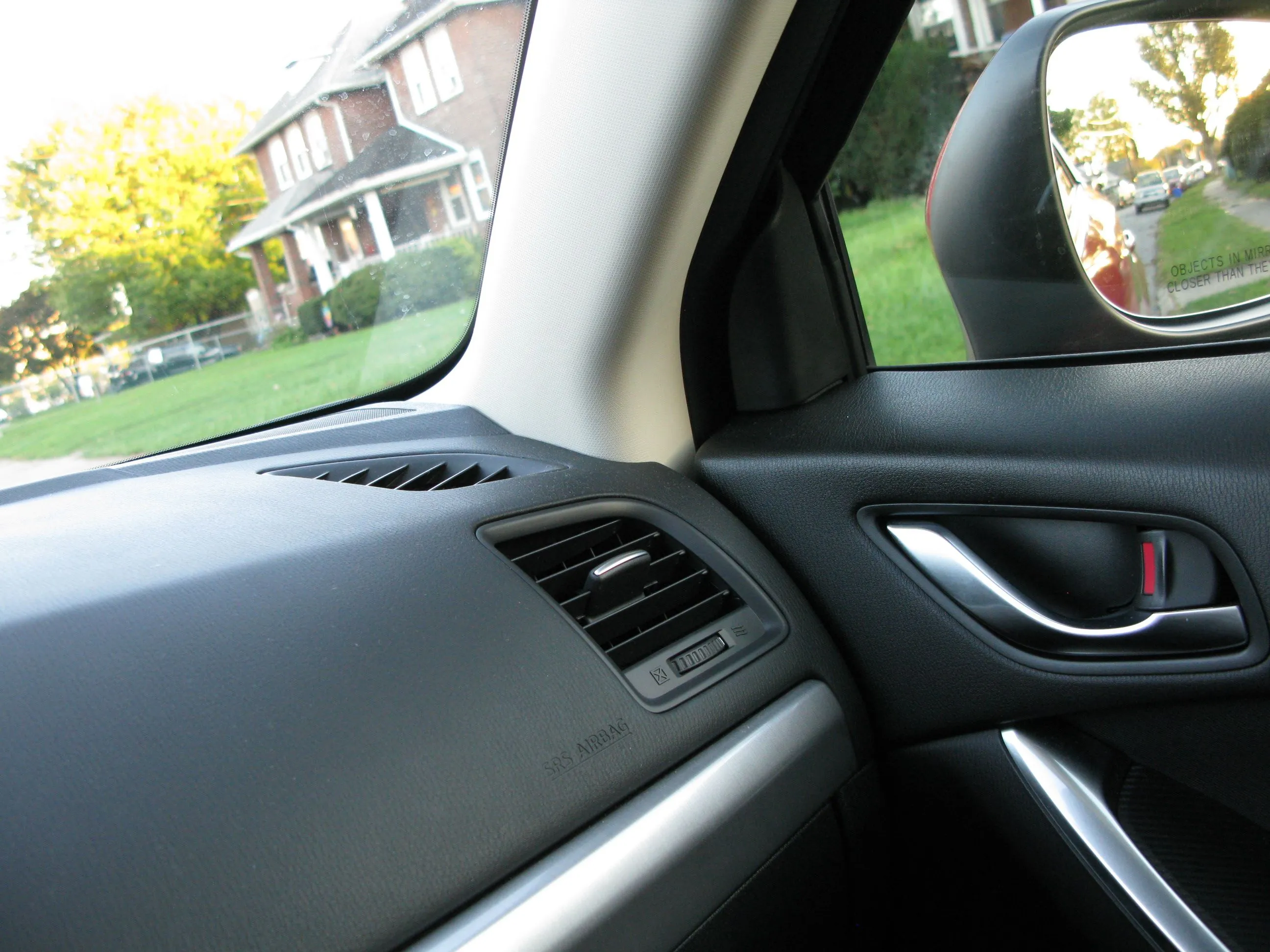

In the pictures below, you can see that the chrome trim can be removed independently of the black window below it. I wasn't sure which latch is which, so I detached the whole window first before removing the chrome trim.
