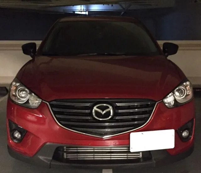

I changed to the new grill. It is not plug and play.
The metal bracket behind is different so you will need to change that.
I bought the oem parts directly from Japan through a friend so I can't remember exact prices.
I actually didn't know the updated metal bracket was required. So when I brought it to my mechanic to install he just took the original bracket out completely and made it fit without a replacement piece. Probably not recommended though haha

1. My CX-5 is a 2013 model
2.I wasn't around when my mechanic installed the grill, but I don't think the bumper valance has to be modified to fit. Only the top piece and maybe the metal bracket is different.
3.The new and old front emblems are different parts. Old: 51-740 vs New: 51-730
4. The bracket they're referring to is the round Black Emblem Holder.
The lower seal is the top plastic panel
Here's more info I found. This should be the complete list of parts needed for the swap, plus pic of the updated metal bracket
Mazda CX-5 KE 2014.11 -
Parts Number
KA0G-50-710B (Radiator grille)
KA0G-50-716D (Lower Seal) <--Top Plastic Panel
KD45-50-0K1B (Retainer) <-- Long Metal Bracket
KA0G-51-730 (Emblem)
KA0G-50-721A (Bracket) <-Emblem Holder
