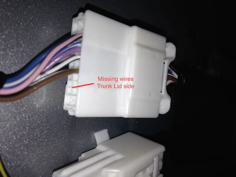

I did a bunch of reading on the mazda 3 forums and found that they have a plug in the trunk or in the liftgate on the wagons that have the wiring for the camera. I pulled the top plastic trim off the liftgate and I find that I have 4 wires in a plug that match the colors they have. My multimeter probing didn't yield much results so I'm a little purplexed at the moment but I did trace them back into the side panel where I find them passing through a plug to the vehicle harness so they appear to be hooked up.
It's possible they don't connect at the head unit or something. I'm still trying to ascertain if I should see 6vdc at the plug when the vehicle is running or what the story is.

A couple of pictures I snapped:

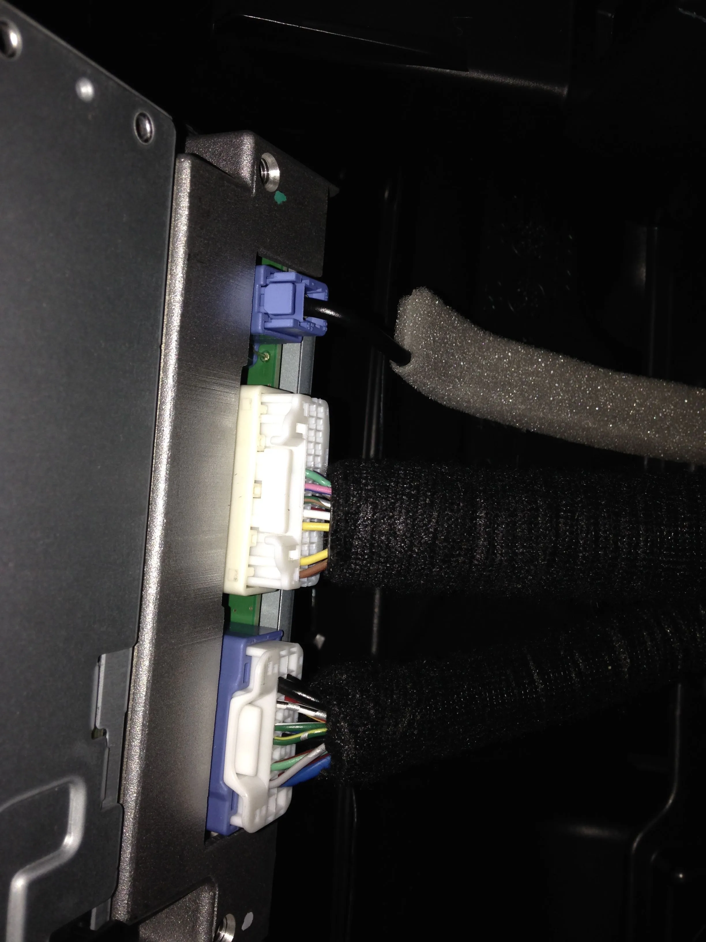

I decided to take a look behind the head unit this afternoon. Accidentally dropping a screw into what I feared was the vent system caused me to be one of if not the first to remove the center console. It was easy once I figured it out but wasn't obvious.

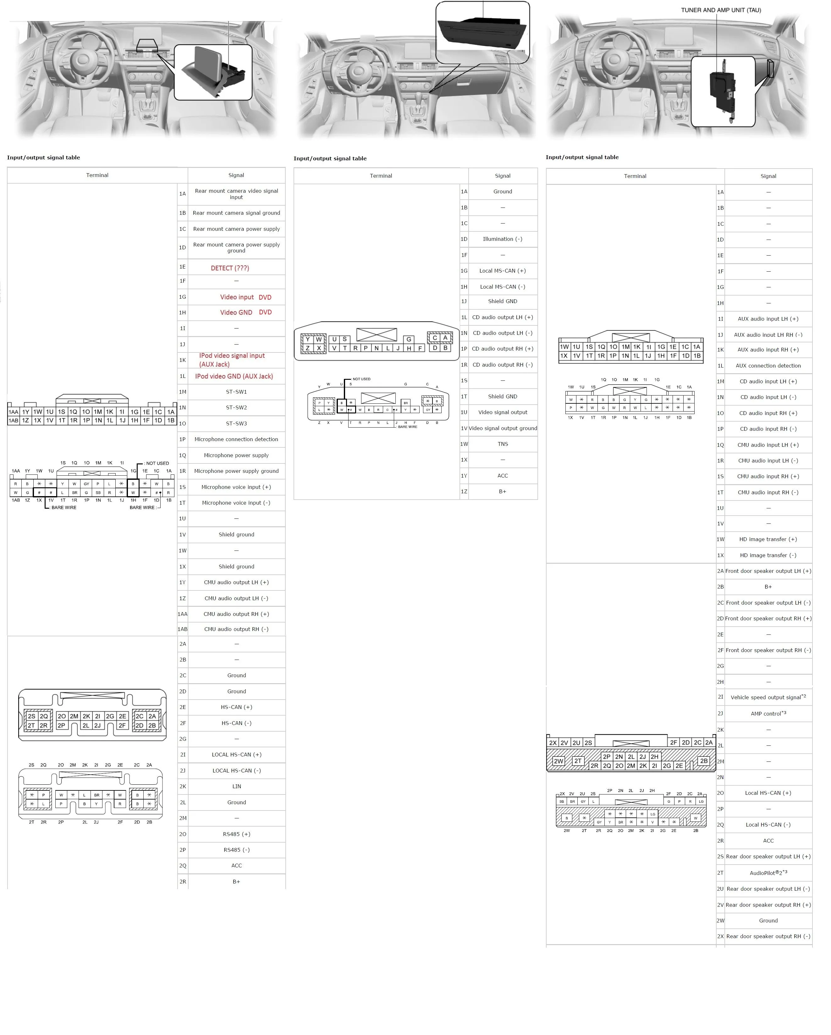

I'm now fairly sure the wiring isn't there for the camera. What's strange is I think it is at the gate but someplace between there and the HU it disappears. The mazda 3 has three separate pieces, the screen, cd player and amp/fm radio. The cx-5 combines the screen and cd player into one unit. They are really just bolted together.
Going off the mazda three pinouts which definitely appear to match mine, the wires for the camera are MIA.
You can see 1a, 1b, 1c, 1d in the first plug on the screen unit is for backup camera.
My plug:
You can see all the empty pins... I think that's where the camera should be.

I used 1A,1B,1C,1D on the diagram linked above (Mazda 3 radio pinout2)
A is video
B is video ground
C is +6vDC
D is ground
