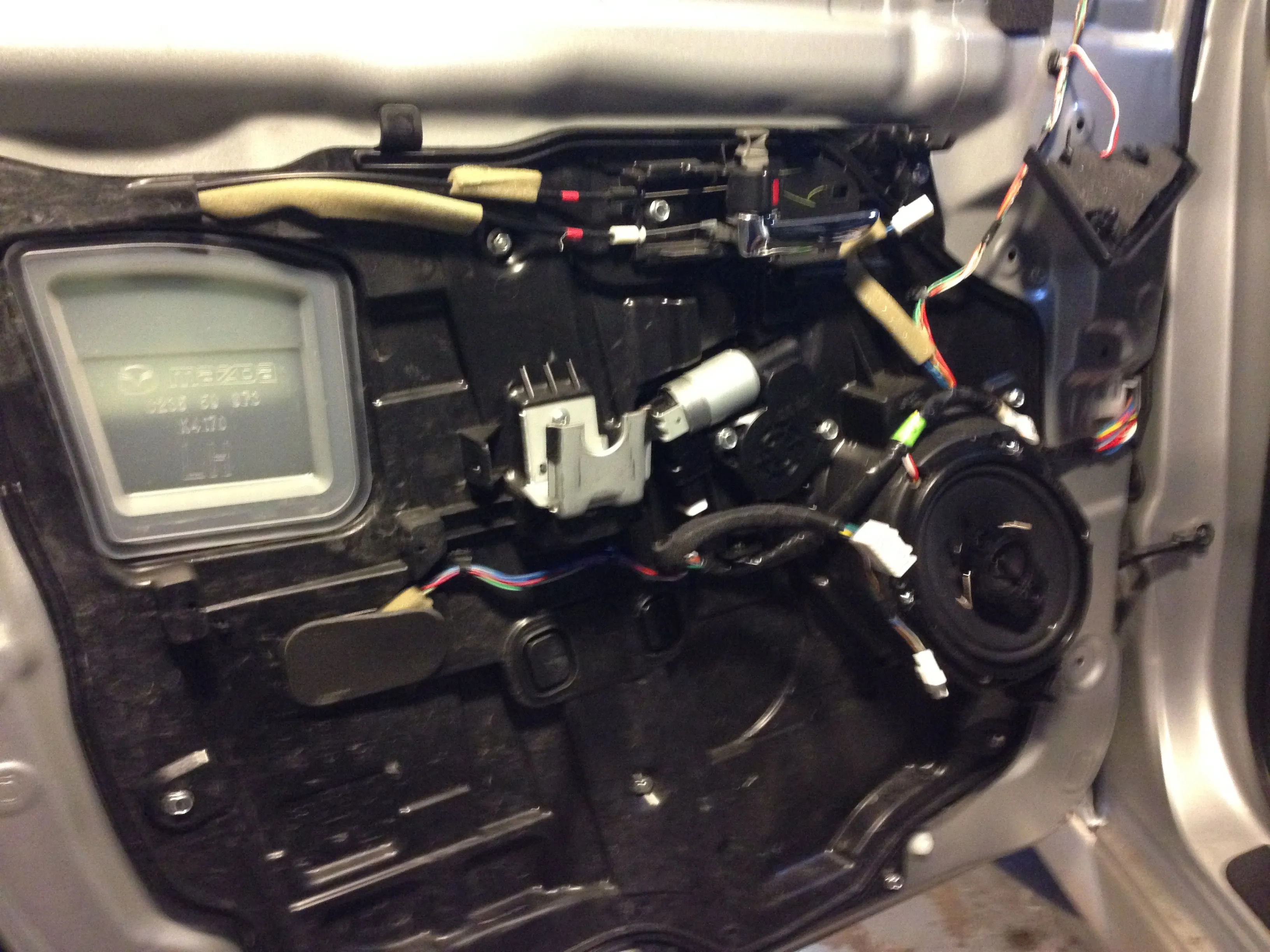

Image 1: IMG_2047.JPG
The first image is an overview of the backside of the drivers side front door card(panel). Disassembling the door is fairly straight forward, but your enemy is the plastic fasteners that hold the door cards(panels) on. The Crutchfield diagram doesn't give a good representation of these, so here they are. Panel pry tools are your friend here.

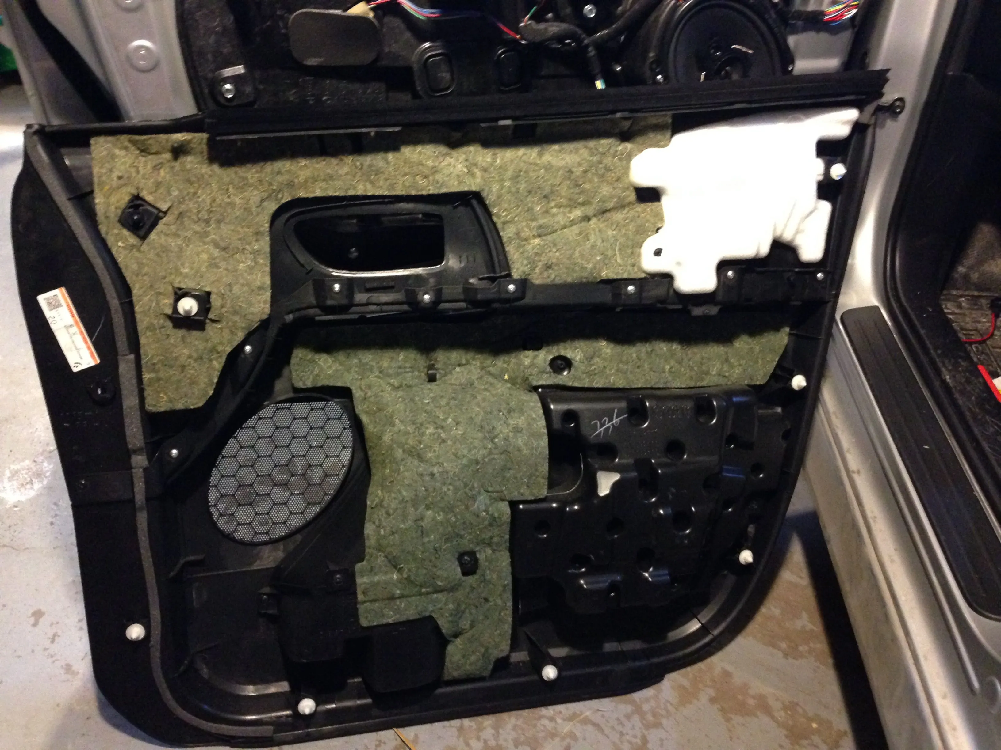

This is the drivers side door taken apart. You can see where the speaker is and it's a simple removal with a Philips screwdriver. However, the speaker is usually "stuck" to its mounting position. Whether this is from time and/or the way the door is assembled at the factory, I don't know. But you will have to gently pry the speaker off the door with a flat screwdriver or some other prying tool.

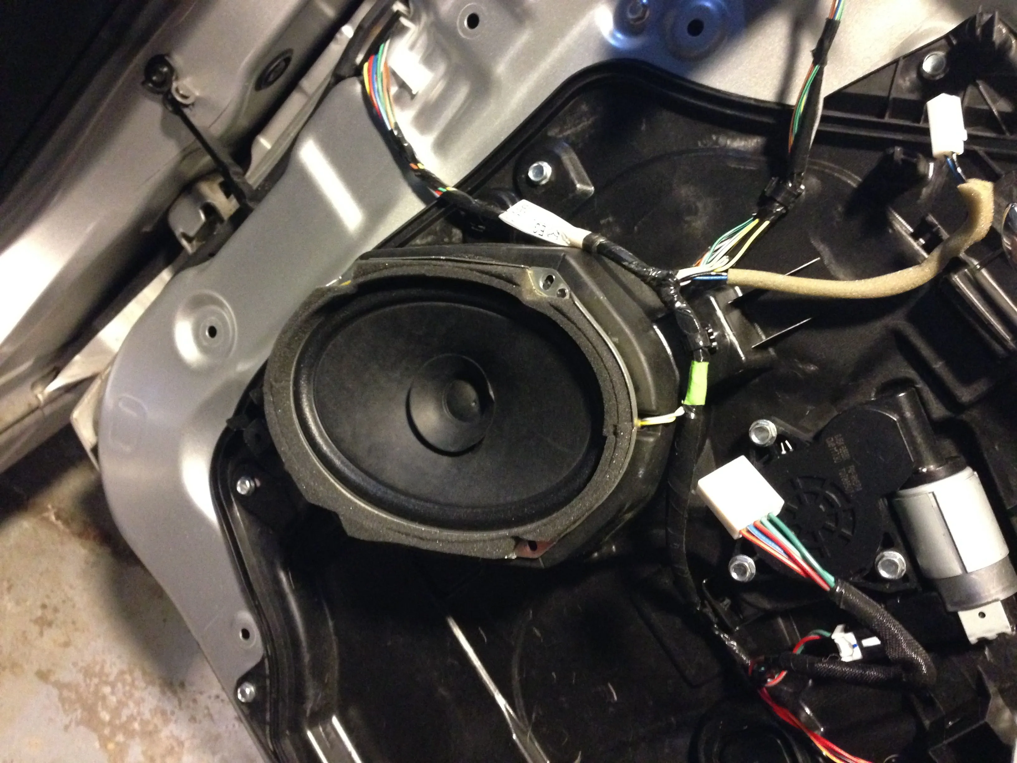

Close up of plastic fastener. I nearly broke some of them, but not so much they weren't usable. Lessons learned from the drivers side made the passenger side door much easier!

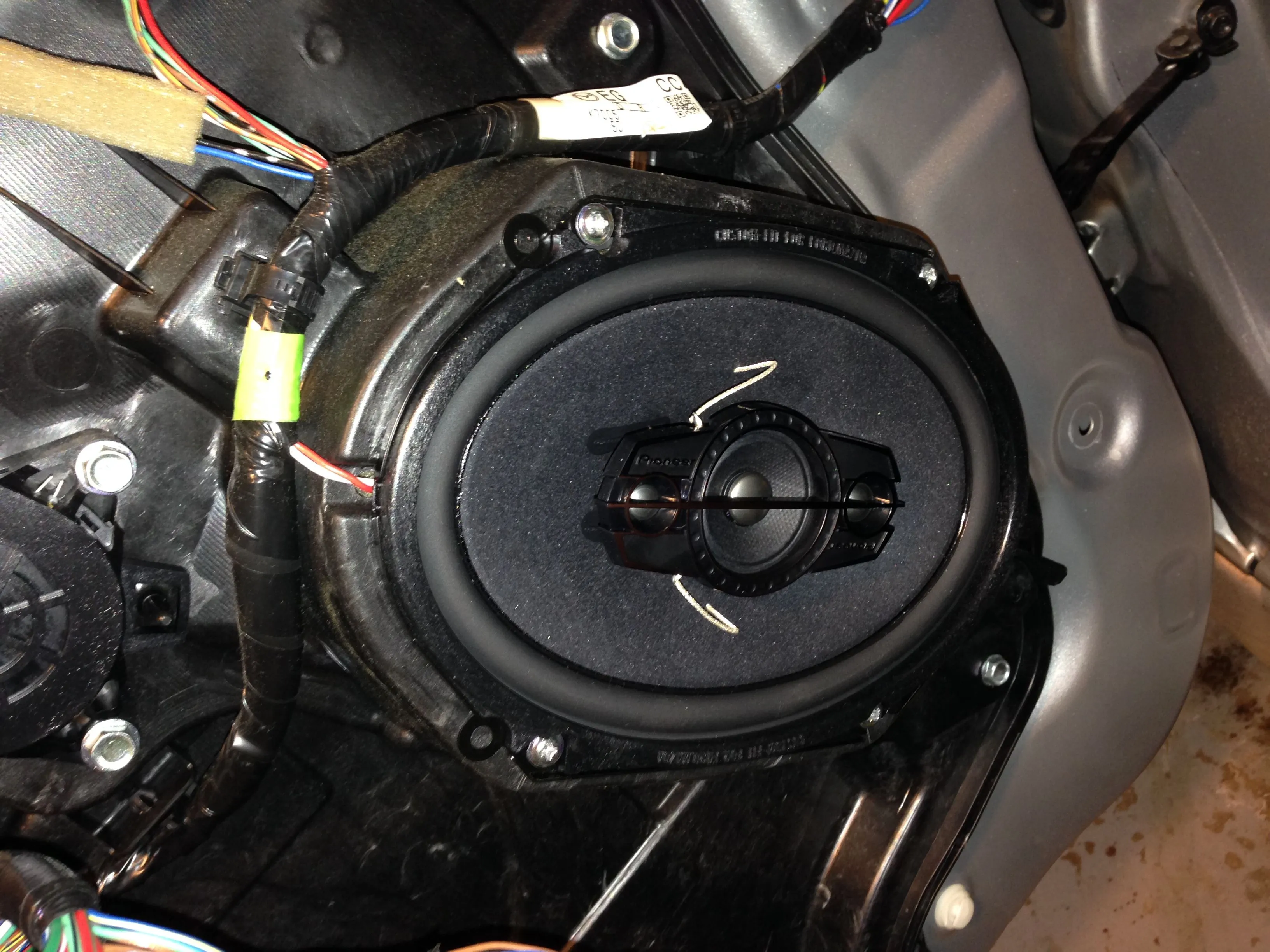

The original factory speaker in the passenger side door. The last car I did speakers on was an 01 Ford Focus ZX3, with which the 5 shares a lineage with. I'm pretty sure I pulled these same 6x8's out of that car too, they just weren't stamped Mazda on the back.

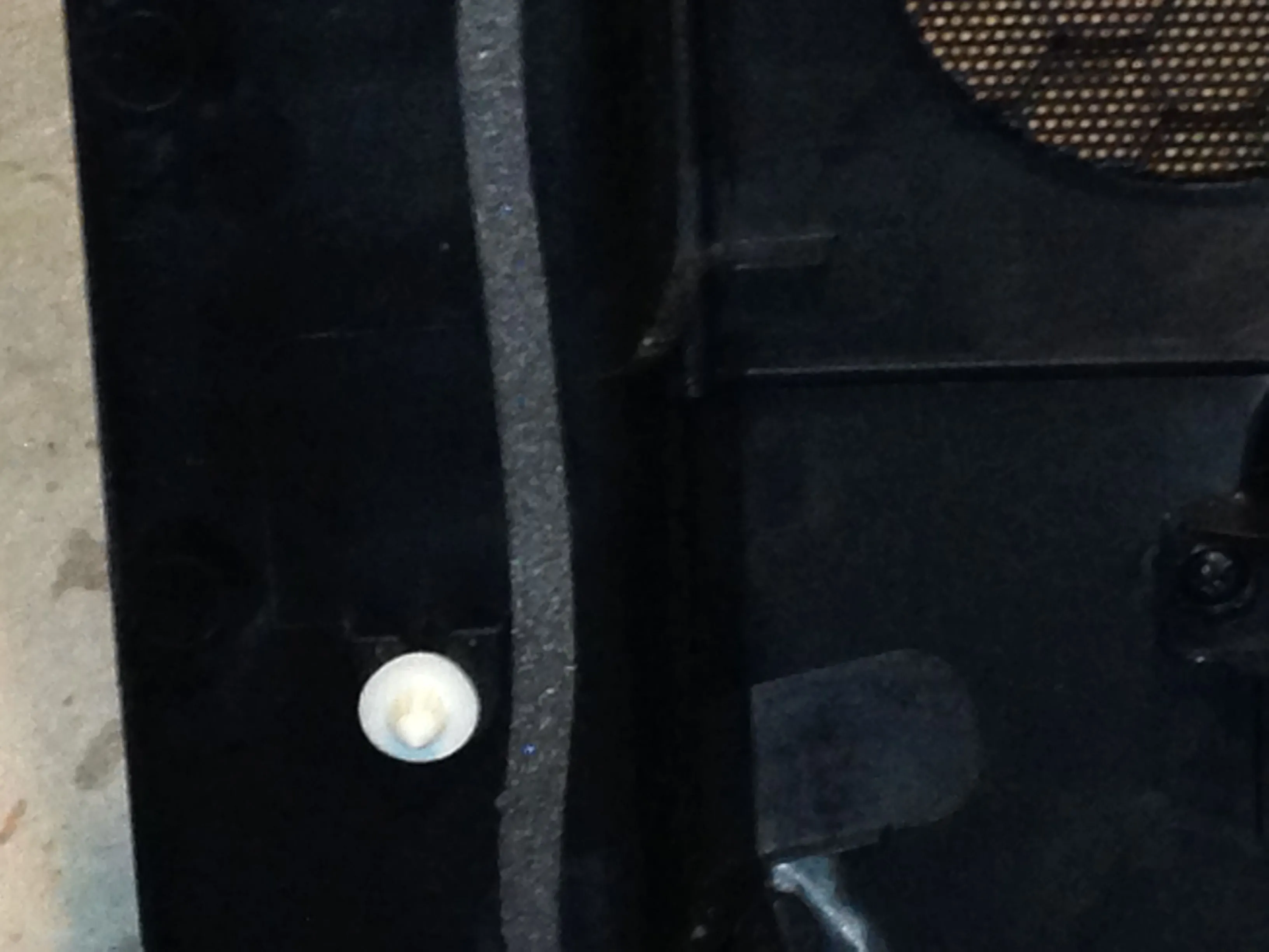

The new Pioneer 4-way 6x8 in its new home. The difference in sound quality is amazing, I wish I'd done it sooner. I thought the 4 way would be overkill since my 5 is a GT with the tweeters in the front door (not replaced) but it really wakes up the sound. I did dial back the treble a bit, but I don't have to have the volume as high when listening to public radio (all vocal) and music is just much tighter and cleaner all the way around. It's not going to "pound" but I can crank it up fairly loud (50) without suffering too much distortion.
