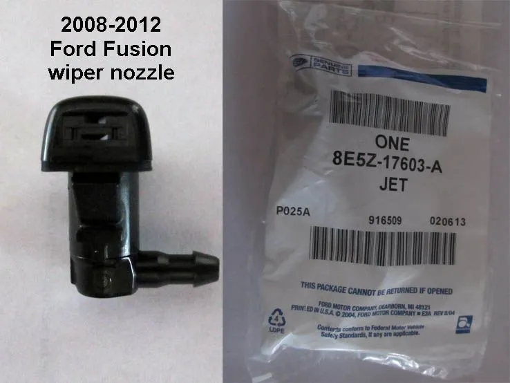

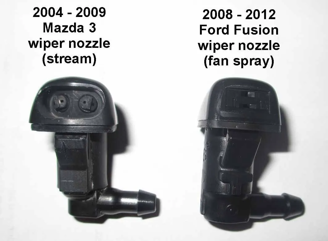

To simplify the process and keep things as clean under there as possible, I decided to look for a fan-spray nozzle with a 90 degree bend in the bottom part facing the same direction as the Mazda 3's. I finally found one: the 2008-2012 Ford Fusion nozzle is virtually identical to the 2004-2009 Mazda 3 one, except it has the fan-shaped spray pattern.
I bought them through the local Ford dealership for about $10 each.

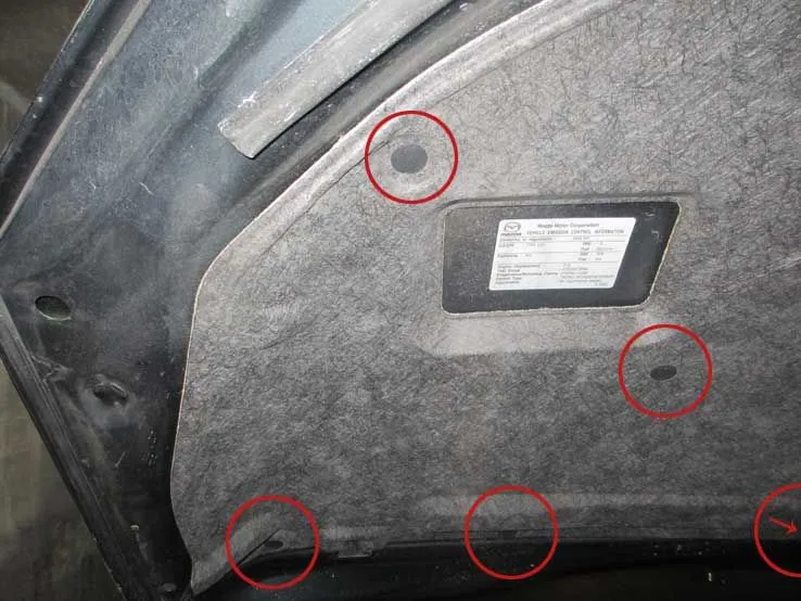

To access the washer nozzles from the underside of the hood, you must remove some of the retainer clips holding the under-hood insulation layer to the hood. I just removed the circled ones first, then changed that nozzle, then re-attached this half of the insulation layer with the clips, then repeated the process with the other side. In other words, I never removed the insulation layer entirely, just took enough clips off half of it to reach that side's nozzle, then re-attached the insulation layer and repeated the process on the other side.

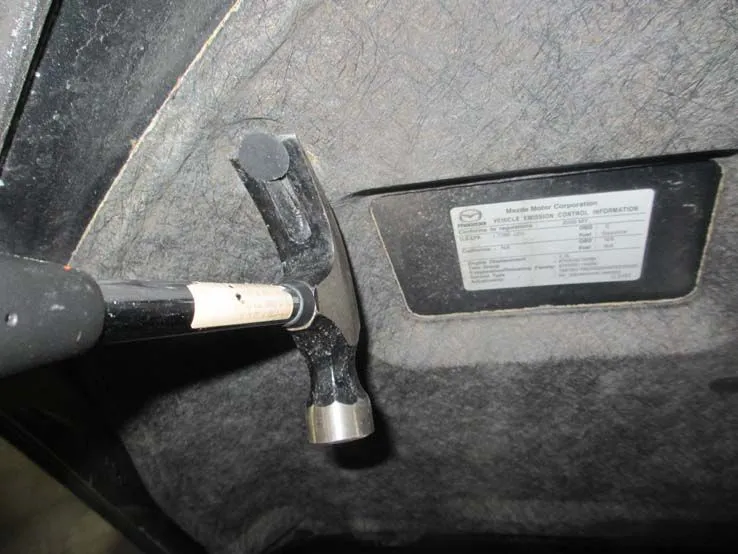

But I just used a hammer:

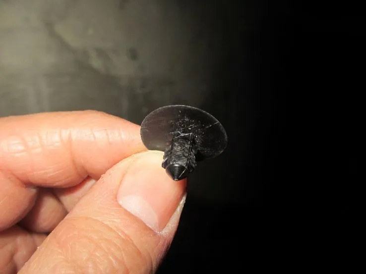

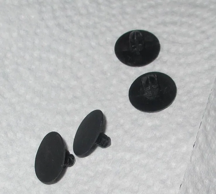

The hammer worked fine. Some of the clips will possibly break, but in removing 10, I only broke 1. You can re-use the ones that don't break. To replace the one that broke, I found a new one at PartSource for $1.

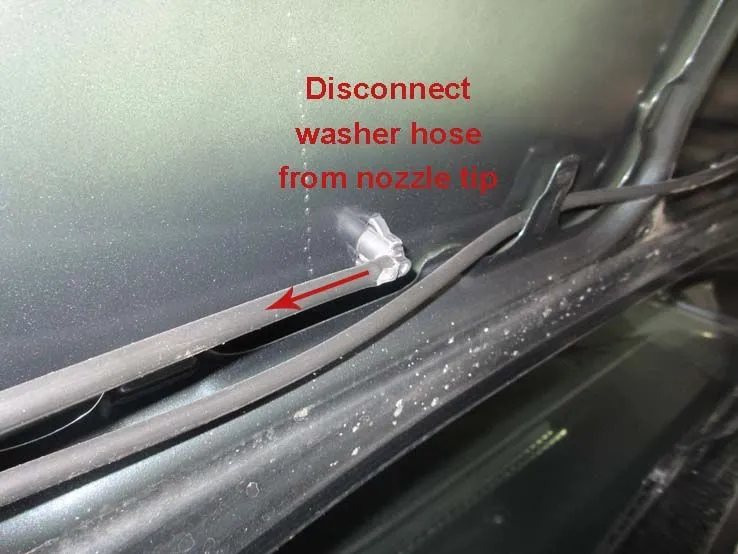

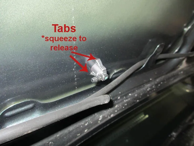

Once you have the insulation layer out of your way, you can reach the underside of the washer nozzle, where the hose connects. Disconnect the hose. You may have to work at it, twisting a bit and using your fingernail... It's on there tight...

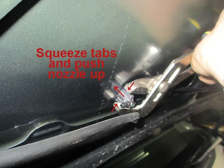

The nozzle is held on with tabs you squeeze to allow it to pop up through the hole...
I used pliers, but you may be able to do it with your fingers...

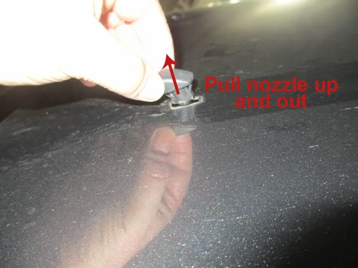

Pull the nozzle off the rest of the way from the top... Please ignore my dirty car...

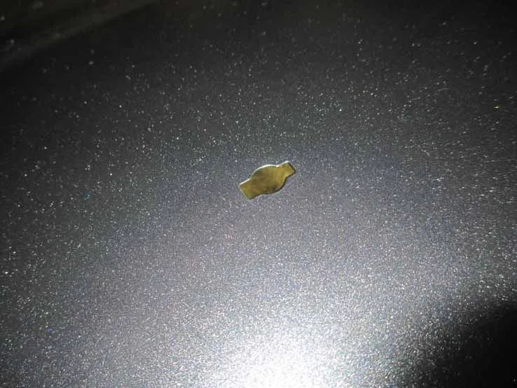

This is the shape of the hole. Clean the area around the hole before installing the new nozzle, just to make sure there's no dirt or grit under the new nozzle where it contacts the hood.

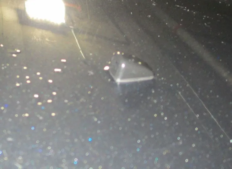

Here is a video of the two spray patterns, the Ford Fusion one on the left, and the original Mazda 3 one on the right. The Fusion spray pattern is perfect... full coverage with no overspray.
