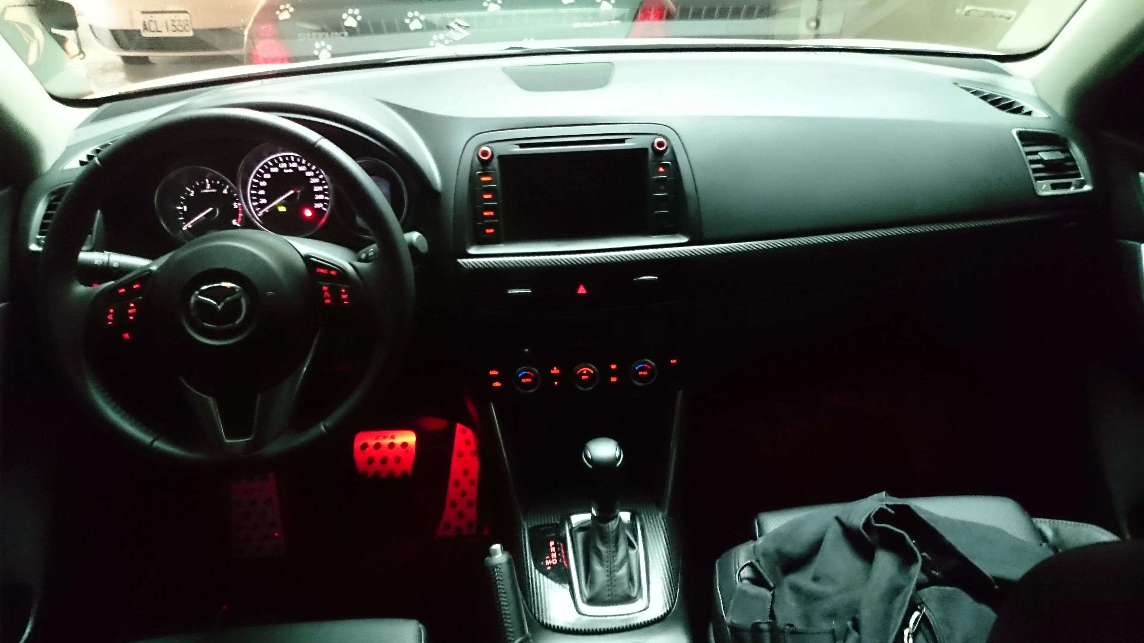

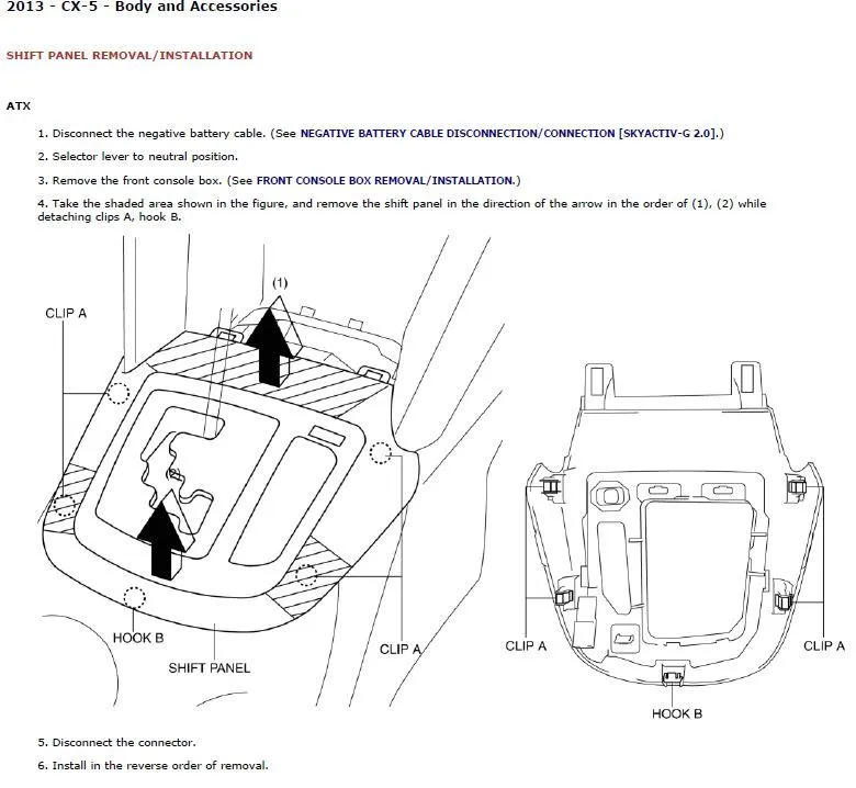

The goal is to install LED lighting so it would light up the floor area of the cabin during Night Mode. Mood lighting.
I've figured since the light is commended by the BCM, other not so smart devices such as the A/C panel or the shifter must have a hard wire instead of using CAN BUS message.
So I took off the shifter and measured all the pins, found that the white pin is responsible for the night time lighting.
This is how it's done-
(Note, I think there is a difference between 2013 and 2014 wiring, since the shiftgate's design is different and my car's connector doesn't match wiring diagram for 2013. )

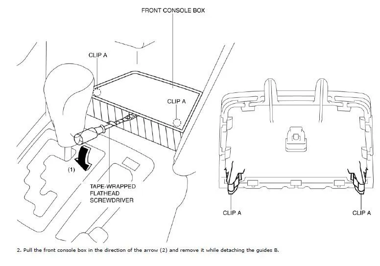

1. Remove the shift panel

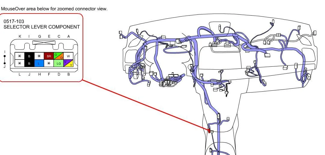

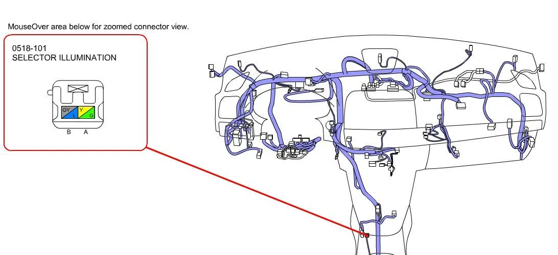

2. Locate the electrical wire connection that's responsible for the shift gate lighting and signal. It's on the shifter mount.
3. There is a 8 pin connector, with 7 pins populated. The white one - on the shifter mount - is the one responsible for night time illumination.

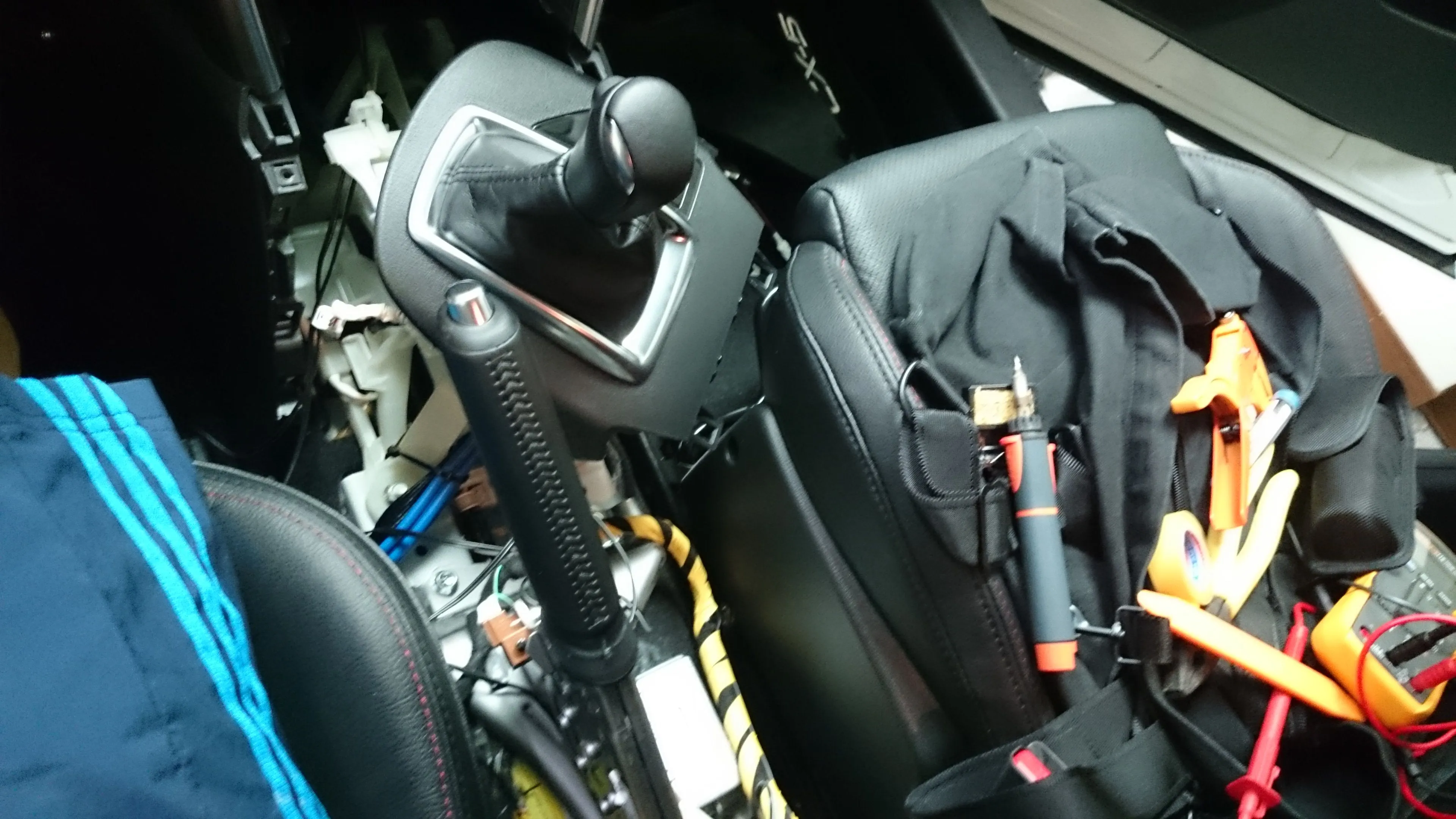

By now, you should have a mess that looks like this!
4. So run cable from that white wire as positive and then run a separate ground wire from any grounding point to your LED or any lights you want to be illuminated when in night time.
(It will be a good idea to run a separate fuse when you tap into the shifter lighting (white cable). I would personally recommend not to put a heavy load onto that white cable!
