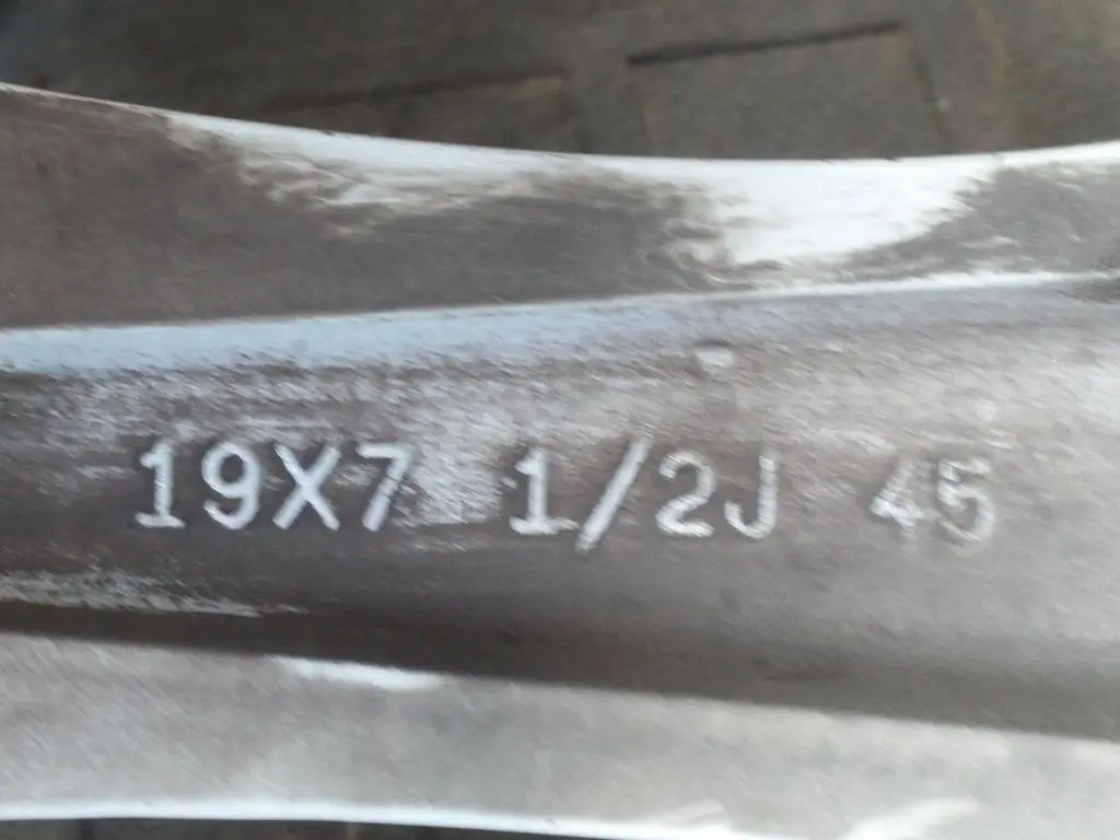

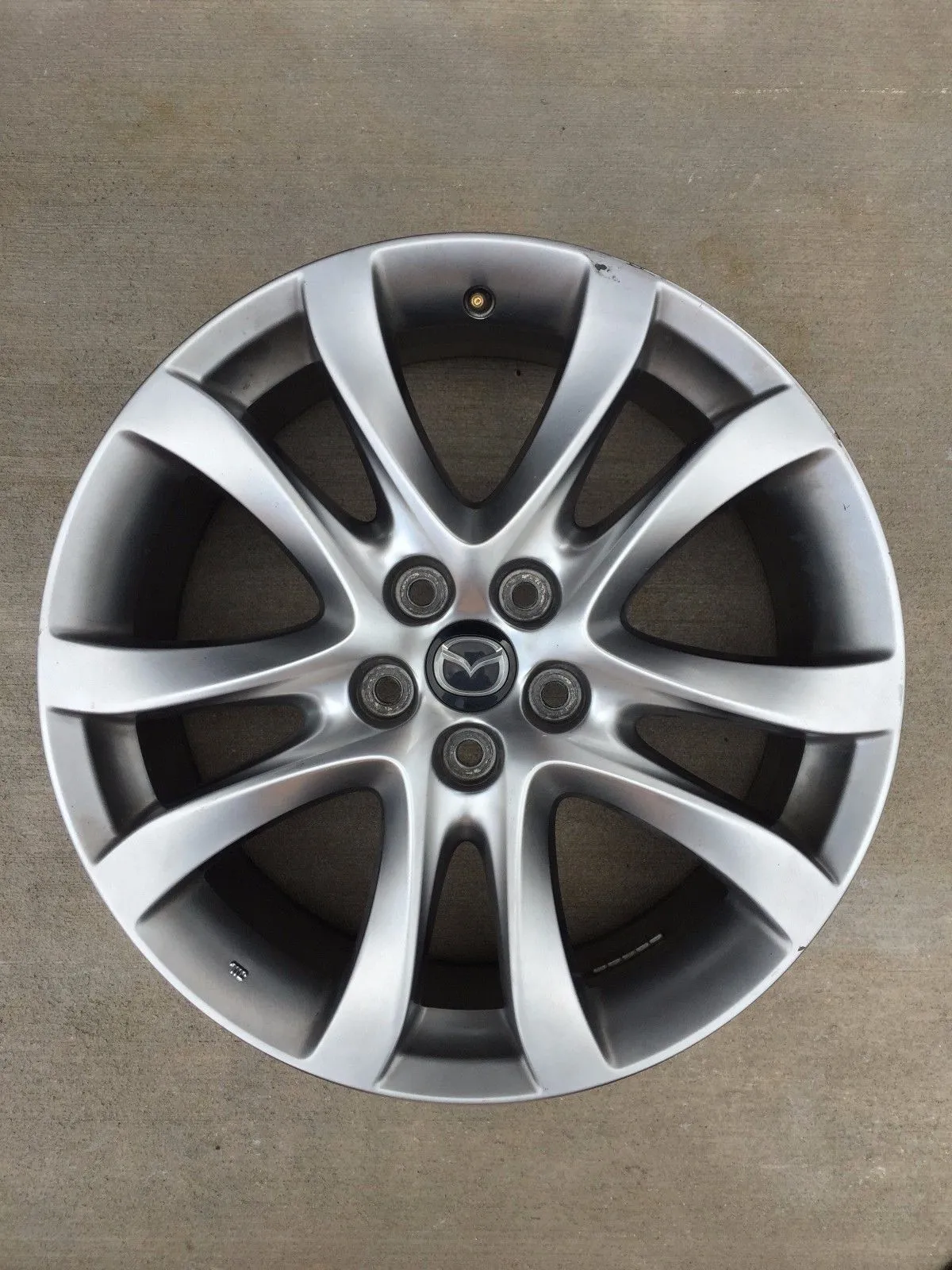

I just bought a set of mazda 6 GT 19 inch rims (19"x7.5" width x45mm offset).

Ive seen a forum member with a CX5 with the same rims ( http://www.mazdas247.com/forum/show...-your-wheels&p=6447265&viewfull=1#post6447265 ), and I love it...but the tire size pictured by the other forum member is "stock" which I interpret as : 225/45/19
I want larger (taller) tires (ride handling and fill in wheel gap) and wider tires for a more aggressive look. I am not interested in lowering (spring swap) the vehicle. I realize larger tires will throw off he spedo, but im ok with that. I also not going to run any races or slalom courses...but dont want a sloppy boat of a ride. Im your average middle aged guy that just wants the car to look like i didnt totally give up on life and wear black dress socks with open toe sandals...

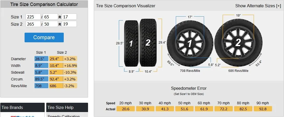

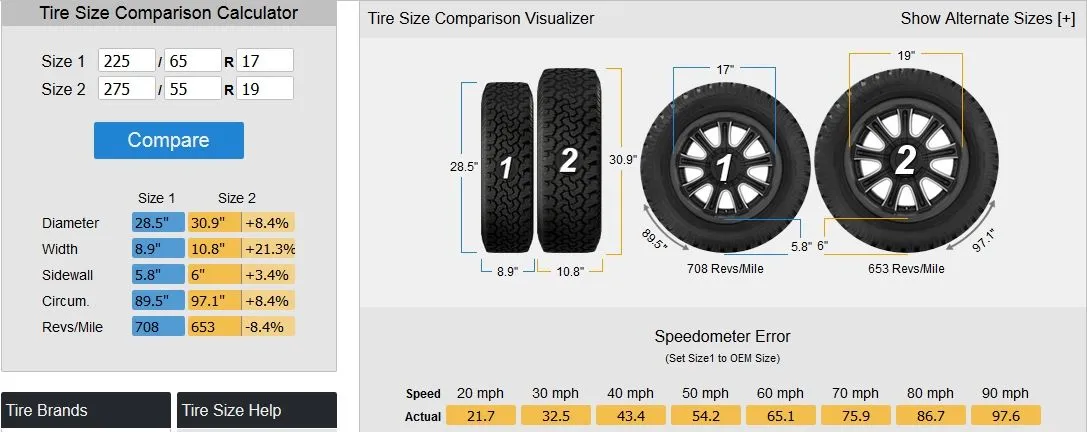

Ive included a tire size calculator i found on www.tiresize.com to show some of where I got my ideas, and what dimensions they are based on. Im comparing the stock tire in the car now, with the proposed tire i "think" i want.

Are you looking at a specific tire? A 275/55R19 will be way taller than you really want on the CX-5. There's also not a lot of great selection in that size on Tire Rack.
There are a bunch of really good options in either 245- or 255/50R19 that would be a much better fit.

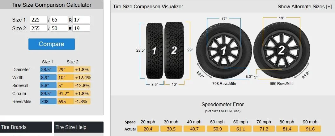

according to the dimensions on the tire-calc... ive added 2.4 inches in height, which will be split in half to the wheel well, so Im adding 1 1/4 inch to the wheel well, and raising the ride height 1 1/4 inch...I "think" that isnt unreasonable...but as mentioned, i dont know exactly how to ge to what i want.
attachment.php
according to your suggested size on the tire calc, I'll be adding 1/2 inch over all in height...which will be 1/4 inch into wheel well, and 1/4 inch in ride height. This seems modest and negligible at best. The width is an increase of 1 inch... that might be ok...i wouldn't know till i see it in person on the car.
all the "offset" and "rim width" vs "tire width" & "tire diameter" is like herding cats: move one thing, and all the other change to confuse it.
Again, I have to ask if there's a specific tire that you want. I don't see any great options in a 275/55R19 that aren't available in a size that actually fits.
A 275/55R19 might 'fit' while the vehicle is sitting still with the front wheels pointed straight ahead, but you really need to worry about what happens when you hit a bump with the steering wheel near full lock. Also, I'd bet good money that you'd risk the tire not even fitting under the spring seat of the strut...

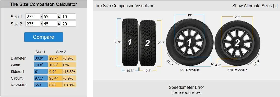

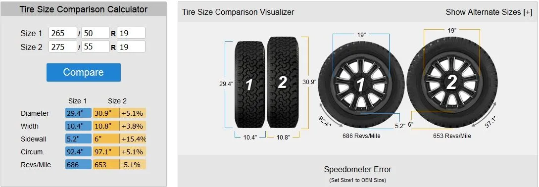

I see in the chart at the top of the thread, that a 265/50/19 is there. However, as I stated in my original post, I see that a member has a 275/45/20, which is NOT listed, but is obviously in use, and presumably, without issue. The difference, is he has it on a 20, and has a wider rim, with an offset.
so my thought was: If there's room for a 275/45/20, maybe there's room for a 275/55/19. According to the tire calc, the 19 is 1 inch taller than the 20, which translates to 1/2 inch taller into the wheel well than the 20, with the same width

conversely, I can see that the difference between my proposed 275/55/19 and the listed +2 approved from the chart of 265/50/19, is 1 3/4inch in height and half inch narrower.

You will be giving up a considerably amount of vehicle performance by picking a larger tire diameter. Mazda has done a great engineering to select a system which includes tires, to give the customer a great overall vehicle. I wouldn't want to screw that up. Ed
my hope was to fit a tire that made a reasonable visual size increase...
And a 245- or 255/50R19 would do that, without requiring major surgery to your vehicle. Yeah, some people have gone up to a 29.5" diameter tire, but they're accepting the performance compromises that go along with the change.
So i think you've hit what Ive missed. I dont know how the OEM 19 x 7.5 wheel, with 45mm offset changes or dosent change things. Thats whats throwing me off.
It doesn't really change much, and that's a good thing. Like Ed said - the wheels and tires are an integral part of the suspension, and changing them too much without knowing what you're doing is a recipe for disaster.
That 275/45R20 is already more than an inch taller than the stock tires on a CX-5. As a general rule of thumb for unibody vehicles, you can go about half an inch bigger in diameter without any problems. Go an inch bigger, and you have to keep an eye out for clearances and rubbing, and be prepared to fiddle with springs, dampers, and adjustable suspension links to get things to fit. Going two plus inches bigger generally requires things like relocating suspension joints and fabricating custom components - it's definitely not for beginners.
As you should be catching on, that half inch in width and inch and three quarters in diameter might seem small, but it's actually huge.

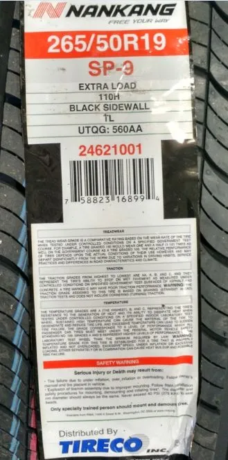

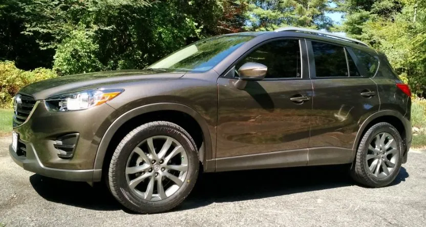

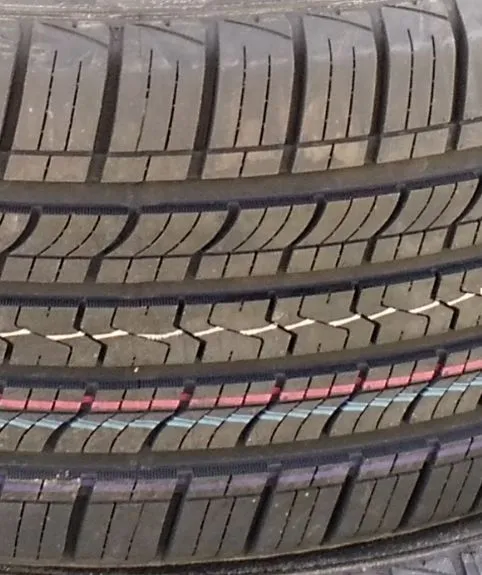

Thank you for the fitment advice. Everything worked out FANTASTIC!
265/50/19
Nankang SP9
initial impressions is this is a great economy tire. Quiet on the highway. I'll wait for winter to finalize my opinion, but suspect, considering the small tread detail, this will perform well in snow/slush and rain.
265/50/19
Nankang SP9
attachment.php
Nankang is a well known local tire brand in Taiwan.
