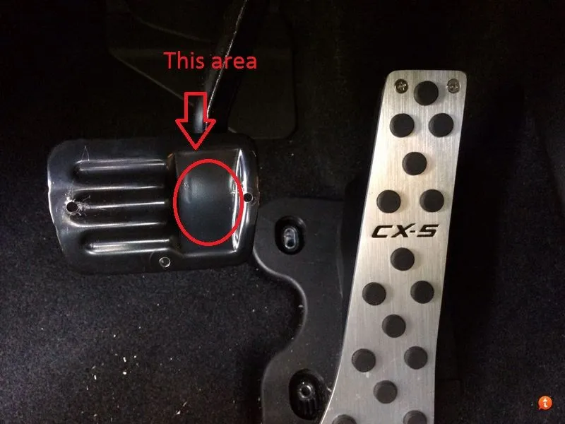

There is is a "missing steel portion" on the brake pedal. I have cut out a piece of rubber from the original rubber piece and put it there, before I have screwed on the aluminum pedal.
Otherwise, the rubber nipples would sink in there, if they don't have a back support.
Yes I know. But maybe mines are heavily glued. I am going to check that out and add some rubber to even the surface cause it will happen at some time.
