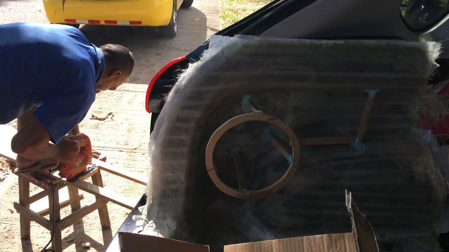

I came up with another simpler idea which uses 3 pieces of HDF as shown in the pics below. Basically, it is the same as my previous one, but the steel frame is replaced by a round HDF.
According to my "study", this setup is ok for Pioneer TS-SW2502S4 and JL 10TW3. The total volume of the enclosure is about 17L (0.6 cu ft) which is perfectly suitable for the mentioned subs.

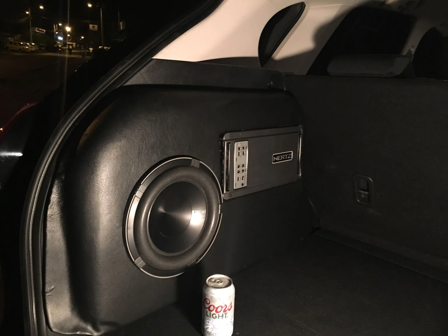

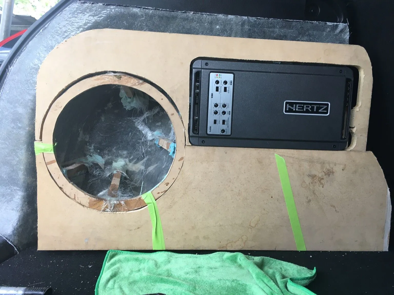

I replaced all but the front door Bose speakers with Hertz Diecis. Three sets of DCX 87.3s- three to run across the front and two on the rear pillars (one left over). Replaced the back door speakers with a pair of DCX 130.3s. Added a Hertz Energy EBX F20.5 in the spare tire compartment to supplement the front door Bose "bass" speakers. Added an Audison Prima AP5.9 bit processor/amplifier to run everything. LOVE the results. Mids are more defined and the highs absolutely shine. The previously muddy, flat bass is now present in spades. No boom, just glorious low end.
