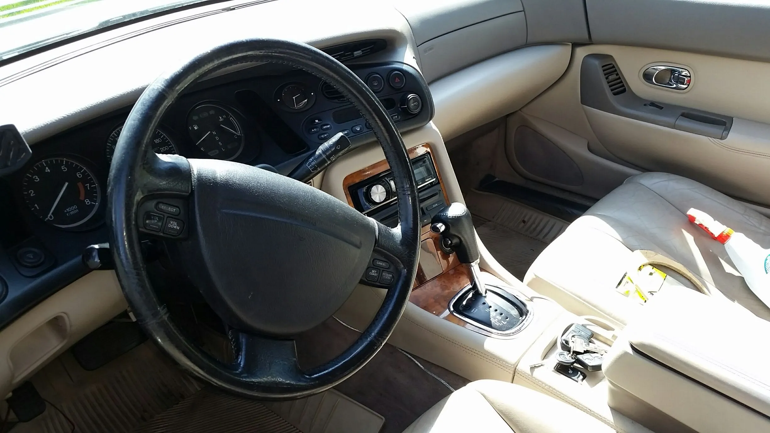

I also realized I have never posted any interior pictures. Here's the interior. I added the wooden Nardi wheel to give her a more vintage feel. I also stumbled onto some OEM polished door sills on ebay that say Sentia on them and snatched them up! They're like the ones that the mx6 had but polished to a nice shine!

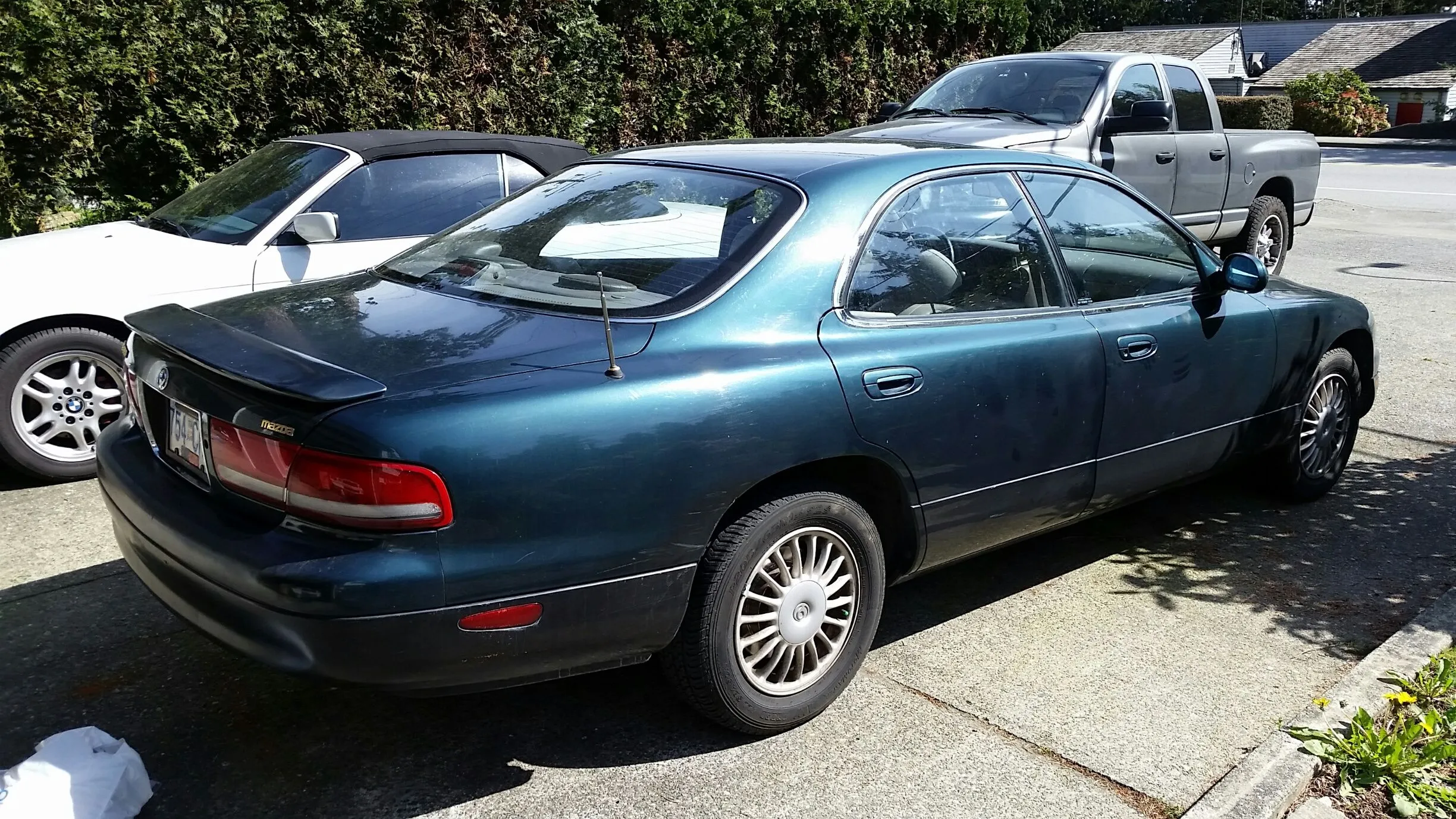

Well here's some pic's of the green beast. This is what I'm starting with. All I've done so far is replace the head unit with a temporary one until I get a double din touch screen and replaced all the speakers. The factory ones were "all" shot, the foam on all of them disintegrated lol. The power antennae doesn't work so I'll work on that soon. I'm starting with some comfort items so I can drive it for now :) Eventually I'll start tearing stuff down.
It runs fine but has a slight shake at idle, not quite a miss or dead hole... has new plugs, leads and distributor cap. Do these things normally idle like that? Also, this thing shifts hard, almost like it has a stage 2 shift kit in it! I know nothing about these cars but, is that normal?? 20150407_143420_resized.jpg20150407_143429_resized.jpg20150407_143451_resized.jpg20150407_143507_resized.jpg20150407_143525_resized.jpg

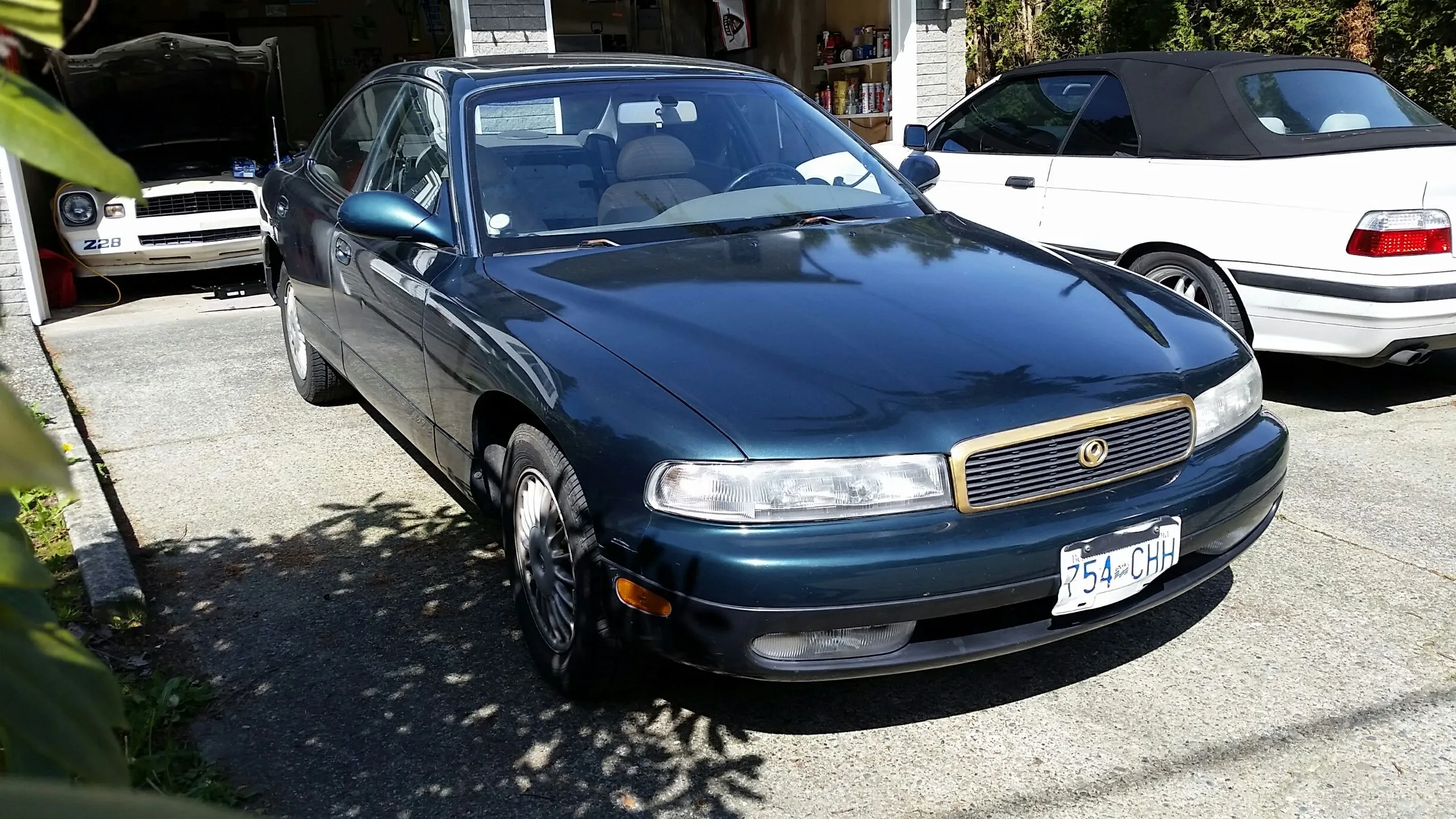

It looks great! I like the gold emblem kit you have on yours! I put a diamond style front grill on mine that's gold too.

The idle on mine is pretty good. I haven't run the new motor much yet but the old idle might have had a few stumbles. The car also had a bunch of valve tap and smoked a lot so it had some other issues then too. Mine did shift pretty hard too. There is a transmission cooler in the radiator and automatic transmissions shift a lot harder when the fluid is cool. Especially hard before everything is up to operating temperature.

It's on there but it's behind my old man car bra that I love so much. The trim piece around it is still chrome but the emblem is gold.

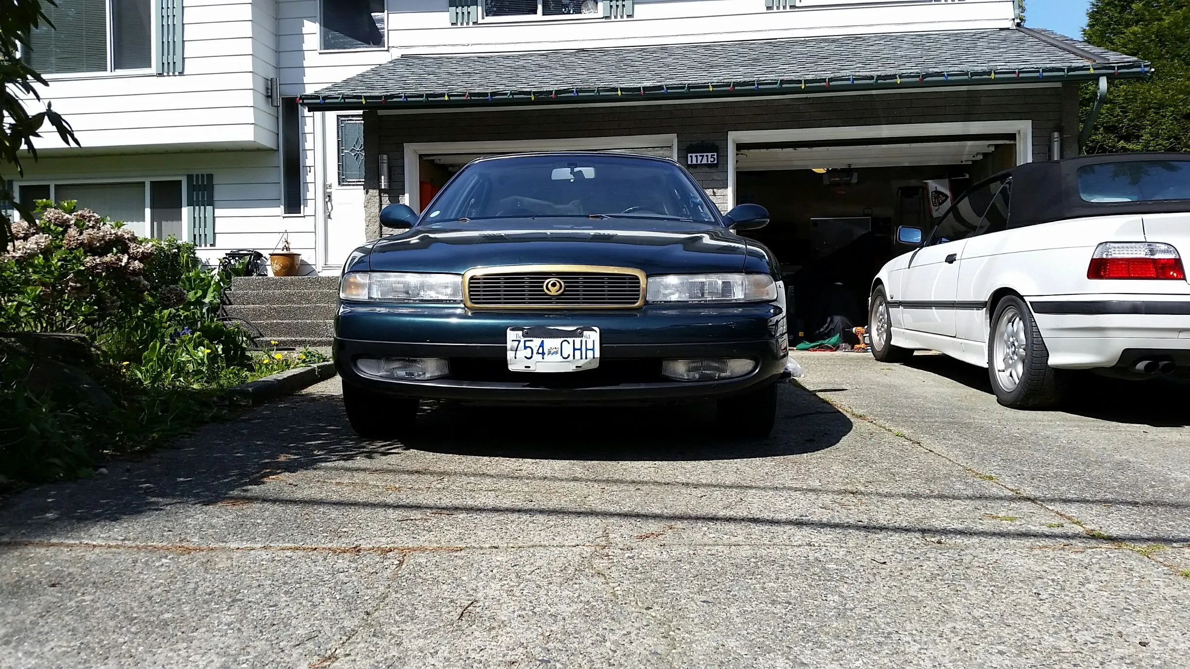

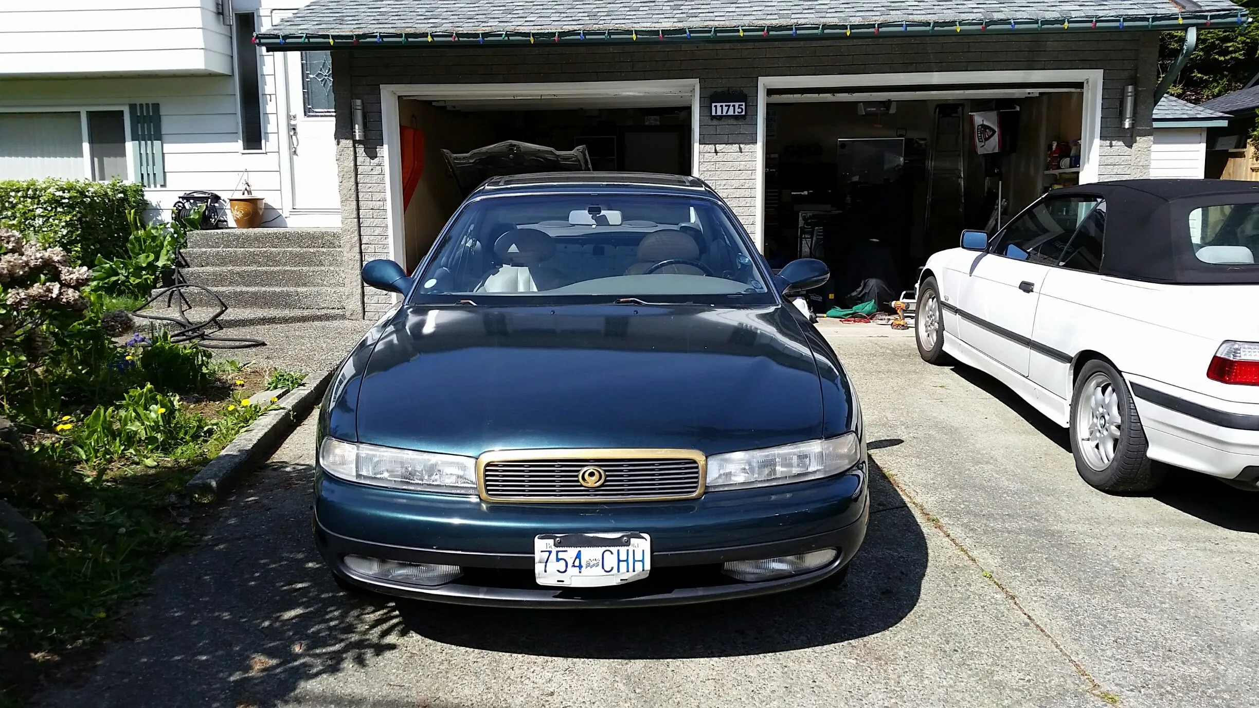

A few semi recent pictures and some new parts I picked up off a 929 in a local junk yard. I love how this car is coming together. My interior will be basically mint and the exterior is looking great as well.
Sick 929! Enjoyed and nice too see other 929 getting attention. Love the ride height on yours, I need to go lower on mines but needs fender work.LOL
