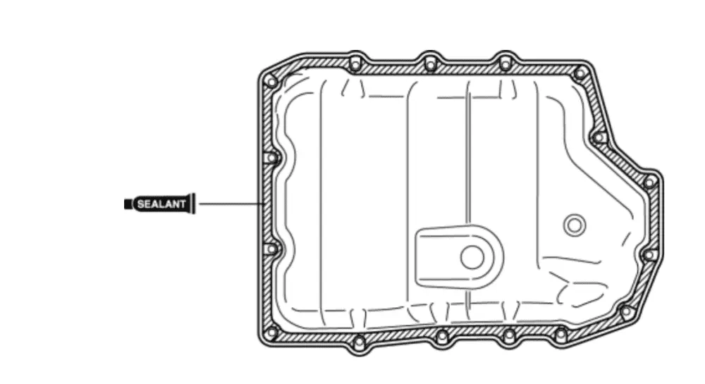

So what is the recommended RTV bead application width to ensure not too much or little assuming application roughly along bolt thread halfway point around the pan? Obviously too little is concern for leaks, seeps, and weeps but don't want to introduce too much that could make it's way into the pan. A small amount would get picked up by filter though.

I'd still be apt to use one of these tube tools for RTV application

The little key that comes with Mazdas silicone gasket maker worked perfectly. It rolled the tube up super tight without wasting material and was easy to control. The dispenser tip has different sizes that you can cut like you’d find on a tube of caulk. I went with the second smallest size which made a ~1/8-3/16” bead. I used a little less than half the tube. A little but of silicone squeezed out of the outside of the pan and looked just like the amount from the factory.

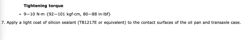

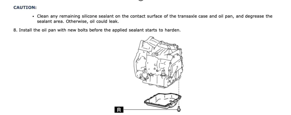

With the tube tool, are you going to try applying the RTV on both sides like workshop manual stated?
While FSM says "Apply a light coat of silicon sealant (TB1217E or equivalent) to the contact surfaces of the oil pan and transaxle case. "
It is only shown as being applied to the AT pan. IMO: I really doubt they expect application on both surfaces. If they were requiring dual application this would be unique to anything I have seen in any FSMs I've had for the last 25 years.
Open to being corrected and other brands that require it though.
