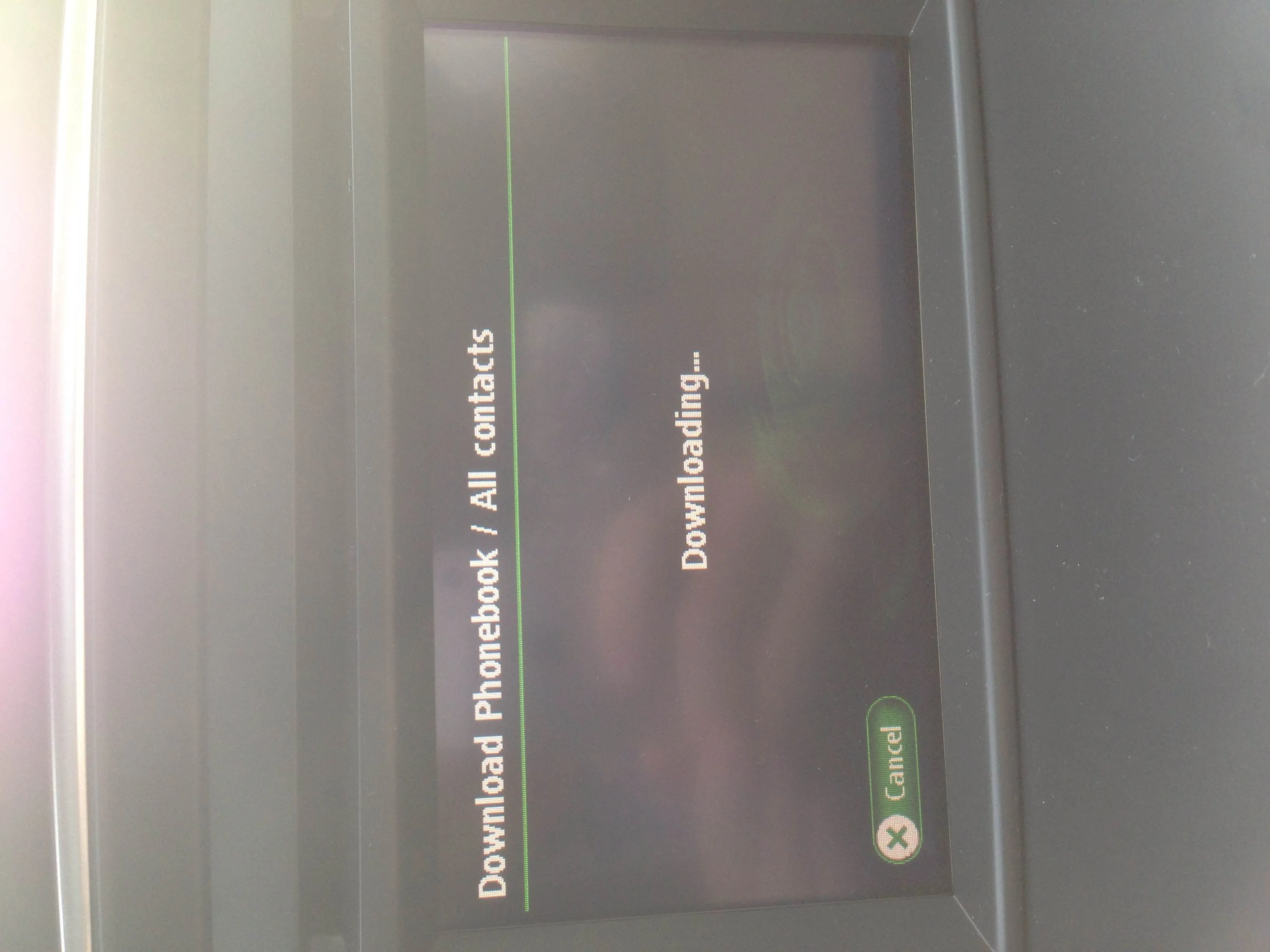

My new 2014 Mazda 6 GT downloads my iPhone 5 (iOS 7.0.4) phonebook every time I start the car. This usually takes about 2 - 3 minutes and is annoying for several reasons.
First, I can't make phone calls via the car's bluetooth during that time.

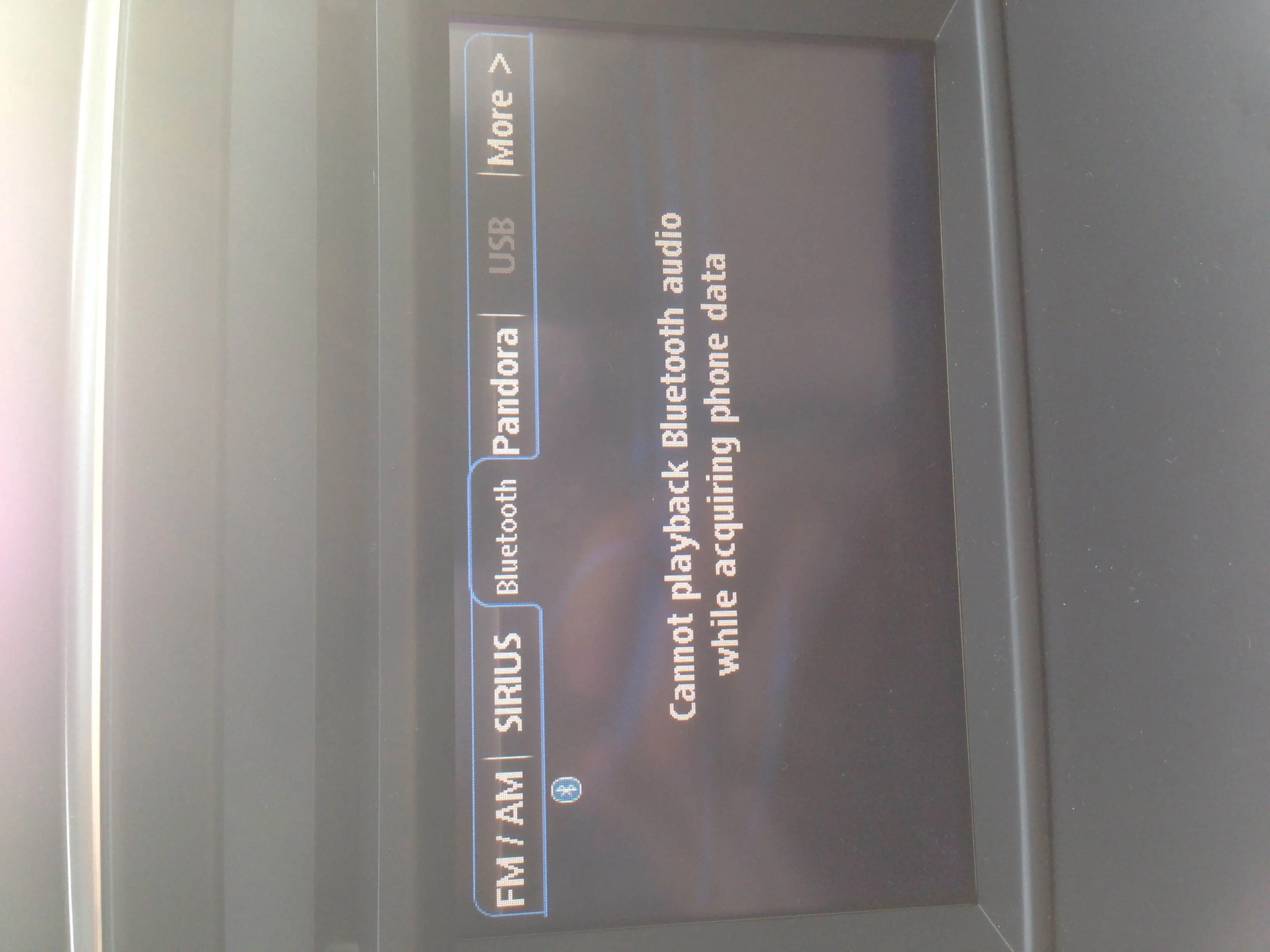

Second, I can't play music from my phone via the car's bluetooth during that time; if I navigate to the bluetooth audio tab, I get the following error message: " Cannot playback Bluetooth audio while acquiring phone data ". This message does go away after the phonebook download completes, but prevents me from starting to play music from my phone when I first start the car.

Same experience here. Frustrating as hell. I usually switch to phone to try to cancel the download every time so it doesn't lock everything up while it works. I have looked through all the BT setup options to see if there is an option, but there is not.

While annoying, if I am on a short trip (say 5-10 minutes to the shop) I CANCEL the Contact download. If I am on a longer drive (work takes 35 minutes) I will let it do its thing and I just listen to the radio for the first 3-4 minutes of the trip. Then I play Pandora on my phone and stream that via BT to the head unit.

I try to cancel the download, as well, but some times it gets to a point where the cancel option is no longer possible
You have to catch it as soon as it starts the download process (within first 3-4 seconds). After that CANCEL is not possible (from experience)

As a follow up to this topic, I tried a few tests over the past week to avoid having to download the phonebook everytime I start the car.
Well, you can CANCEL the phonebook download as per my post on 03-14-2104 above (got to do it within a few seconds of the process).
However, the interesting thing I found as a workaround is this:
Once you have allowed the system to fully download your phone's address book, the next time you start the car and CANCEL the autoload process, ALL of your address book entries are still in memory from the previous download and is available for use straight away. Of course, if you have added more names to your phone's address book, the new entries are not there until you download it anew. In my case, I just let the car download the phone's address once a week.
Hope this helps alleviate the frustrations somewhat.

I've noticed that my iPhone 5S on iOS 7.1.1 works flawlessly...and doesn't spend any time on download and connection setup...IF:
1) Turn OFF audio when I turn off the car.
2) Wait until after car starts and does the engine warm up bit for 15-30 seconds
3) Start audio by hitting BT tab.
Anything else seems to act like the car and phone have never met. I dug into BT profiles on both ends, and have concluded that Mazda needs some help but overall, a decent system.
All my Pandora stations, Playlists, and Contacts are persistent if I do the 3 step dance. YMMV....

If you go to the Phone screen and wait until it starts to download the Phonebook, there is the option to CANCEL the download but you have to be quick as you won't be able to cancel after about 3-4 seconds. The previously loaded phonebook is available even if you hit CANCEL. No need to upload new phone book unless you have added more contacts. I have a HTC One XL.

One way of dealing with this issue is to change bluetooth settings. On my 4S iPhone I choose to sync only "Favourites" contacts with Mazda's module. In this way contacts are acquired within 15-20 sec. And music starts playing without any further hasle.
