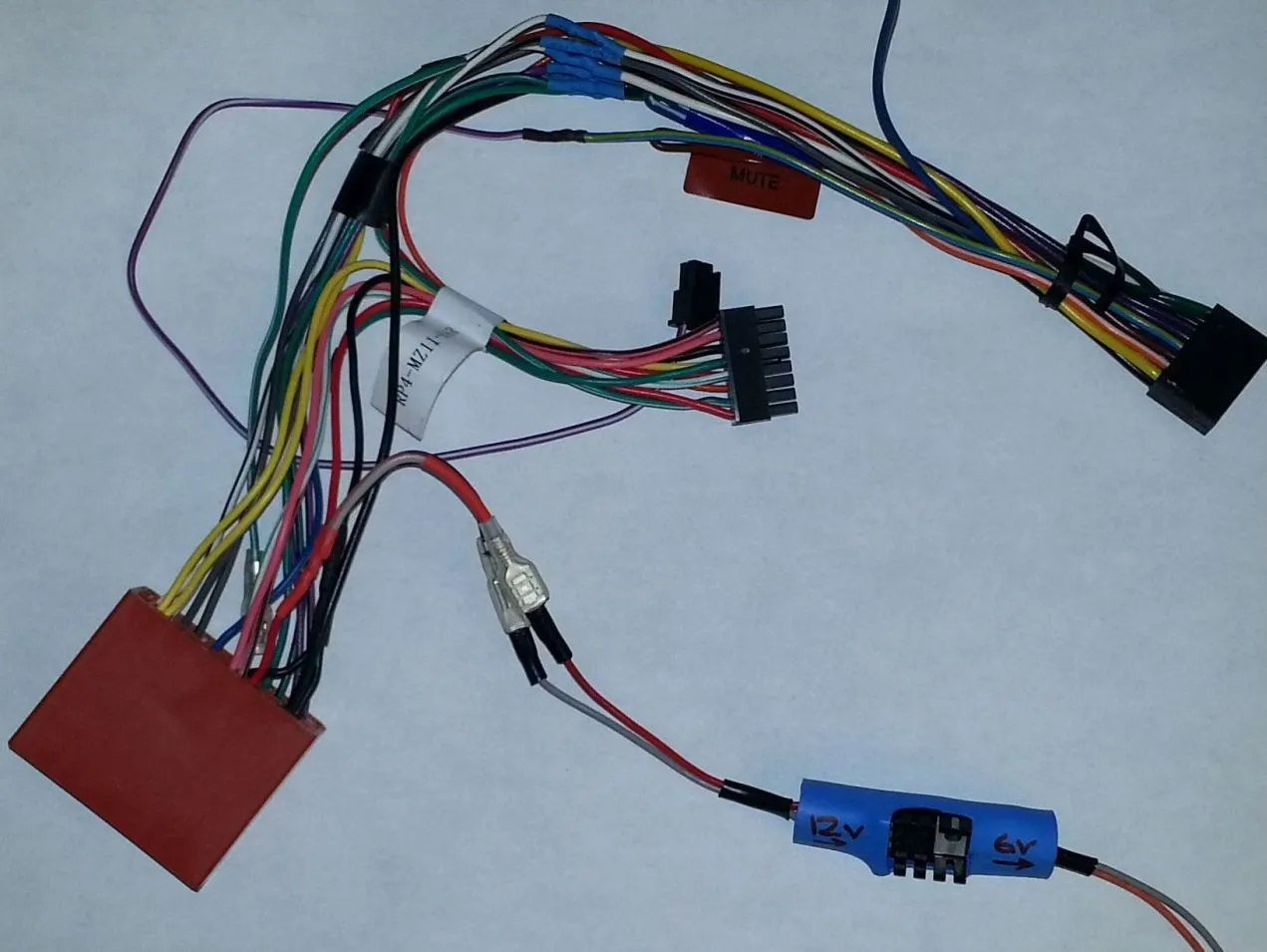

Answers one-by-one. Also see my inter-connection spreadsheet (attached as zip)...
1) Which wire did you use for the 12v/6V step down regulator? -- I spliced into the ACC (Ignition) line from the car harness. Camera is on all the time when the car is running.
2) Did you use the Accessory Output(1A) for something? What could we use it for? -- I used it to feed the ACC wire on the head unit.
3) On the high end Kenwood units, they have a wire harness that are used to control outside features, but I'm not familiar with these functions. -- Me neither :)
4) If I understand correctly, the connections to the Interface Connector, they all have to come from the Kenwood right? -- A bit confused by the question, the interface connector plugs into the PAC unit. Some of the wires (not all) connect into the HU
5) I see illumination on both connectors, the interface connector and also on the vehicle connector too. -- It seems that both will work, but I used the one from the PAC and removed the other orange wire from the connector (or tape it off).
6) It seems, that the 3.5mm jack, it won't be used in our application, only the blue wire, am I right? -- Correct. I removed the jack wires from the connector
Also note, I found it took the PAC a while to 'learn' the car's LAN signals. The orange illumination and green reverse signals did not work right away. I thought my wiring was bad, or the PAC was faulty. But they did finally start to work after some time. Weird.

With mine, it's the TEL button. That's exactly why I have the camera powered all the time the car is running. The green lead is grounded when the camera is in reverse, but you'd have to use that and a relay to get power to the camera only when in reverse, and then there could be a delay as the camera powers up.
