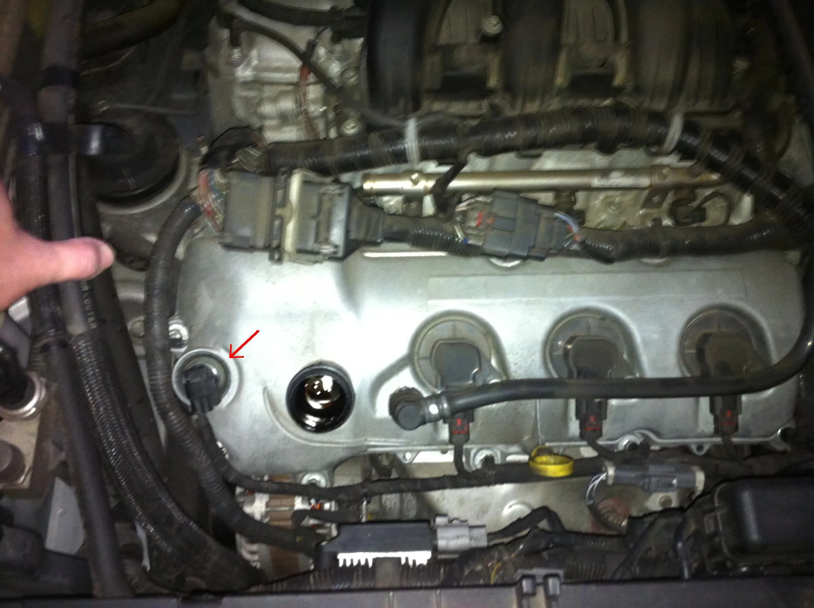

So what is this? When the mechanic removes the connector, ODB code P0021 goes away. The code comes back when the connector is re-attached. I ordered cam sensor position indicators, but the mechanic tells me that this part looks more like a valve than a sensor???

Now, I have identified the thing in my attached picture. It is the oil control valve. I believe this is faulty and not an oil pressure or timing chain issue. Justification: When running diagnostic, Codes P0021/22 pop up. With engine running, disconnected lead from front OCV. Ran diag and code P0021 drops out. Replaced lead and ran diag, code P0021 pops back up. I have both front and back OCV sensors on order ($109 ea.). I plan on replacing them and will see if that works. Hypothesis, local oil shop is possibly putting something naughty in my car oil since this is the second oil issue I have had. Had to replace an oil pressure sensor last year one week after an oil change there. I plan on taking my car to the auto hobby shop and doing my own oil change next time.

Alright. Got the OCVs and valve cover gaskets in. Got the valve covers off the engine and OCVs pulled. The replacement OCVs are slightly different than the originals in the fact that the tip of the valve has a portion cut out. Its the first time I have had a look at the engine and timing chain and they look great. I love the valve gaskets for the CX-9 as they fit like a glove in the head channels. Slapped everything back together and cleared the codes. The car drives like a pro again. I guess I forgot how nice it is to drive after humping along handicapped for two months. The OCVs are like $104 a piece BTW. Also of note, besides the P0021 and P0022 codes, I was getting a P0200 because the bad OCVs were retarding the timing, I think.
