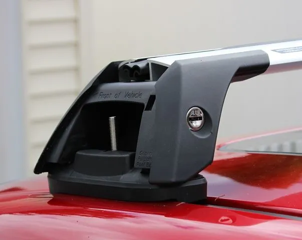

I am happy to report that the weather cooperated this weekend and I was able to wash and wax my new car for the first time and importantly to this thread, install the roof rack!

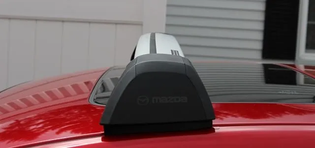

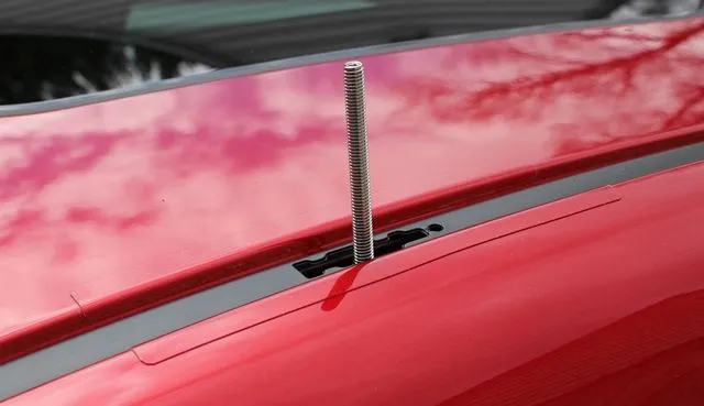

I was very impressed with how easy it was, just read the instructions. I wrapped some electrical tape around a large flat head screw driver and gently pried up at the front of both of the rain gutters. They slid back about a quarter inch and rose up out of the channel very easily. There are two semi complex pieces per side holding the gutters to the car which can be stubborn. You need to pick up the edge closest to you and rotate it gently and then push the gutter piece towards the center of the car and it will release from the clip. I had to fiddle with that for a while before I figured it out, the instructions are a bit vague there. The back of the piece comes off easily and the new one goes on with a couple gently pounds with your fist. The slide on caps which cover the screws are a bit stubborn, so I used the same tape covered screw driver like a chisel and tapped them off till they popped free. I placed the clear stickers which protect the roof on while there was no gutter piece at all on the car, I think it was be easier to do so with the area free and open. 4 bolts are then threaded into the car's roof. I might suggest putting some sort of paint down at the bottom of the nut on the roof to protect the car's real paint. I might take the roof rack off to address this as the bolts do tear into the paint.
Then, the rack lands on-top of the screws and protective tape, a big wing nut is used to hold it down, the caps get slid on, and it becomes a very clean rig when done.

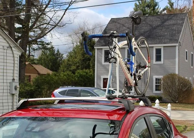

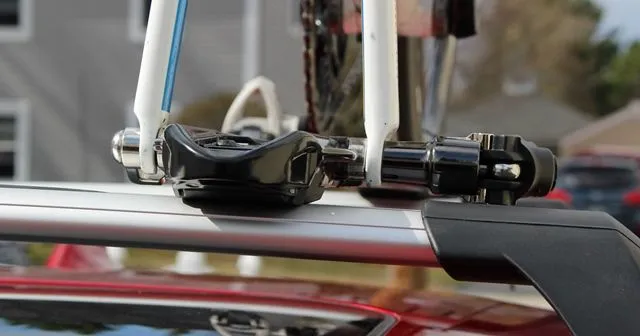

Finally, I installed my Rocky Mounts bike bar. One does have to be a bit careful with the rubber insert on the top of the bars. Press down on the insert as the bike mount is slid into the top channel. Also, the rear bar is 1.5ish inches shorter, so the a common reference point on the bike bar should be 3/4 of an inch closer to the end of the rear bar than the front bar to get it to sit straight on the car.
I have driven the car for a few hours straight on the highway after install and I think I lost only about 1 mpg with it an the bike mount on. The noise increase is also pretty much impossible to hear. The sunroof is a bit louder, but nothing is perfect. The rear gate does open with the road bike on the rack without a problem. There is about 3 inches of space between the bar and the hatch, I did not think to look at the tire to the hatch. I will be putting my much larger 29er full suspension on tomorrow so fingers crossed the tire does not get in the way!

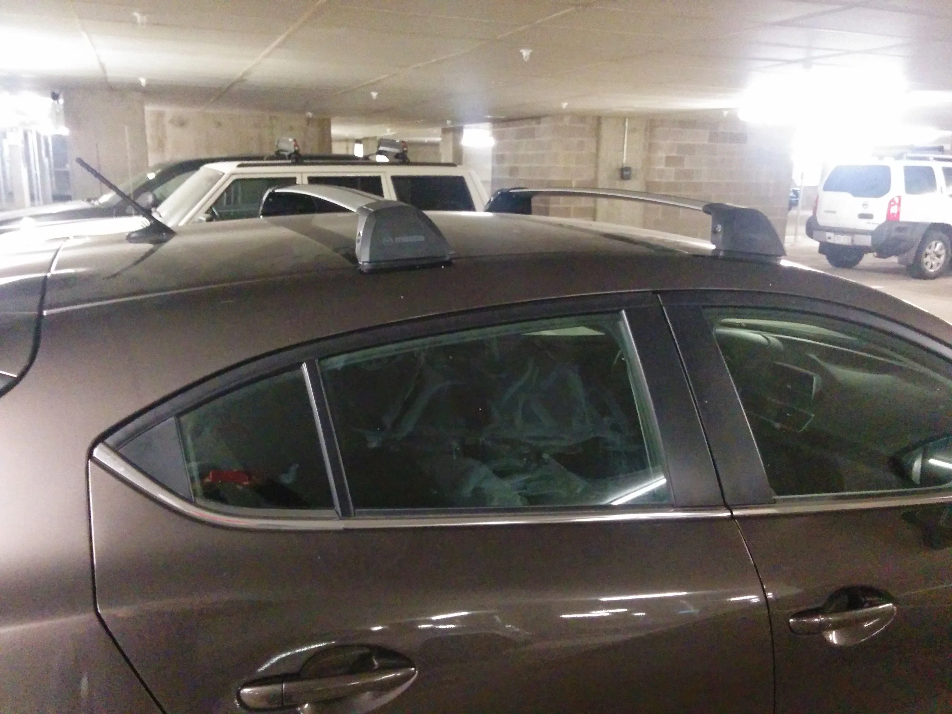

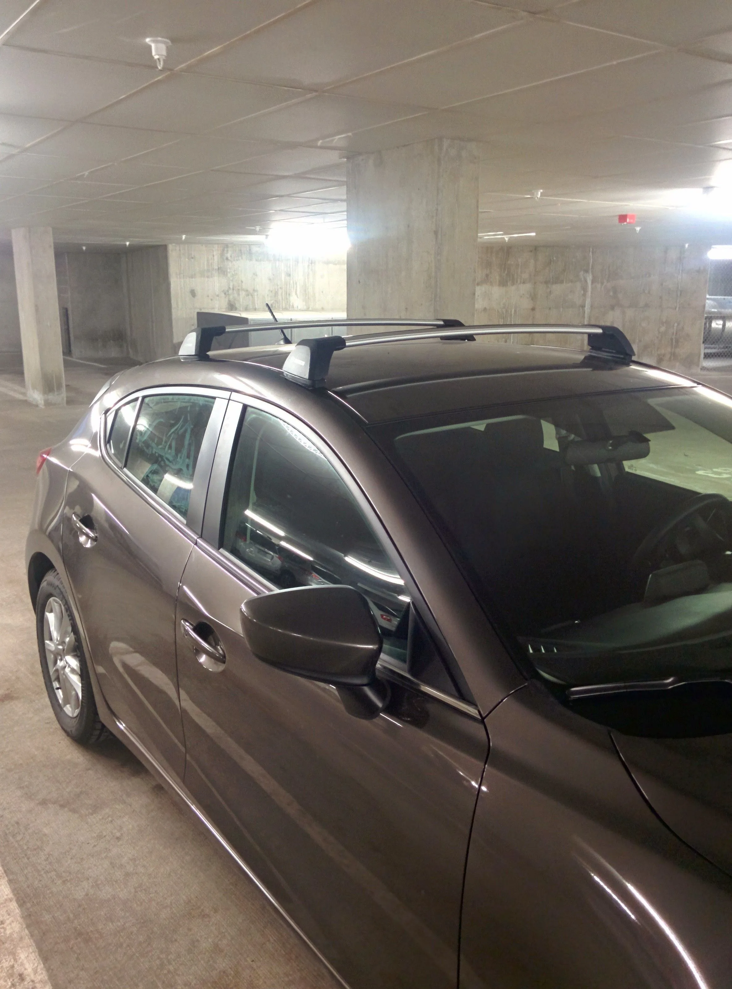

Good evening everyone,
I put the mtn bike on the car yesterday and thankfully the rear tire missed the rear gate's spoiler when open by about an inch, it was really close! I own a Trek full suspension 29er so it is a pretty large bike in the overall world of mtn bikes, but some all mountain machines may cause a problem. It would just require that the bike not be on whenever the gate needs to be opened all the way, not a big deal.
I measured the overall height of the car, roof racks and all, with my super precise engineer's squinting eyeball and got about 60 inches, which makes sense as it was about 2.5 inches taller than the roof which is supposed to be 57.3 inches according to Mazda.
I am super impressed with this rack, I have noticed a slight whistling with the sun roof in it's angled orientation when at highway speeds, but it is nothing that the normal radio volume needed to overcome the open sunroof can't handle.

I have had the bars on for about a month and half now and still love them. I also love the rockymounts, such a nice carrier! I am reluctant to open the sunroof on the highway, but I think I was before the bars too, I had never had a sunroof before this car and it is pretty noisy, even with a naked roof.
As you might have read from my previous posts I bought a Yakima fork mount carrier before learning of the rockymounts and I decided to keep it. I carpooled with two other guys to a road ride event and installed the Yakima as a third rack for the trip. I put it on backwards so the bike's bars would not get all tangled up and everything went smoothly. I only got 25mpg on the highway, but oh well, my carpooler's paid for most of the gas. The Yakima also goes on and comes off much more easily than the Rockymounts, making it a great temporary carrier.
