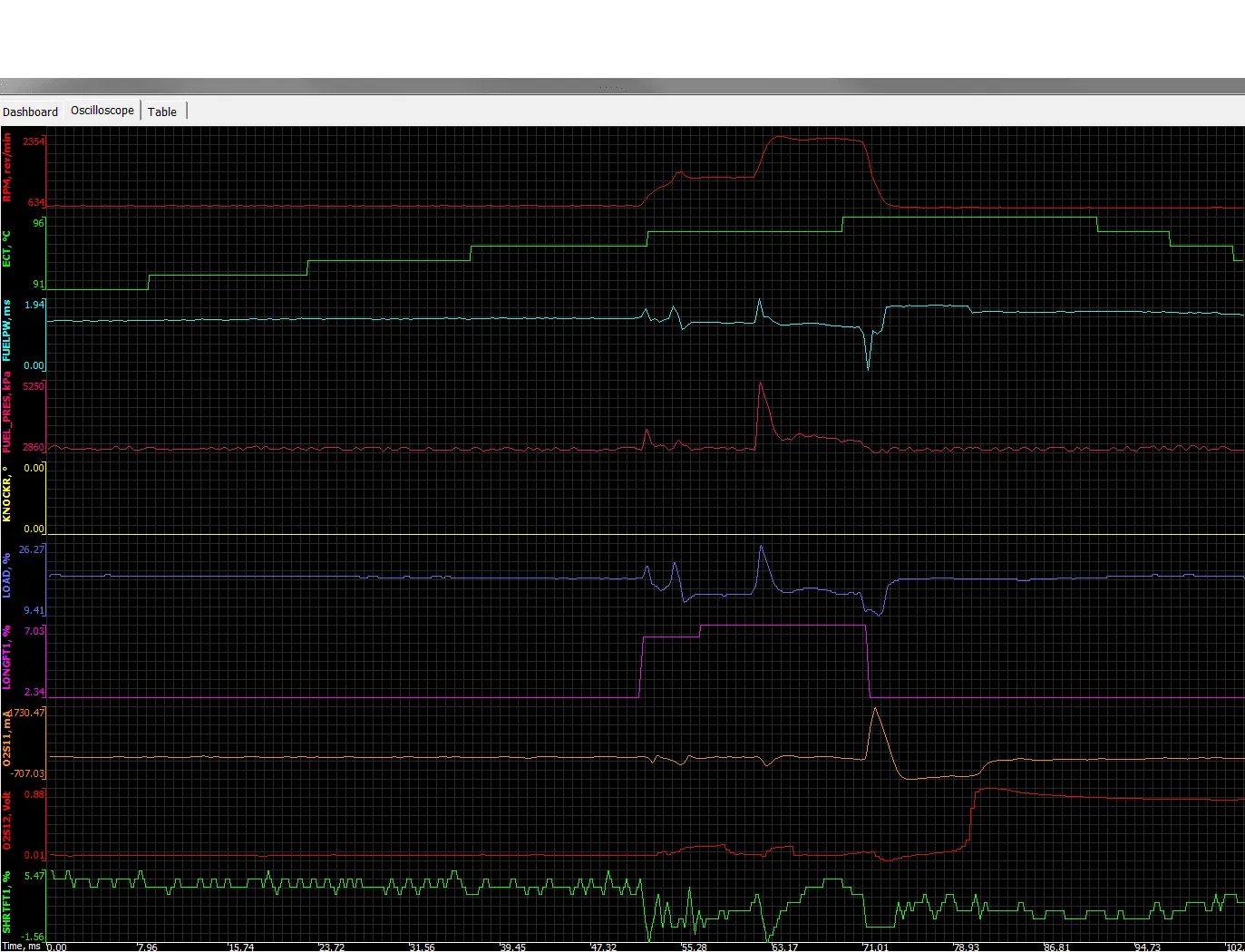

well the roughness is very hard to describe. I felt is only few time in the cabin when the A/C was turned off. The main issue I had was high fuel consumption and reduced pulling power. The rough idle/engine miss was pointed out by the agents and they do not know what to look for now. The other day they said the spark plugs were leaking compression (yellowish insulator - ceramic portion sits outside of the engine) and got all of them replaced. then they tried changing ignition coils and few sensors with new ones but the erratic vibration of the engine is still there. The long term fuel trim is about +2.34% and injector pulse with is about 1.4ms after the plug replacement, it was about +8 before with injector pulse with of 1.7ms. The engine load is also about 18%-19% and the RPM range from 685 to 705. I attached some PID waveforms if you can make any use of it.
