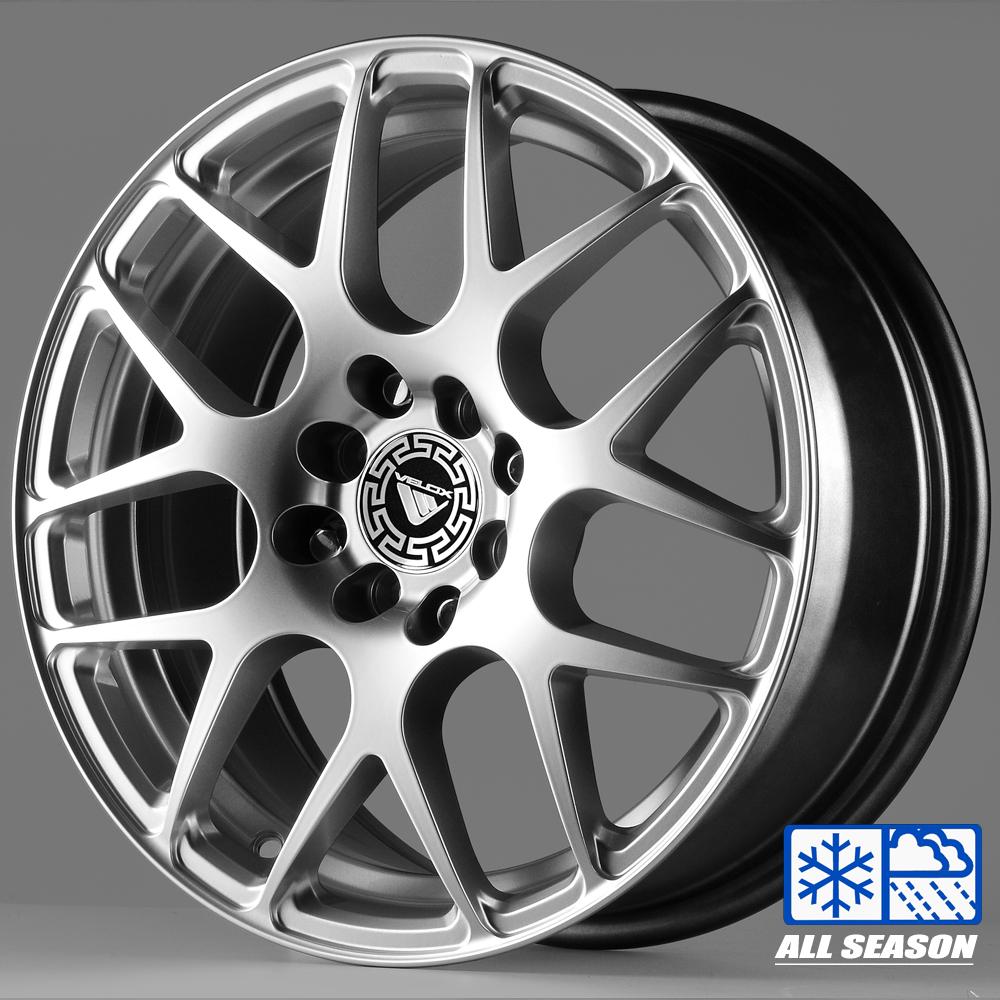

This is the one I am looking for
Velox Apex replica of some type of BBS

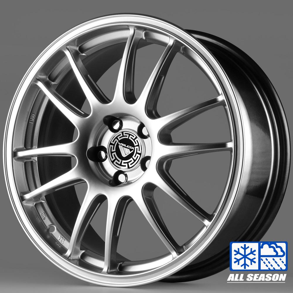

Velox Neptune
replica of OZ Superleggara
I do not want look at me wheels. This is expensive unplanned purchase already. This would cost $489 + Tax delivered. They came with free lug nuts and hub ring to fit the 67.1 mm center bore.
