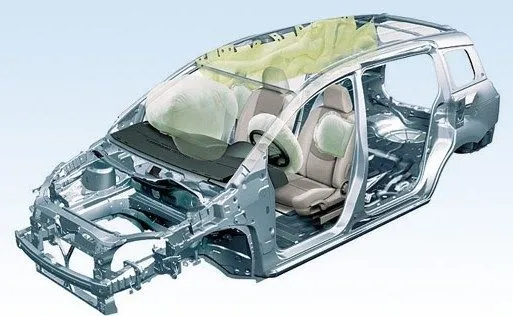

FYI, here's a pic of the '06-'10 unibody, which I believe is the same for +'12. Then again, out hatch doors are apparently different!...
