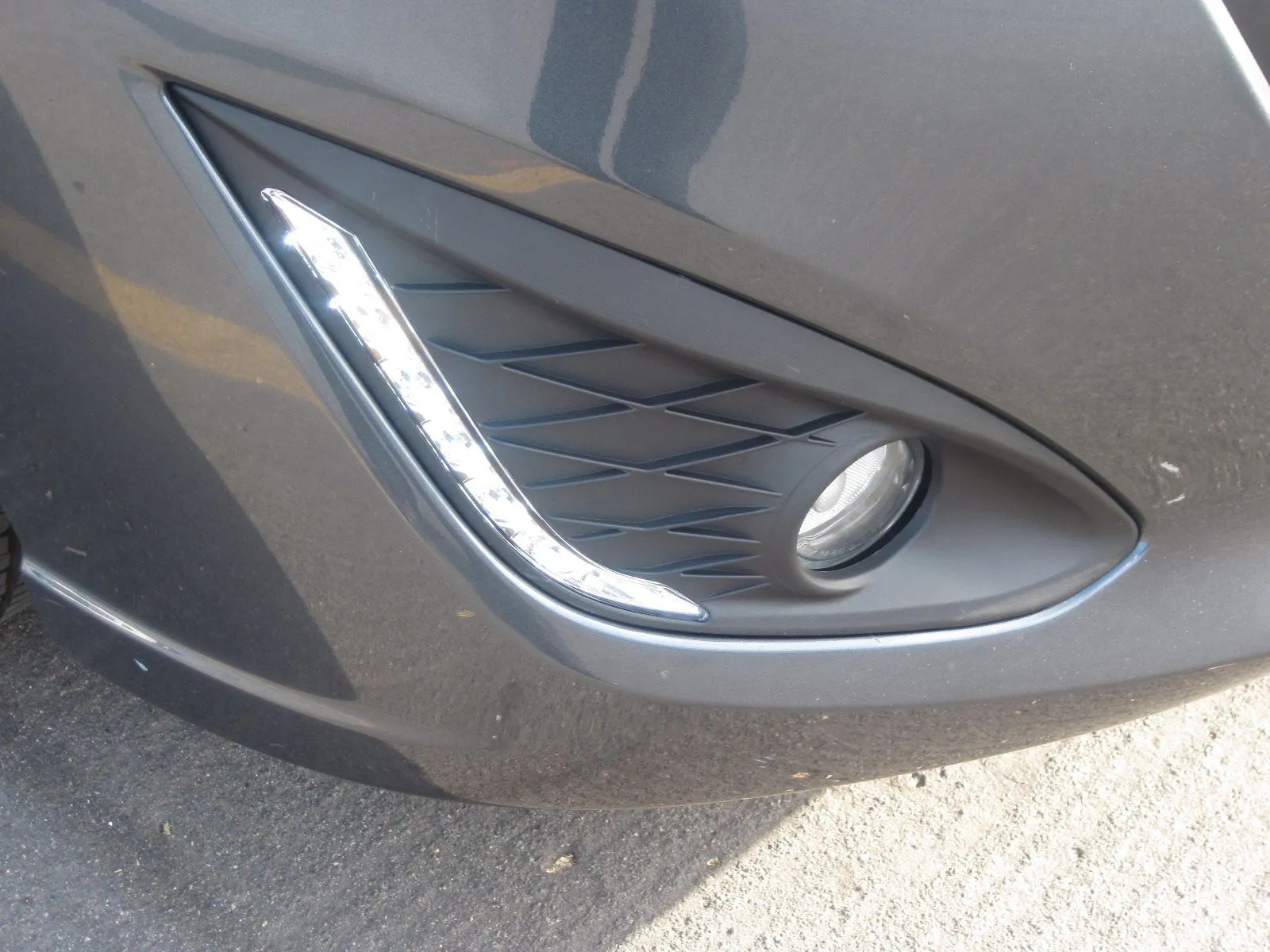

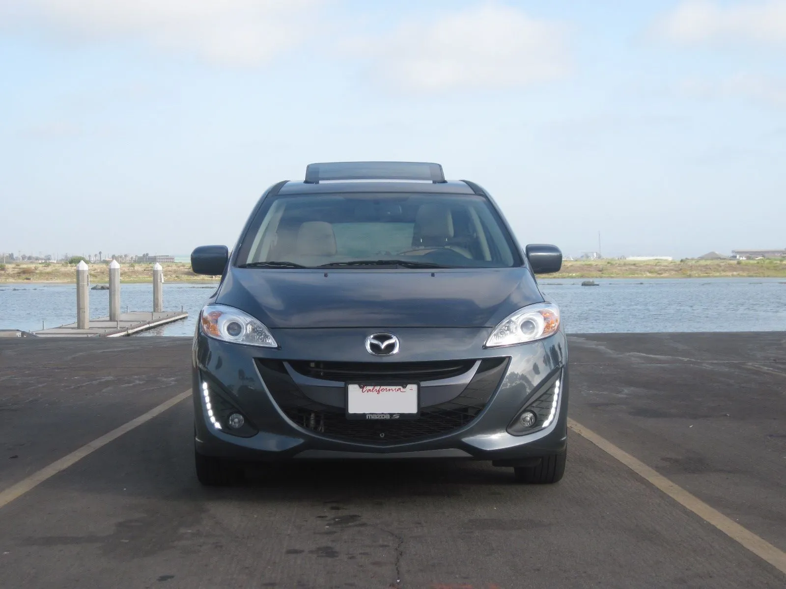

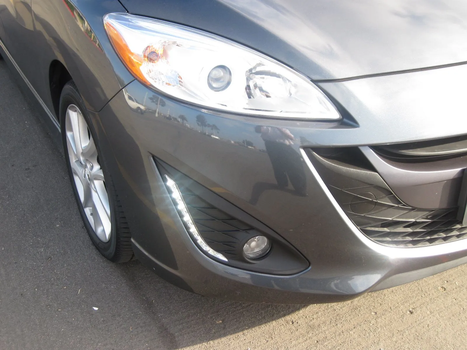

I installed these LED Daytime Running Lights on my 2012 Mazda5. They look OEM and work great!

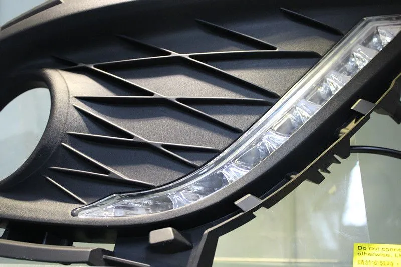

The LED Bezels are an exact replacement of the OEM bezels, they feel like the same thick plastic material.
The LEDs are permanently attached with clear lens, chrome reflectors and a metal heatsink in the back.
The tabs and foglight mounting tabs match up perfectly with the originals.
I purchased them from eBay for around $170 shipped from Taiwan. Took about a week and a half to get here.

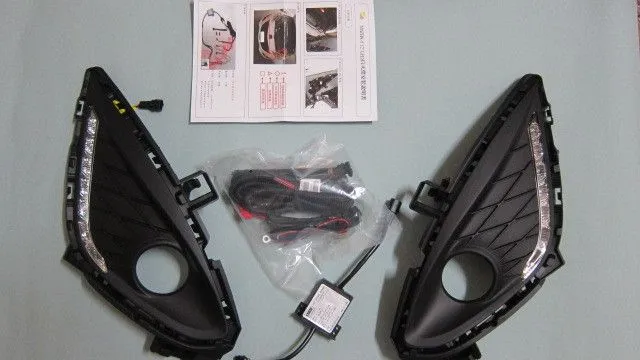

Bezel installation is as easy as changing the foglight bulb: unscrew and peel back the splashguards in front of each wheel to access the backside of the bezels. The wiring harness comes with the controller, fuse tap and connectors. Everything needed to wire them up are included.

The LED DRLs came with instructions that are in Chinese Characters only (see attached pdf).
I had a co-worker translate them for me (see attached doc file) She grew up in Hong Kong and is not a car girl, but the translation helped in figuring out which wires go where.
There are two options to wire the LEDs:
1) Connect the blue wire to the parking light wire (blue/white) and the LEDs will dim when the parking lights are on.
2) Leave the blue wire disconnected and you will have bright LEDs all the time.
The LEDs will turn on when the car is turned on. They are white and quite bright (almost as bright as the OEM Audi's and Mercedes DRLs).
There is a delay when the car is shut off - they remain on for another 10 seconds or so. I did not see any way to alter the delay timing.
If you go with option 1) above, the LEDs will dim when the parking lights/headlights are turned on.
Overall I am very happy with them. I didn't want to go and stick aftermarket LED strips which can fall off nor did I want to take the headlight apart. They look like it came original from the factory. Highly recommended if you desire oem-looking daytime running lights.

Ok, so for anyone that had the same problem as me, the kit doesn't include this essential bit (fuse tap/piggy-back):
Auto-Car-Add-a-Circuit-ATM-TAP-Low-Profile-Blade-Fuse-Holder-with-7-5A-10A.jpg_350x350.jpg
Once, you've bought this, the install is pretty simple, and can be attempted by anyone that can disconnect a battery and wire a plug.
