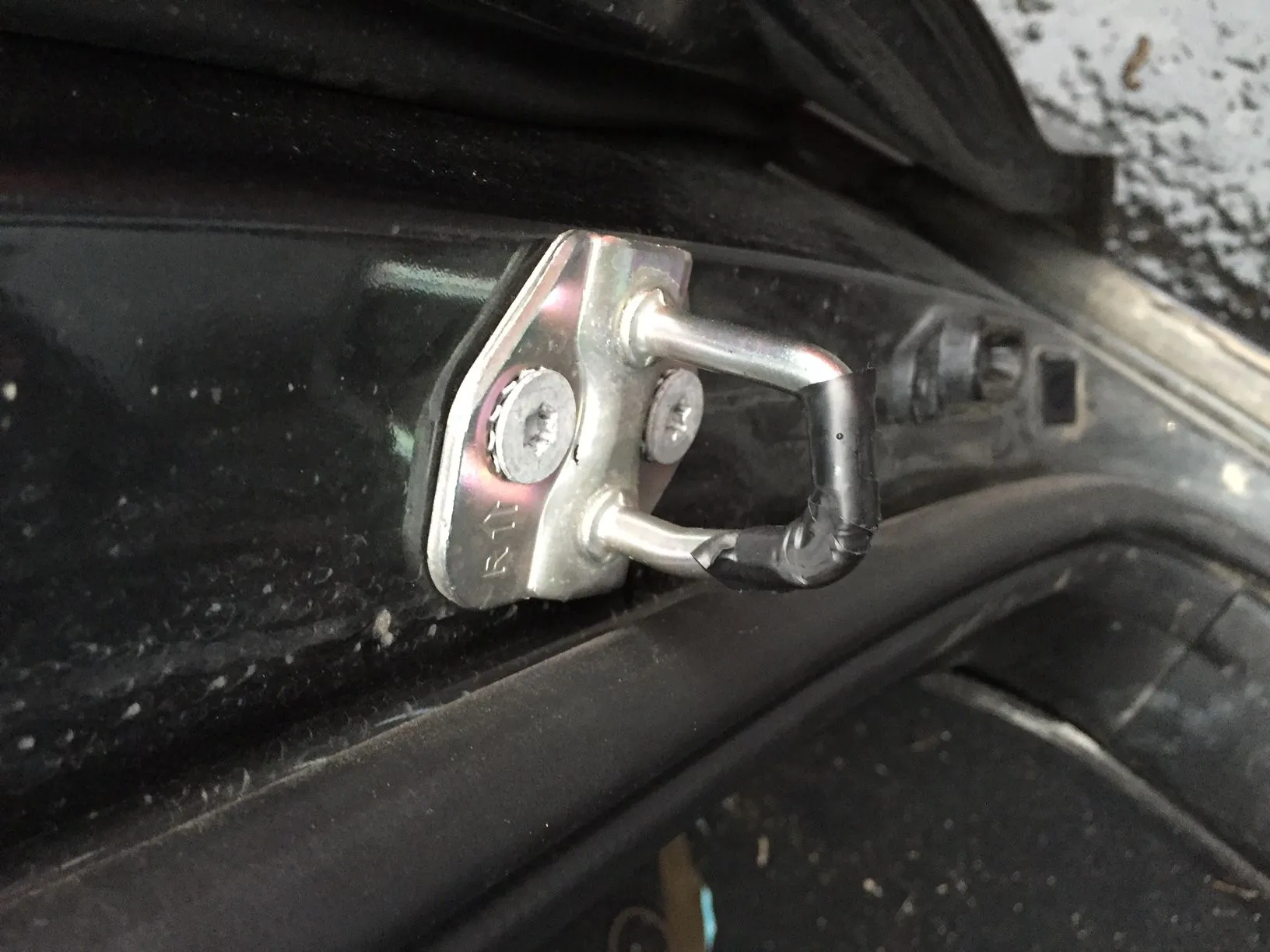

Instead, first try this trick I learned from the Chrysler minivan forums: put electrical tape on the striker. I did one side and the sound went away and then the other and now both are quiet. It's only been today so who knows if it'll last but it's almost free and worth a try before spending any money at the dealer. I'll post a picture when I get to my computer.
Edit: It seems like this forum only supports uploading photos that are already hosted online. It's just some black tape around the "U" shaped striker (the part that the door latches onto).

By way of update it has been a couple of days now with the tape and it is still working perfectly. The car feels more solid and well built now that the rear doors don't constantly sound like they are going to fall off. Hopefully the picture works so you can all see what an incredibly simple thing this is. The $1.49 roll (actually two rolls) of electrical tape is definitely having an outsized effect. It's like a new car. I've spent just under $2000 this year on new wheels and tires and HID's and who would have thought its would be this tape that made the biggest difference?
The pic works for me. Thank you for posting. Easy and cheap fixes are the best in the car modding world!
