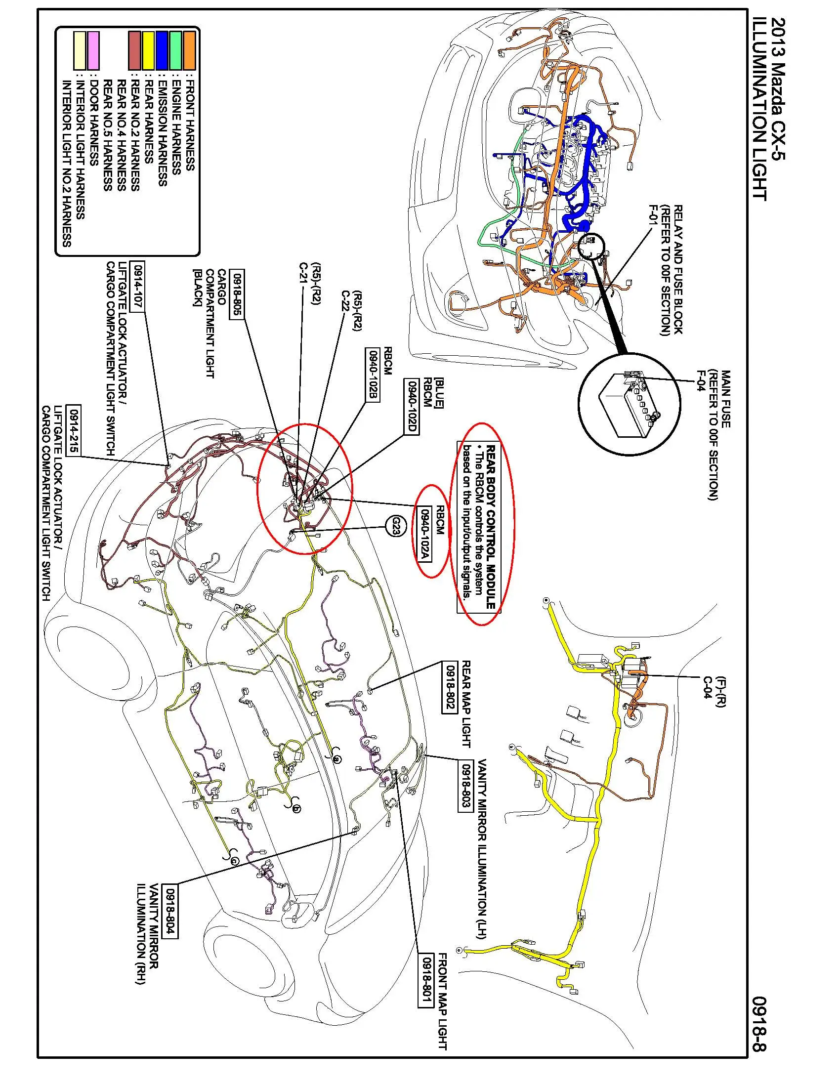

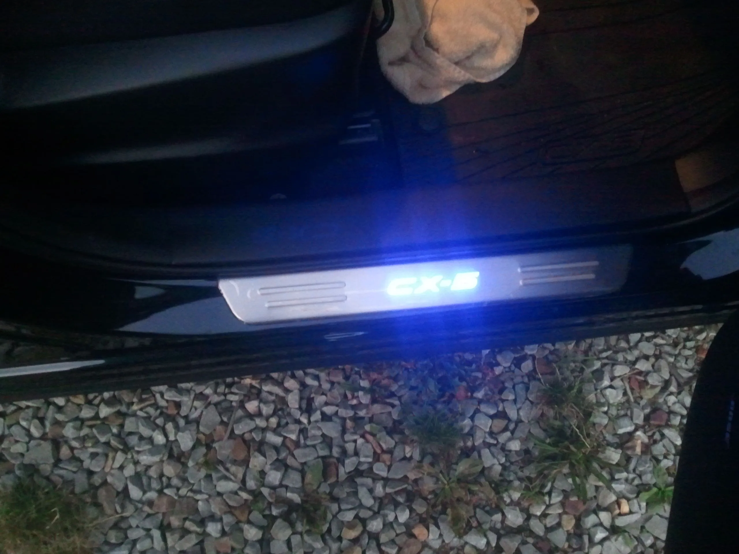

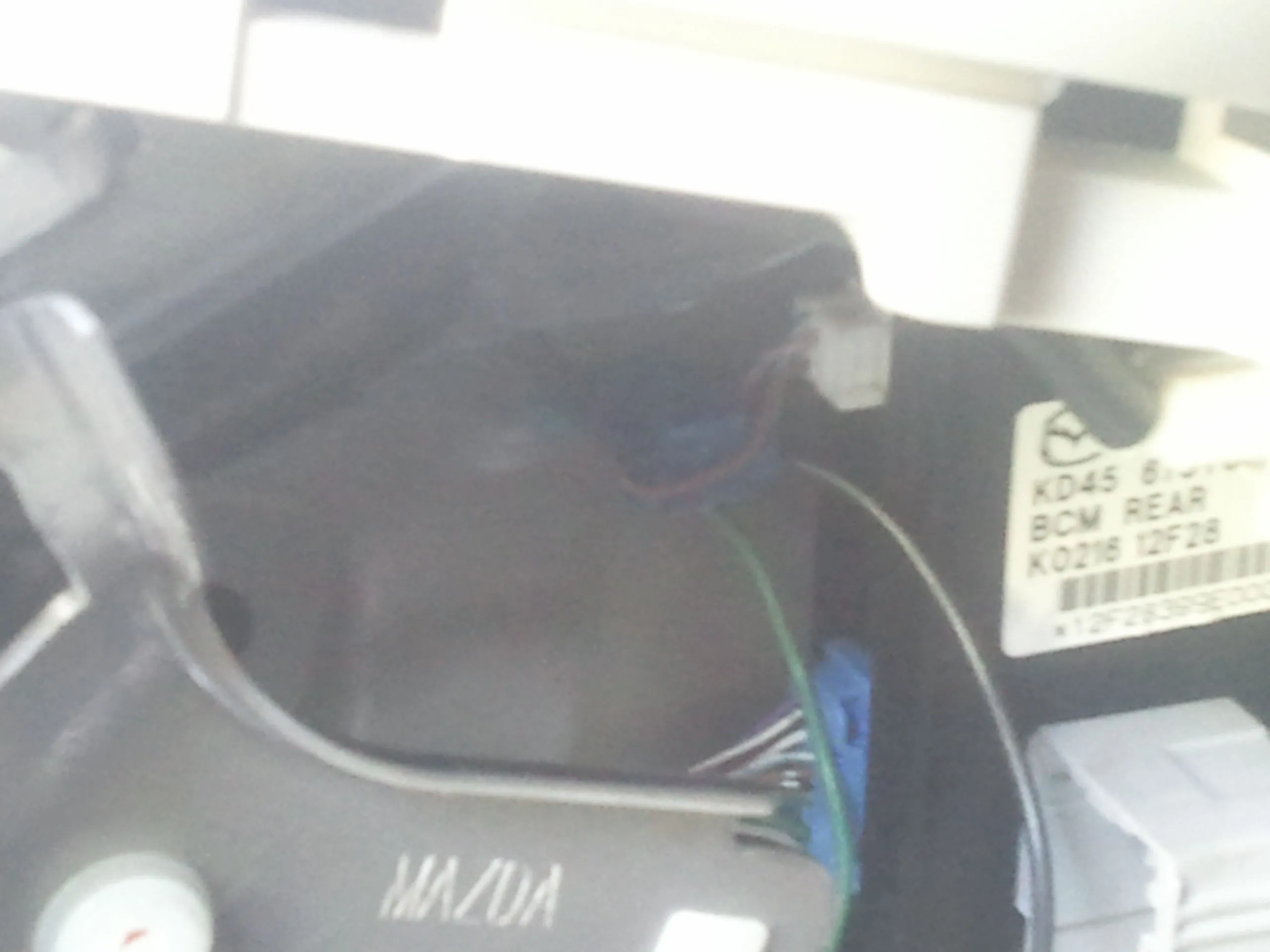

    HOW TO WIRE LED DOOR SILLS GUIDE with some photos Part 1
    Ok, here goes my first attempt at the how to guide of how to do something. I hope this helps all those who struggled with the task that I was finally able to complete Saturday afternoon, which was of course wiring LED door sills.
    Materials List/Tools
    1.) LED Door Sills
    2.) Phillips Screwdriver
    3.) Small Flathead screwdriver
    4.) 10mm socket and ratchet
    5.) Pliers
    6.) Quick Clip Wire taps
    7.) Wire cutters (maybe)
    8.) 2 small pieces of thicker wire (The LED wire was small, and I had a hard time keeping it in the quick connectors so I soldered a thick wire to the end.
    9.) Printout of the wiring schematic: 3 pages (http://am.mazdaserviceinfo.com/emazd...ml/0918_8.html)
    10.) Extra 3mm double sided tape (optional, but read others who said it was helpful, I applied as much as I could).
    I believe that was all that I used.
    Procedure:
    1/2.) Not meant to be offensive, but remember that this is a Japanese made car so things aren't done the way an American would think they would be. As in I want to wire these LED lights, I probably want to tap into a wiring harness located near the fuse panel which is on the drivers side under the steering wheel. Right? and as other have posted they connected....WRONG! This was my first attempt about a month ago, I was able to find a harness connector that when disconnected would turn off the dome lights. Even managed to find 3 hot wires in the harness that would when connected light the door sills. SCORE, however when grounded they would not turn off when the doors were closed. DANGIT. With help from the forum, I was told the the circuit was ground switched/delayed, that I need to find the dome ground wire. Easier said than done. Spent 2 more hours trying every wire in the harness....NO GO...lights remained on. So I disconnected and did more research.

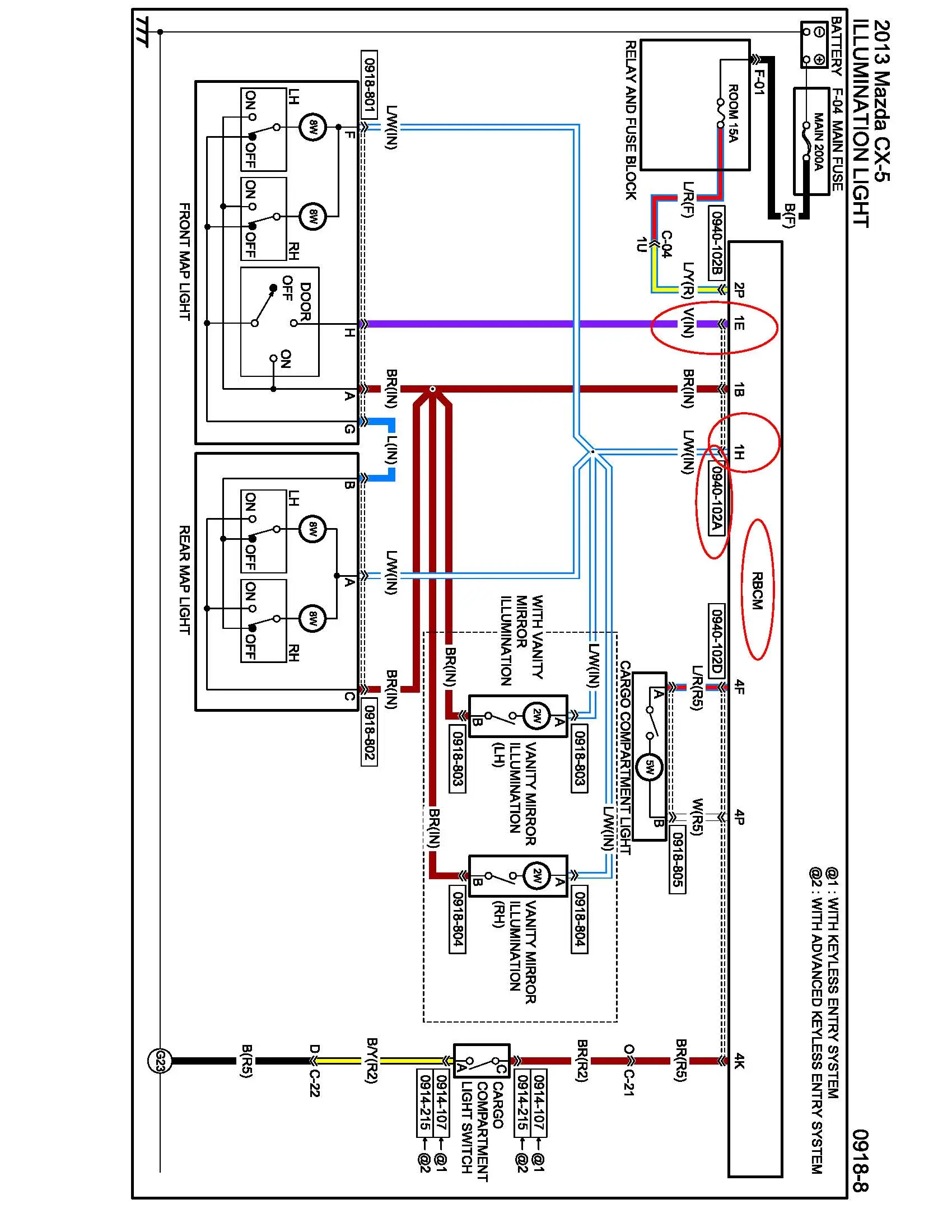

    Step 1.) Print the wiring schematic. Either here: http://am.mazdaserviceinfo.com/emazd...ml/0918_8.html

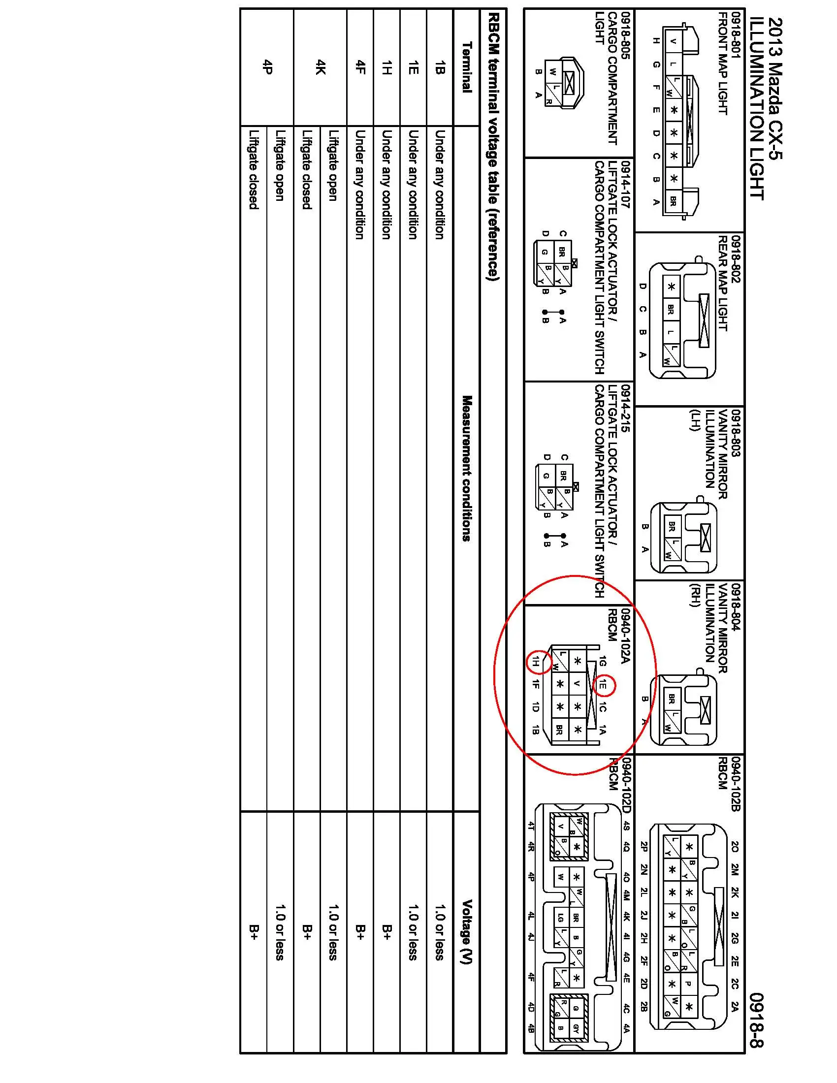

    Or: Use these: (Pay attention to the red circles)Flash_Part1.jpg Flash_Part2.jpg Flash_Part3.jpg
    2.) Pop off the door sill plastic panels at each door. They are just snapped together and should pop out with a slight tug upwards. I decided to attach my door sills to the metal sill instead of the plastic panel. So I also lifted the rubber seal trim piece up a little and fed the wire from the led underneath, then replaced the rubber seal. Connect the longer wires to each of the led door sills and snake the wire to the BACK of the car. I was able to use the small straight screwdriver ans slide the wire underneath the plastic that was on the pillar between the front and back door. You may want to leave one of the door sills unattached but connected and laying inside so that you can test the wiring later and ensure that they do indeed turn off.

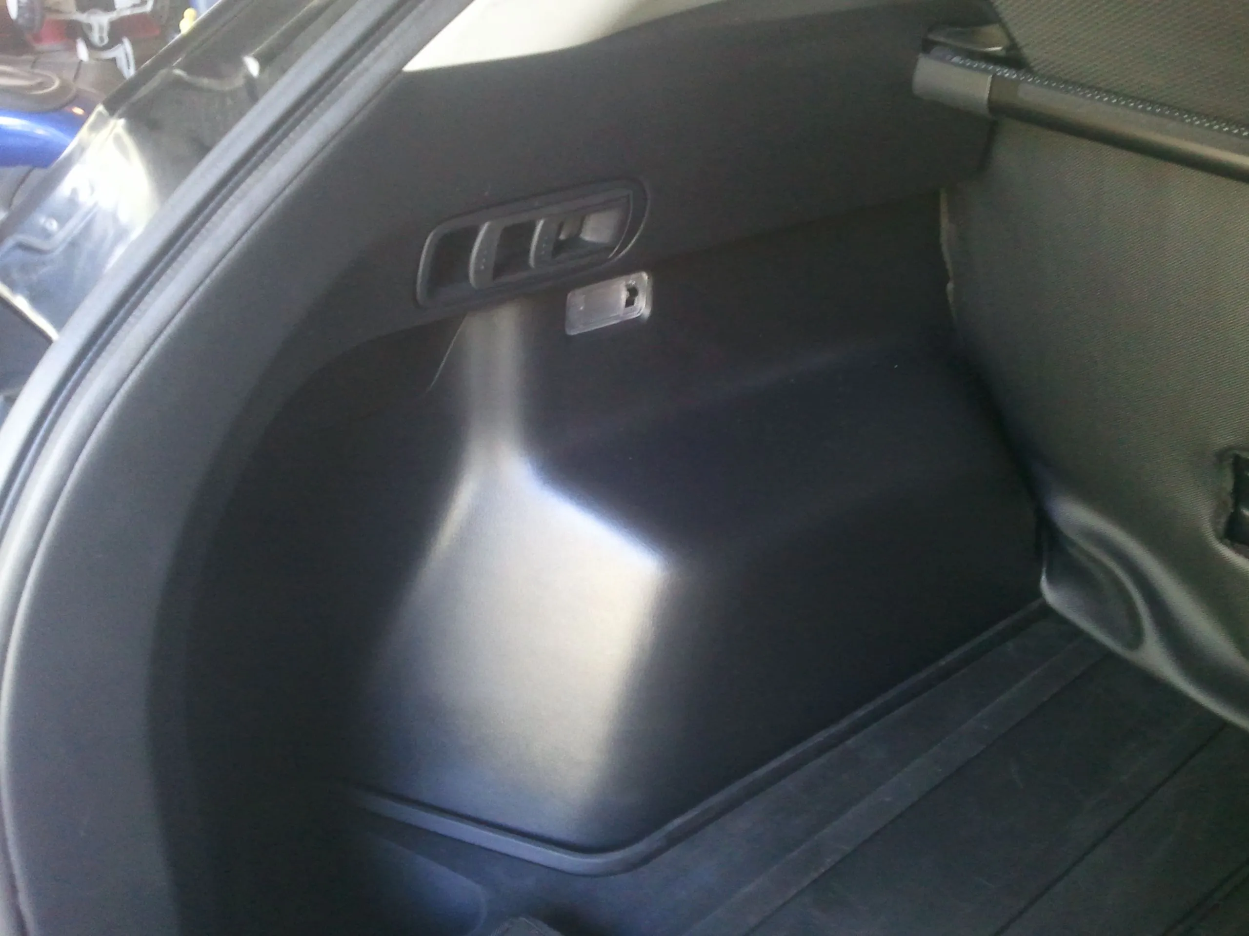

    3.) Open the back hatch. I am assuming for those of you with right hand drive your back side panel will be opposite, but you need to remove this. 2013-07-13 17.37.37.jpg. The back quarter panel, for me it was the side with the rear cargo light and the latches for the 40/20 seat release. (I have 40/20/40 seats). To remove this back quarter panel, you must first remove everything from the cargo area. I took out everything down to the spare tire, leaving just the spare tire in the rear. Next remove the trim piece that goes across the back tailgate and hatch clasp. There is a panel popper pin on each side. Use a small flat screwdriver to pop the center circle up and the pin will come right out. The trim piece then pops out with a tug upwards like the door sill plastics did. Next you will see and need to remove another panel popper pin that is holding the quarter panel that was underneath the trim piece you just removed. Using the flat screw driver you will need to pop open 3 covers. 1 will be located that the levers for the seat release, and the other two are the cargo hooks. The cargo hooks cover opens from the bottom and hinges up. Use the ratchet and socket to remove the two screws from the cargo hooks, and a phillips screwdriver to remove the screw from behind the seat release levers and also where the cargo cover/shade attaches. The quarter panel can now be pulled and popped off the side of the car, as there are only a couple panel poppers holding it. Watch the cargo light and seat levers are still attached. The seat levers can be twisted and sent through the hole, and you can reach behind the panel and unhook the wire connecting the cargo light.

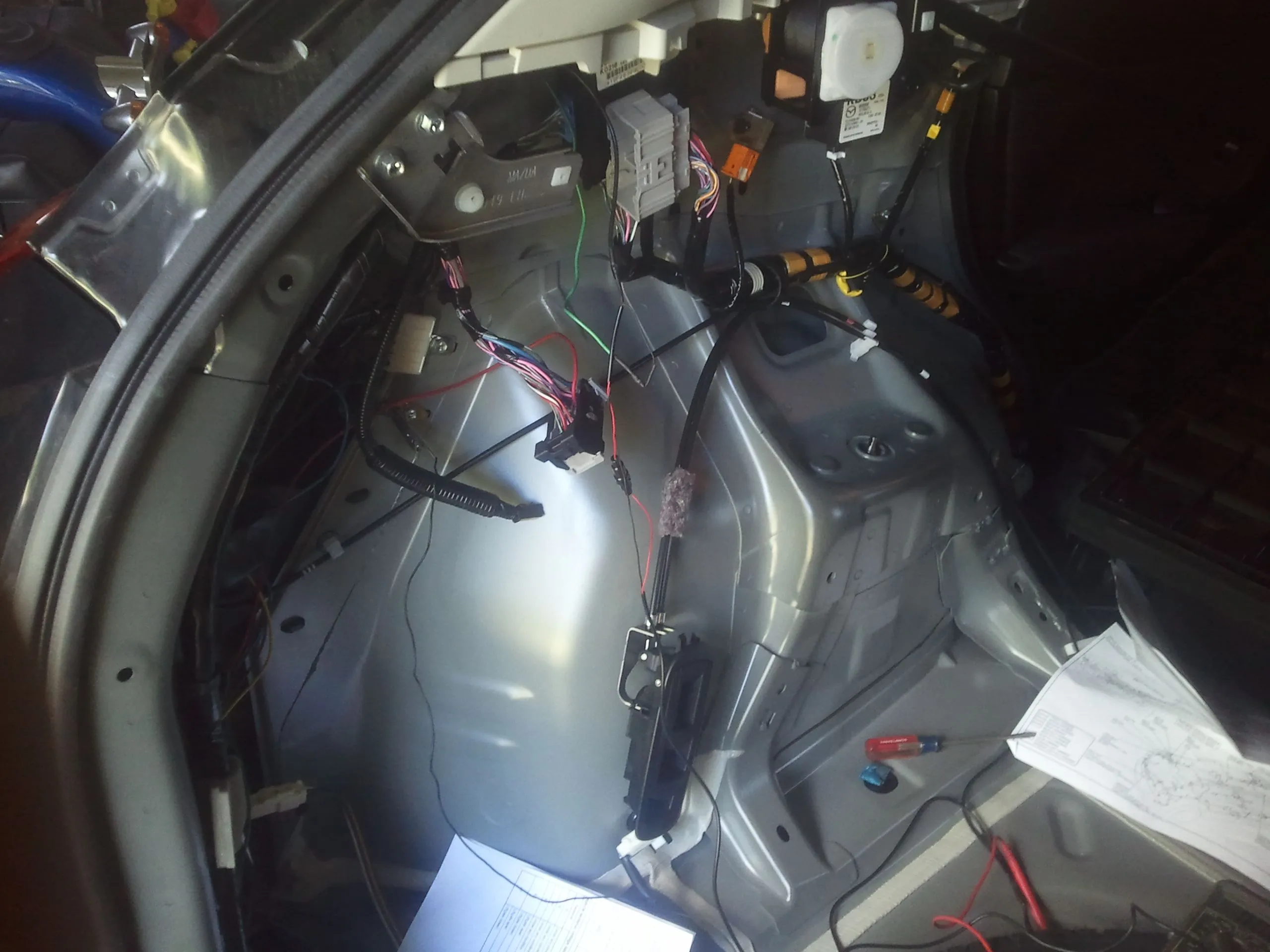

    4.) With the rear panel removed you should see a few black modules and multitudes of wires attached to the side of the car. 2013-07-13 16.49.12.jpg You should find a black box, possibly with a wiring harness connector attached to it, mine did. That reads BCM rear or something to that effect. This is the RBCM that is referenced in the wiring schematics. There are two wiring harnesses that are connected to the bottom (white) and 1 blue harness connect to the left side. I removed the wiring harness that was connected to gray plug on the RBCM, as seen in the picture. You can verify if you so choose by removing each of the plugs 2 white and 1 blue one at a time from the RBCM and you will notice that 1 white and the 1 blue cause the dome lights to go out when removed, while the other white just causes it to fade when removed. You actually do not want either of these wiring harnesses as they do not match with the 0940-102A harness as circled on pages 1 and 2 of the schematic.

    HOW TO WIRE LED DOOR SILLS GUIDE with some photos Part 2
    4. Cont.) The wiring harness 0940-102A which contains the important 1E violet ground wire and the 1H Lavendar/White (Blue/white) hot wire is located above the the blue harness, as seen here: 2013-07-13 16.47.03.jpg (you will also notice the blue quick connecters that I used to tie into the wires. ignore the green and black wires those were the wires that I used to attach to the LED Door sill wiring.) This white harness above will only have 3 wires. A violet, brown and blue and white. As posted in the door sills post these are the wires that tireman1 was mentioning here: post #15 http://www.mazdas247.com/forum/showt...418-Door-sills. You need to tap into the blue and white wire for the power and to the violet wire for the ground.
    5.) Zip tie the door sill wires to some of the other wiring to ensure it was out of the way. You may also want to zip tied the inline fuse that the door sills have back towards the tail lights, so that it could be easily reached via the access panel that allows for the tail light bulbs to be replaced should you ever need to replace the fuse.
    6.) I left the battery connect the entire time, as I chose to listen to music while I worked. So at this point you should notice that the door sills are lit if you have a door open. You may want to do a test at this time to check that the door sills go out when all the doors are closed and the dome light times out. (This is why it was important to leave one sill unattached and laying inside.)
    7.) Replace the panels. Starting with the front doors and working your way to the back. And that should do it. So now when you open the doors you should see this: 2013-07-13 20.59.00.jpg
    I hope this helps all of you who where as frustrated as I was trying to get these things all wired up. Honestly if I had to do it again, I think I could do it in about 25 minutes, instead of the hours I spent up under the steering wheel.... Should you have questions feel free to message me. I'll try to check back on the posts and address questions here.
    Goodluck.

    Thought about this some more. According to the wiring diagrams, we are supposed to connect the door sill into the same circuit as the front dome lights.
    If I had screwed up the wire splicing, then the front dome lights would probably not work either. We I just checked and the dome lights are functioning properly.
    This leads me to think that there is something wrong with the door sill wires.

    If you press the FLOW button and observe the way the current flows in different situations by pressing Door Open and On/Off, it shows that the purple wire is only activated when the switch is in the "Door" position. The map lights would still work when they were manually turned on. I don't know if that helps or not, just an observation.
    Also, I noticed you have a '14 and the OP has a '13, perhaps there was a color change in the wires for the new model. I haven't done the door sills, so I can't say for sure, but just something to consider.
