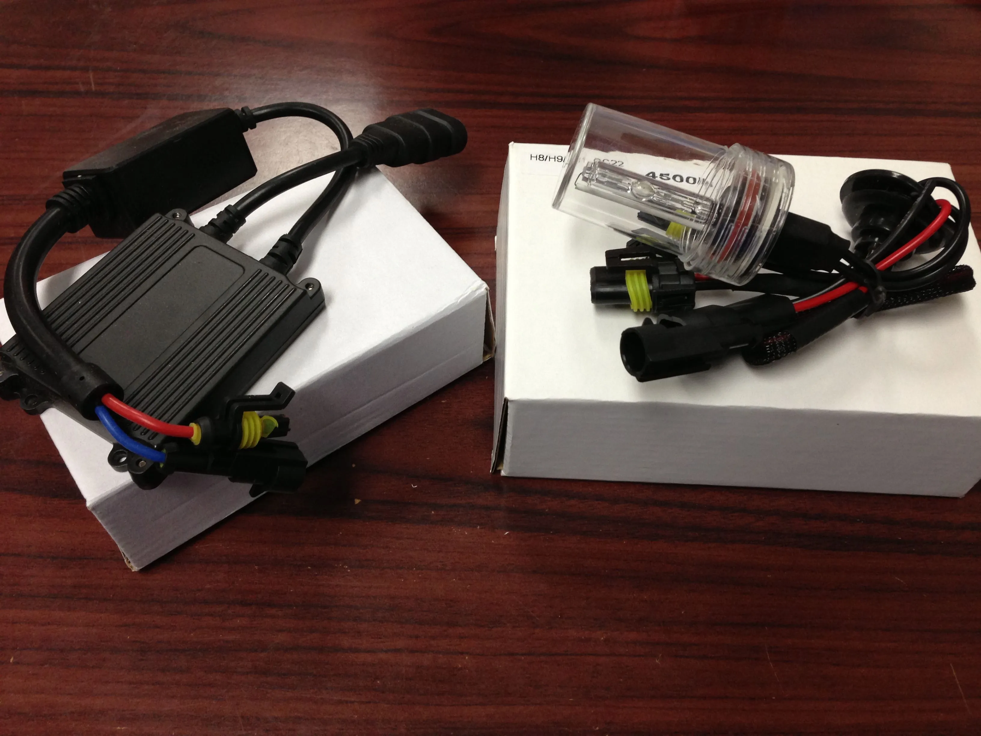

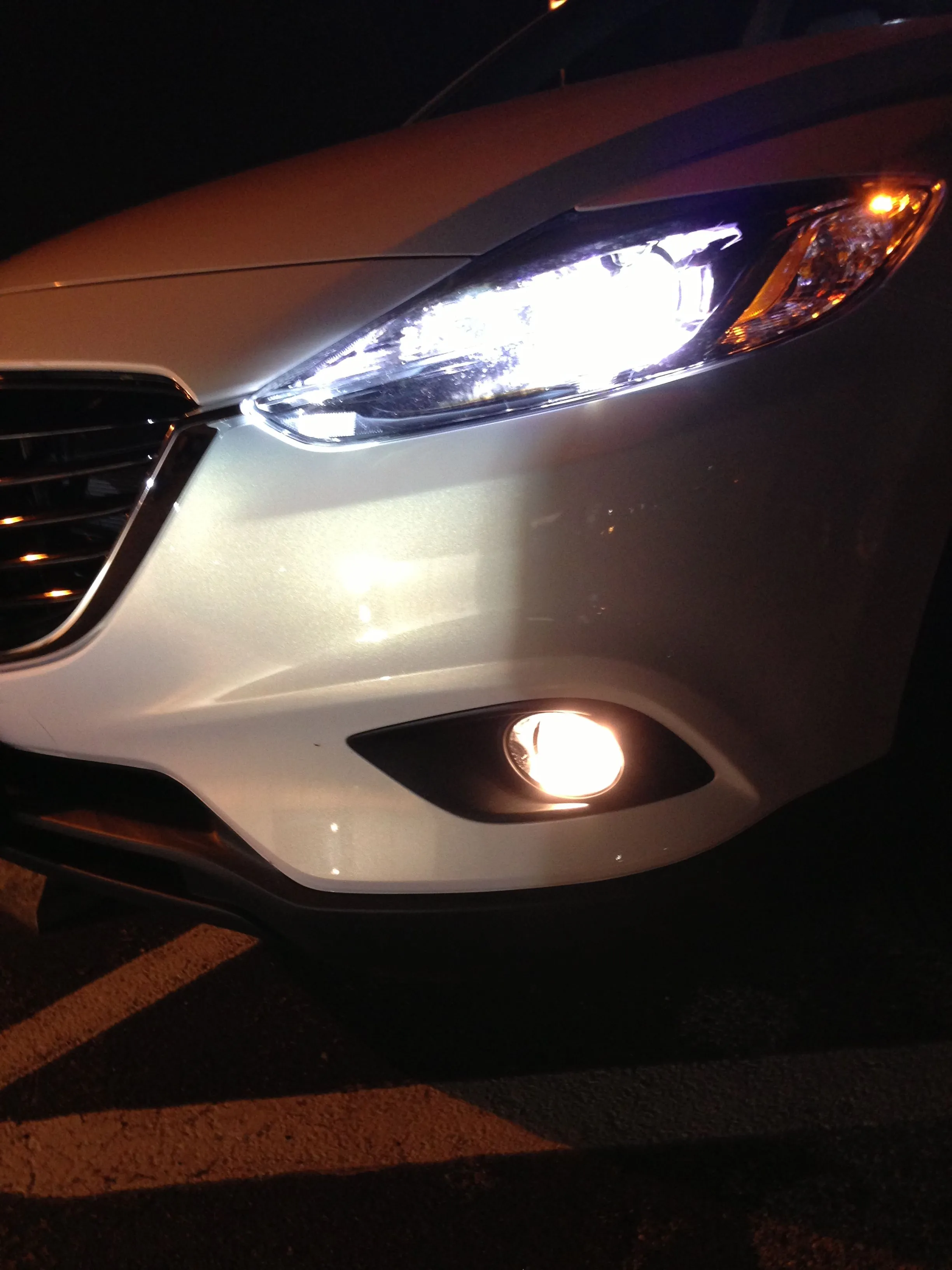

I had to change out the 2013 GT fog lamps. I hated the halogen yellow look when own with the OEM HID's. They don't match exactly, but very close. I just took a chance and ordered the 4500K 35w.
What brand were they? Where they the 35w also? I may order the 6000K and move these to my truck.

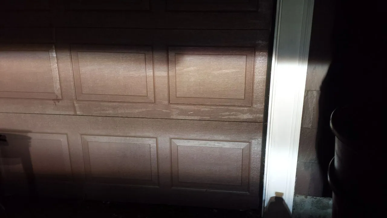

As promised- photos...
You can see the slight difference in color on the garage door. When looking at them straight on you really can't tell because you just go blind from the brightness :)

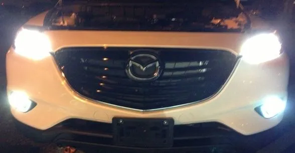

My 2011 factory HID was close to 4300, but the 2013 is closer to 6000. At the 6000's come close to matching the LED DRL's.

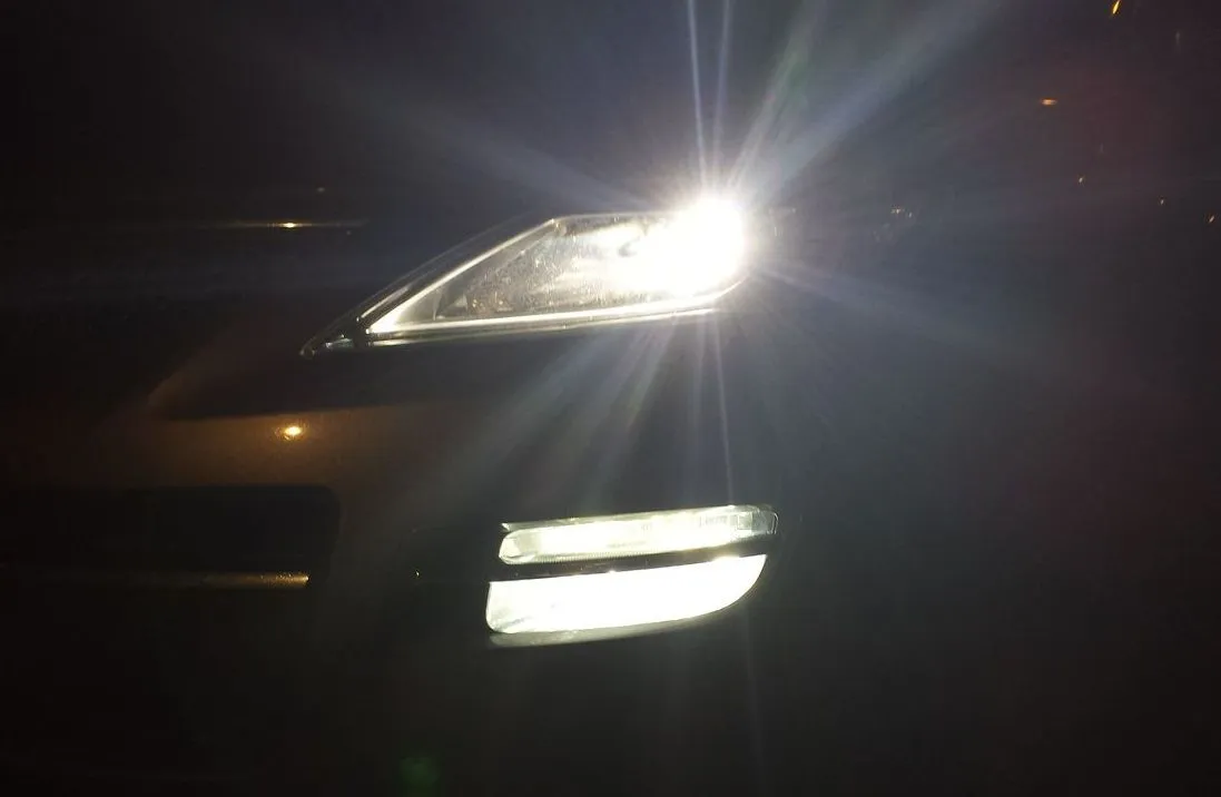

Yeah, I added HIDs to the fogs as well. Even though I ordered 4300k color, it still is more blue (white?) than the factory HIDs. Looks nice though.

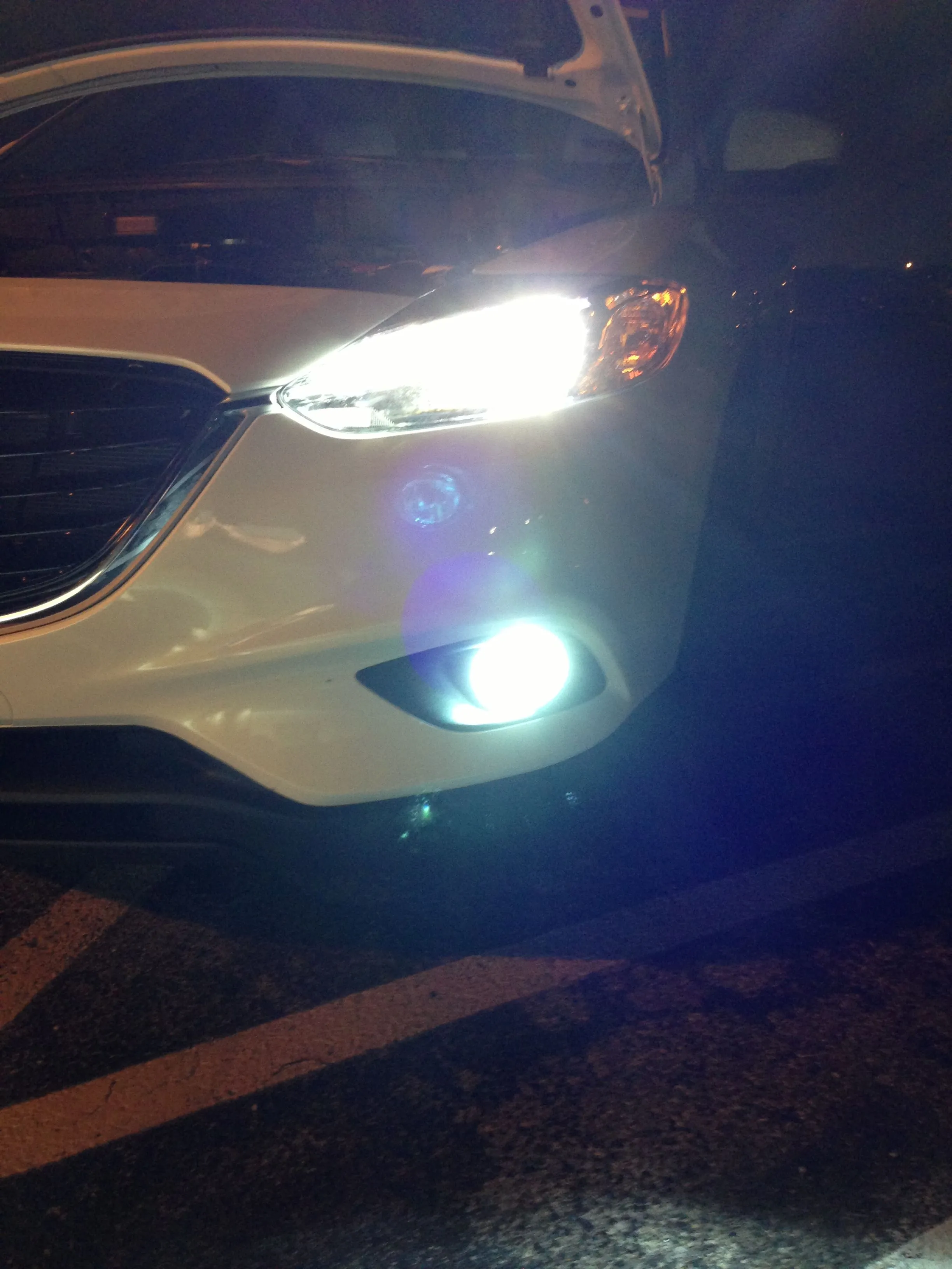

As you can see, the 3000k is a big difference from the OEM HID lights in the low beams. I think it's a big improvement in light output and I can't wait to see them in the fog.
