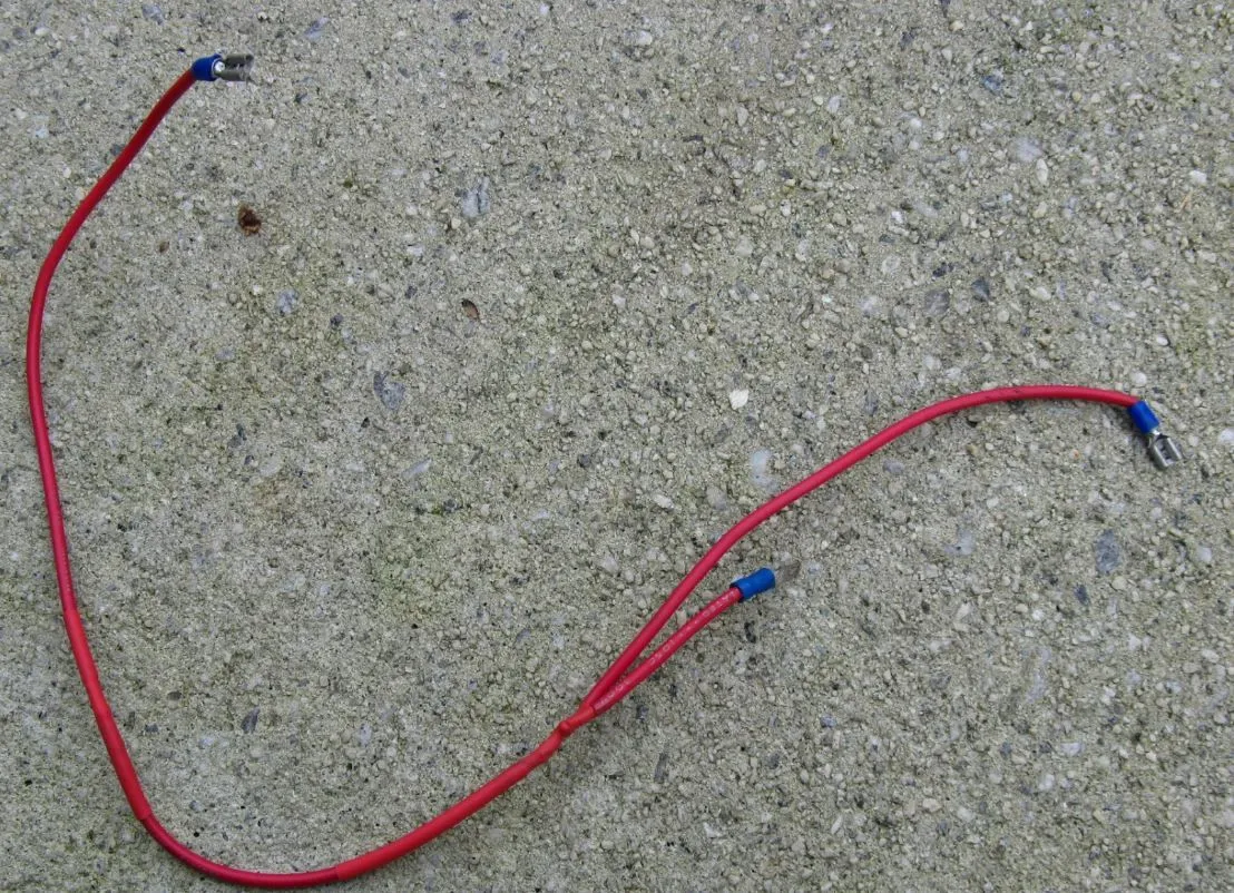

I did this today, added a "Hi" horn on the left. Very pleased with the results. I decided to remove the bumper instead. It allowed me more room to get everything like I wanted. I will say it took a while, but I also had the whole thing jacked up so I could rotate the tires and clean the wheels. I created a mini-harness that I could just plug in to the source and the two horns. Everything on the harness is soldered. Later, I covered the harness with cloth tape in case anything rubbed that I couldn't prevent with wire ties. Fyi, 1. you don't need an extra bolt. One is right there, holding the ground cable. 2. I rotated the ground cable 90 degrees to the right so I didn't have to cut the curve off the top (you'll see). The horn had its own curve and that is the only way I could get both to fit.Wire Harness.JPG
I just realized that I didn't take a picture of the finished product. Not going back in though.

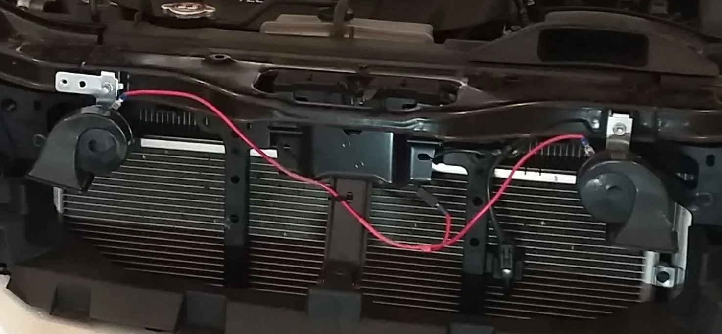

I thought I had forgotten to take a picture of the wiring. It turns out I took some with my phone. Here is how I wired the horns before I covered the red wiring with cloth tape.
