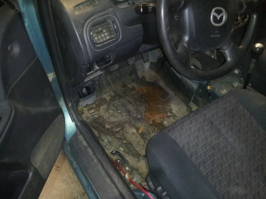

Well, it's been a few months, but I am happy to report all problems have been fixed. In my case the water leaks were caused by the previous owner, who used to have an amplifier in the trunk, and had ran a thick power cable from the battery, through the firewall and into the car. The big hole that was drilled into the car was never sealed properly, and so every time it rained, water would gush in through that hole.
The hole was located on the drivers side, underneath the wiper cowl, right were the hood hinge is. It was hard to get to.
Anyway, got the hole sealed up on the in- and outside with Automotive Black Seam Sealer (costs about 15 bucks at O'reiley's, comes in a tube you can use in a caulk gun) and that stopped the water from coming in.
Of course, the water has been coming into the cabin for years and years (I've owned this car for almost 5 years, it has at least leaked that long, and so my drivers side floor was rotted, both the front and the rear.
Here is a picture of what it looked like:

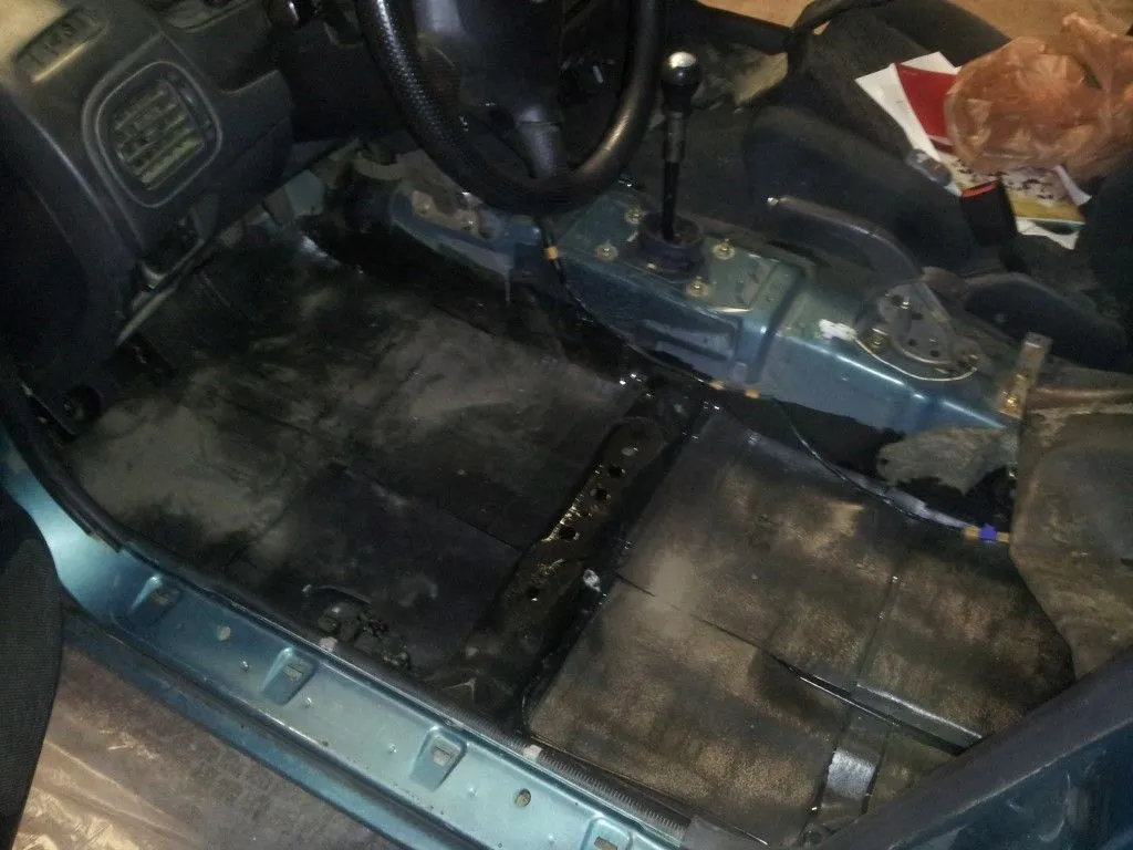

I called a lot of body shops to see who could weld the floor for me, but they all refused to take on the job. Ultimately I googled for "car restoration" shops in my area, and found a one-man small business specialized in restoring old muscle cars, and he said he would take on the job.
I took the interior and carpet out myself, then brought it to the guy. He had the car for a week, welded in new patches in the floor then treated it with POR15 and added soundproofing material. I got the car back yesterday. It looked like this:
attachment.php

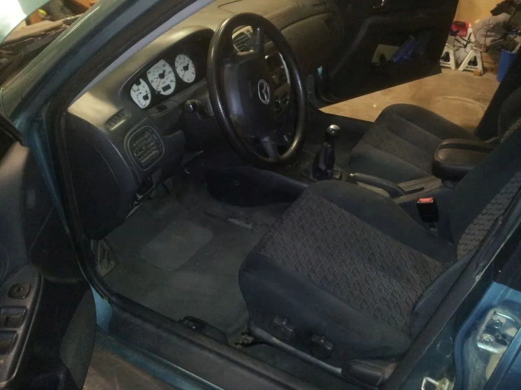

And after spending about 2 hours putting the interior back in, it looks like this:
attachment.php
Total damage: A grand to fix the floor. But, I wasn't able to find a comparable car second hand on Craigslist, and this lil' Mazda just got new shocks a few months ago (front and rear), and I put new brakes on her about a year ago (calipers, discs, pads, lines and fluid), so she practically drives like new. Didn't want to let her go, I love this little car.
