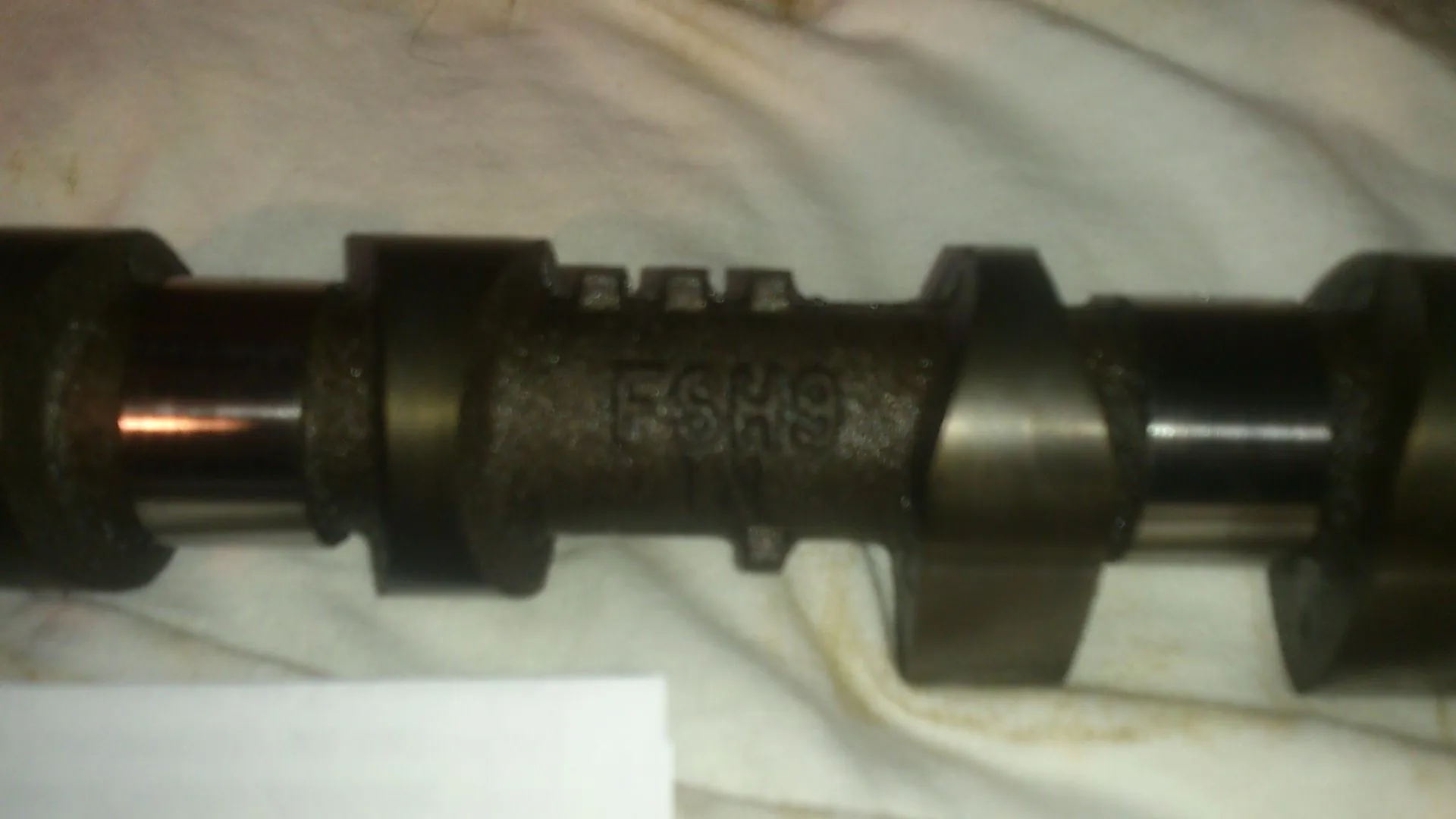

This is a OE Japanese FSH9 intake cam from the JDM FS-ZE engine...advertised duration is set at .017" valve lift (.003" valve seat + .014" lash), bringing intake valve duration up to 242 degrees at that lift...when used with a stock exhaust cam; overlap is bumped to 7 degrees at .017" lift, also...
helps remove the stock cam 'face plant' at ~6,000 rpm...this cam will allow the engine to pull harder up to the FS-ZE set red line at 7,000 rpm...

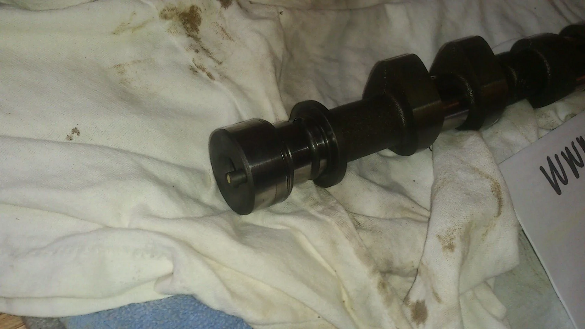

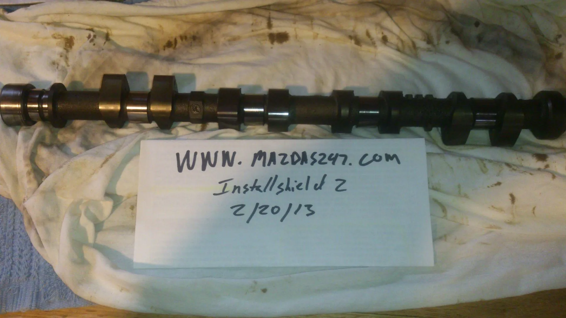

I bought this cam new from Corksport in 2003...Soon after, i found a local probe owner selling an unused ZE intake, and MSF exhaust cam...and bought those, and installed them at the same time...I was also building another engine, and hoped to use this one, but the new requirements of the built engine needed something more aggressive...so this specific cam for sale was used for about 500 miles of testing, and removed...and is in about as perfect shape as possible...
Its spent its easy life in my basement, sealed in plastic, swimming in clean engine oil...absolutely no rust or issues of any kind with any section of the camshaft...When i took these photos this morning, i also mic'd the journals...all of which check out at 1.212", perfect with factory specs...

Again, this is about as unused as possible...it was in long enough to know it fit and had no problems whatsoever, then removed...
