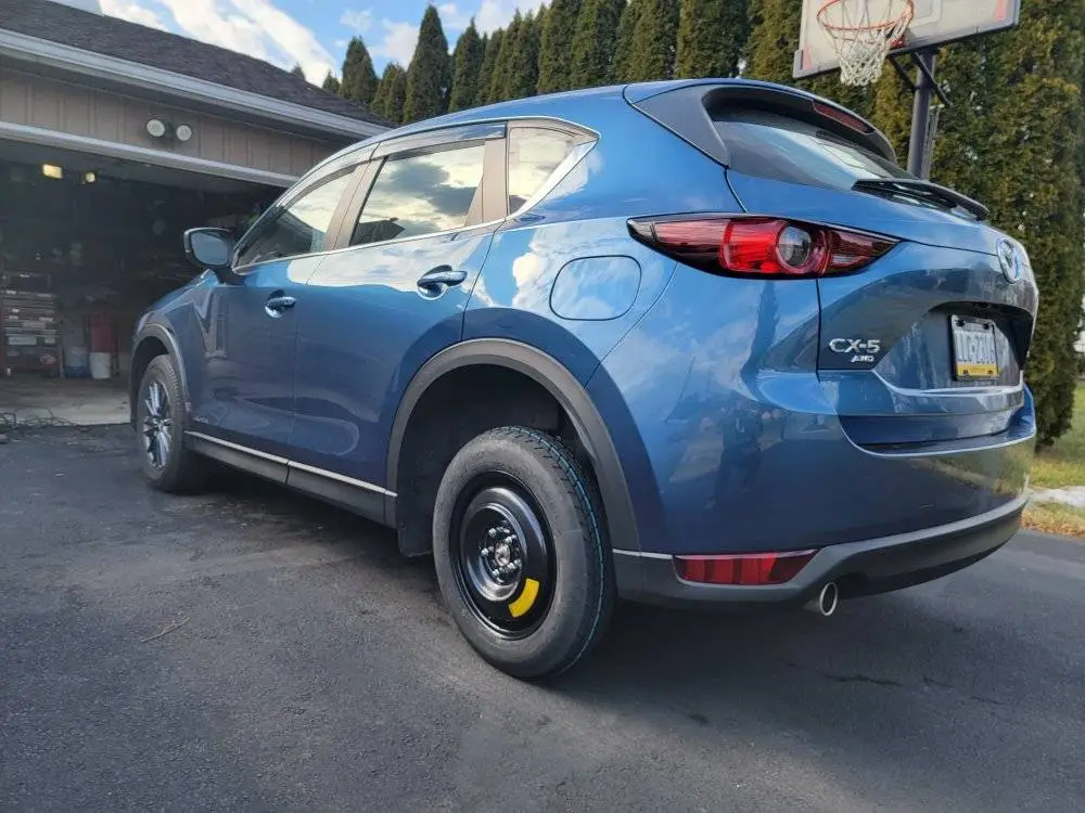

Took this Saturday morning. It was at the dealer Friday for an oil change and tire rotation and no mention of anything amiss. On our way home from breakfast Saturday morning the TPMS light came on. Got home and found a screw in the center tread.
Either the dealer missed it or we picked it up in the five miles driven after picking the vehicle up the day before.
Mounted the spare, thinking the local tire shop wouldn't have time to get to it until Monday. Thankfully they had time and I was in and out in under 10 minutes and my wallet was $20 lighter. Thought about going to the dealer but pretty sure they'd just say it wasn't there on Friday ans I'd have to schedule an appt. to get it fixed.
You can always go to Discount Tire (or America’s Tire in Bay Area, NorCal) to fix the flat for free even if you have stock tires.
You also want to make sure the tire is removed from the rim and patch the hole from inside. If the tire won’t get re-balanced after the flat repair, you can ask the tire shop to mark the tire and rim before removal, and install the tire at the same position aligning the marks on the tire and rim.
