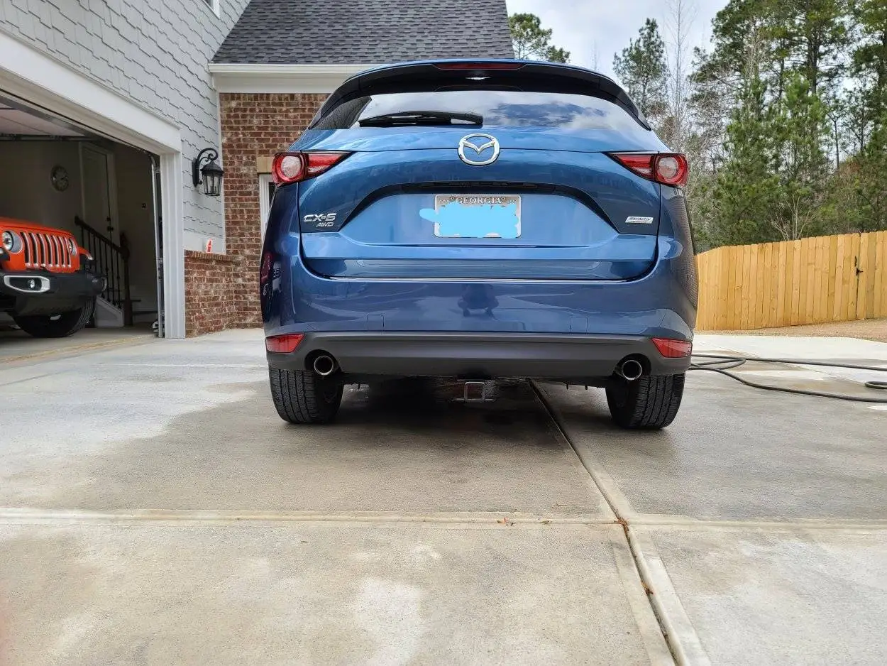

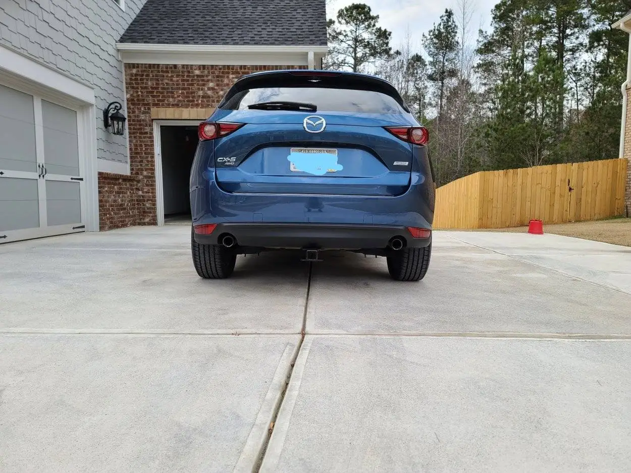

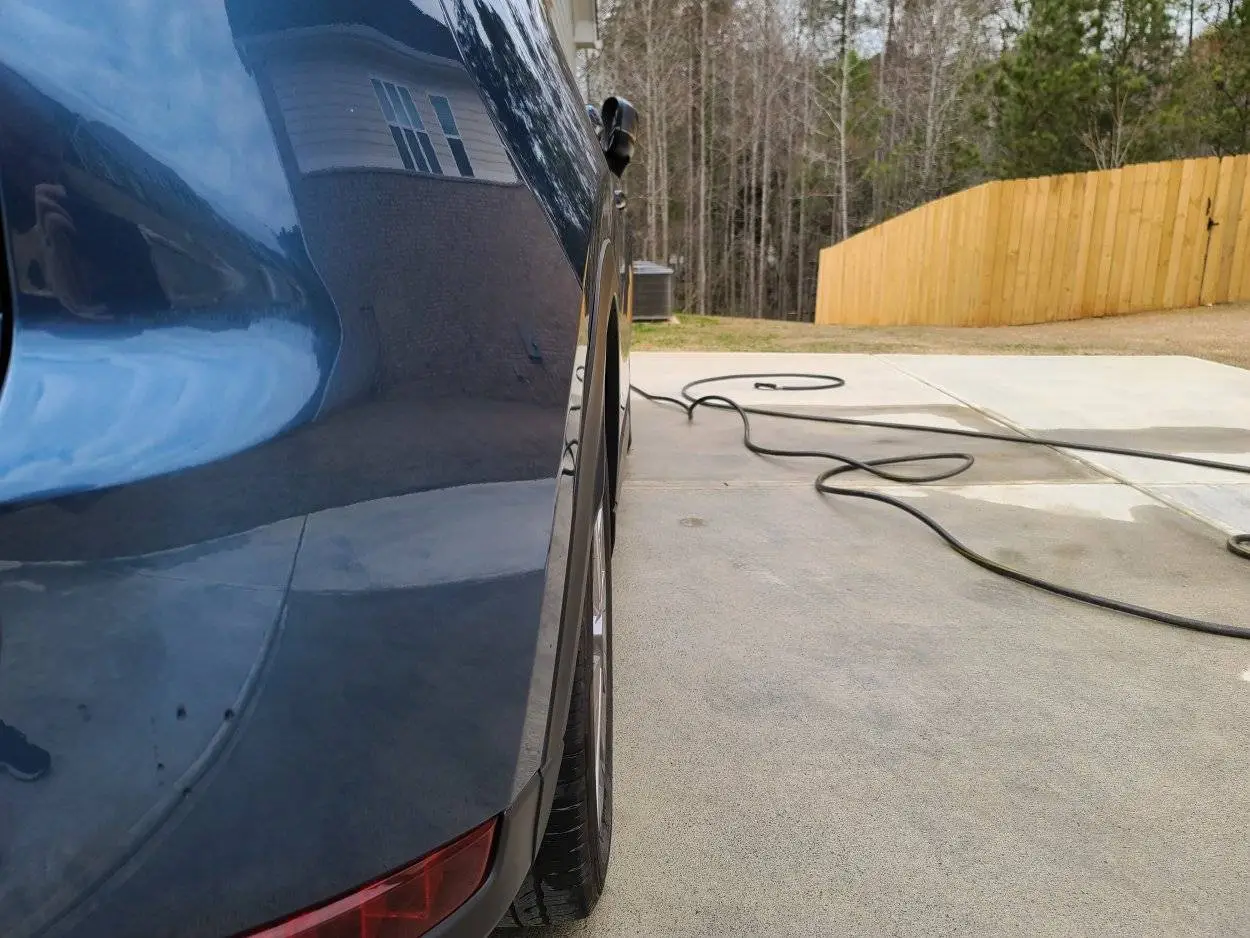

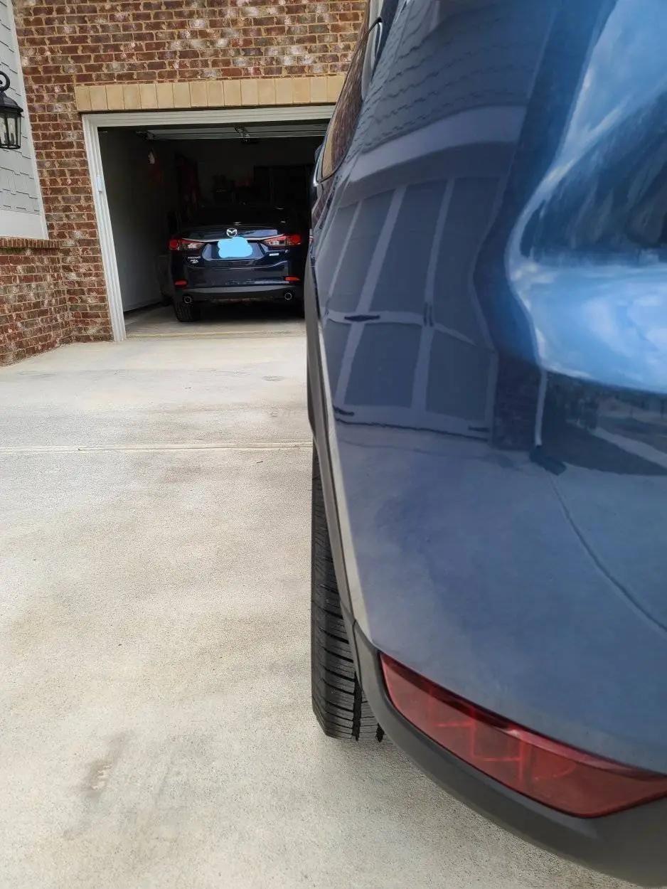

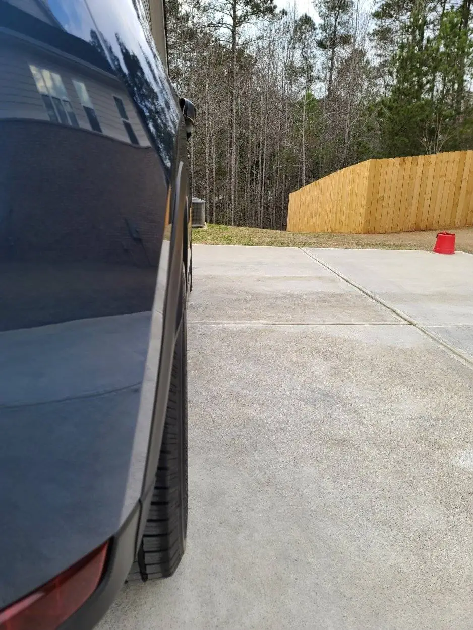

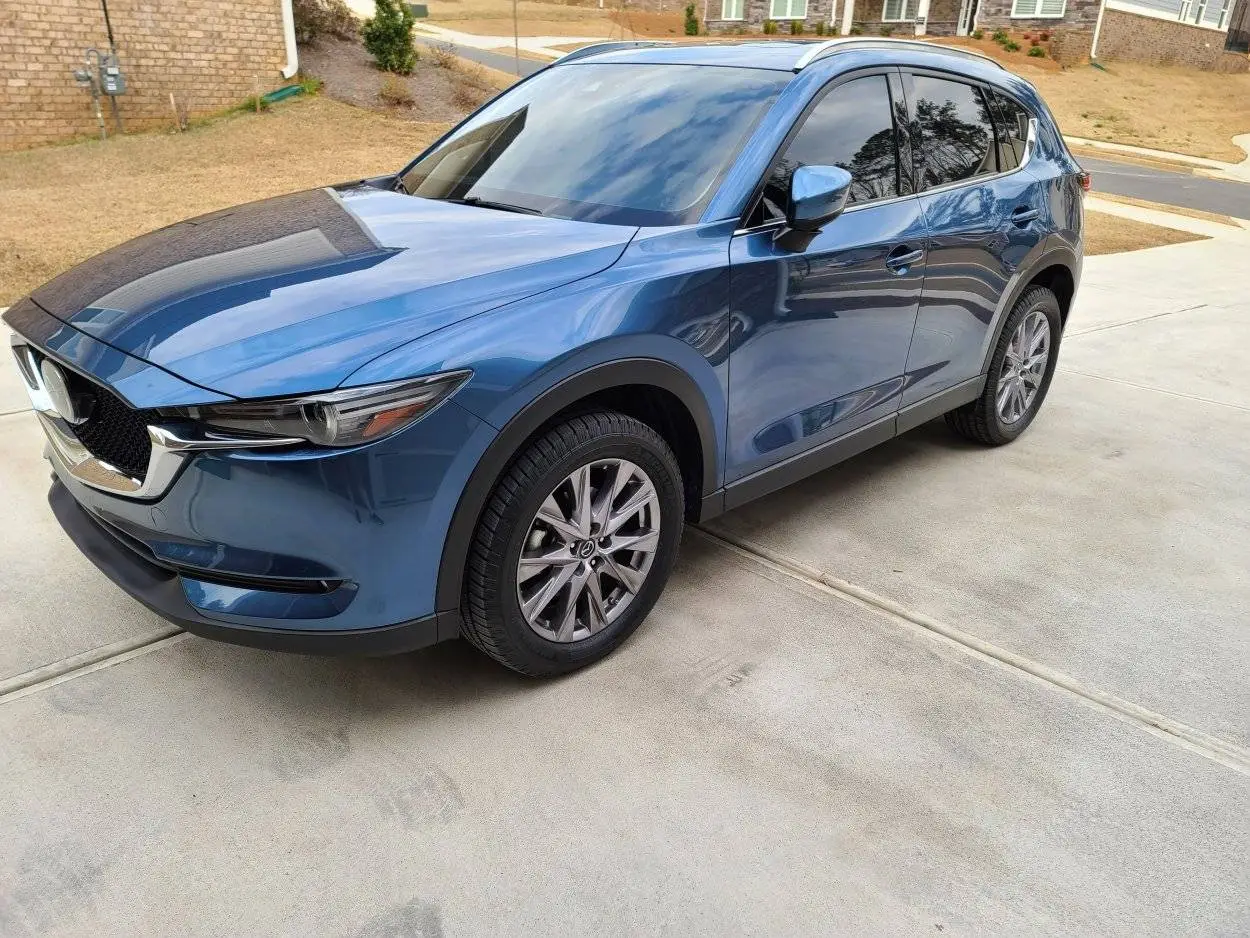

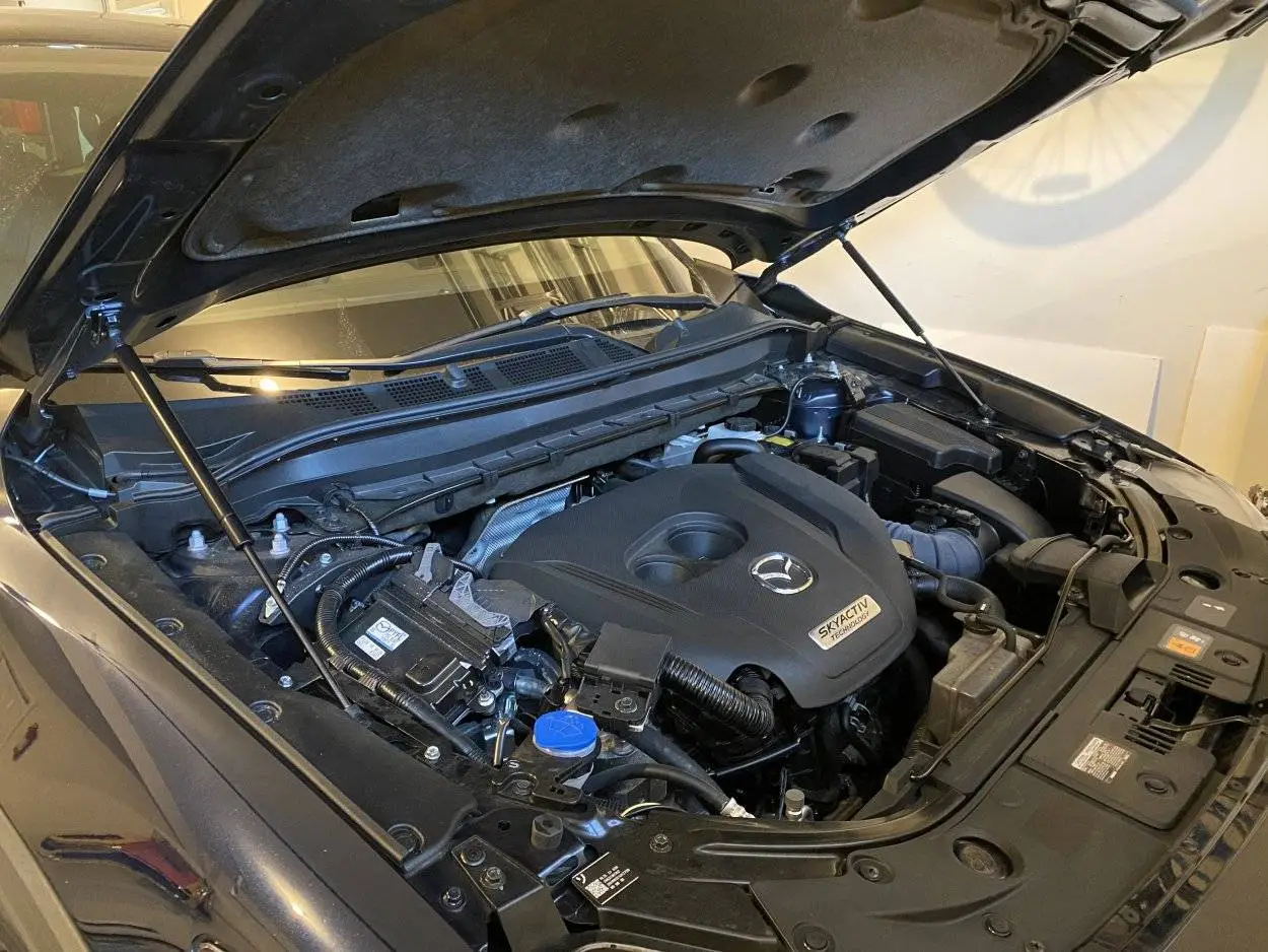

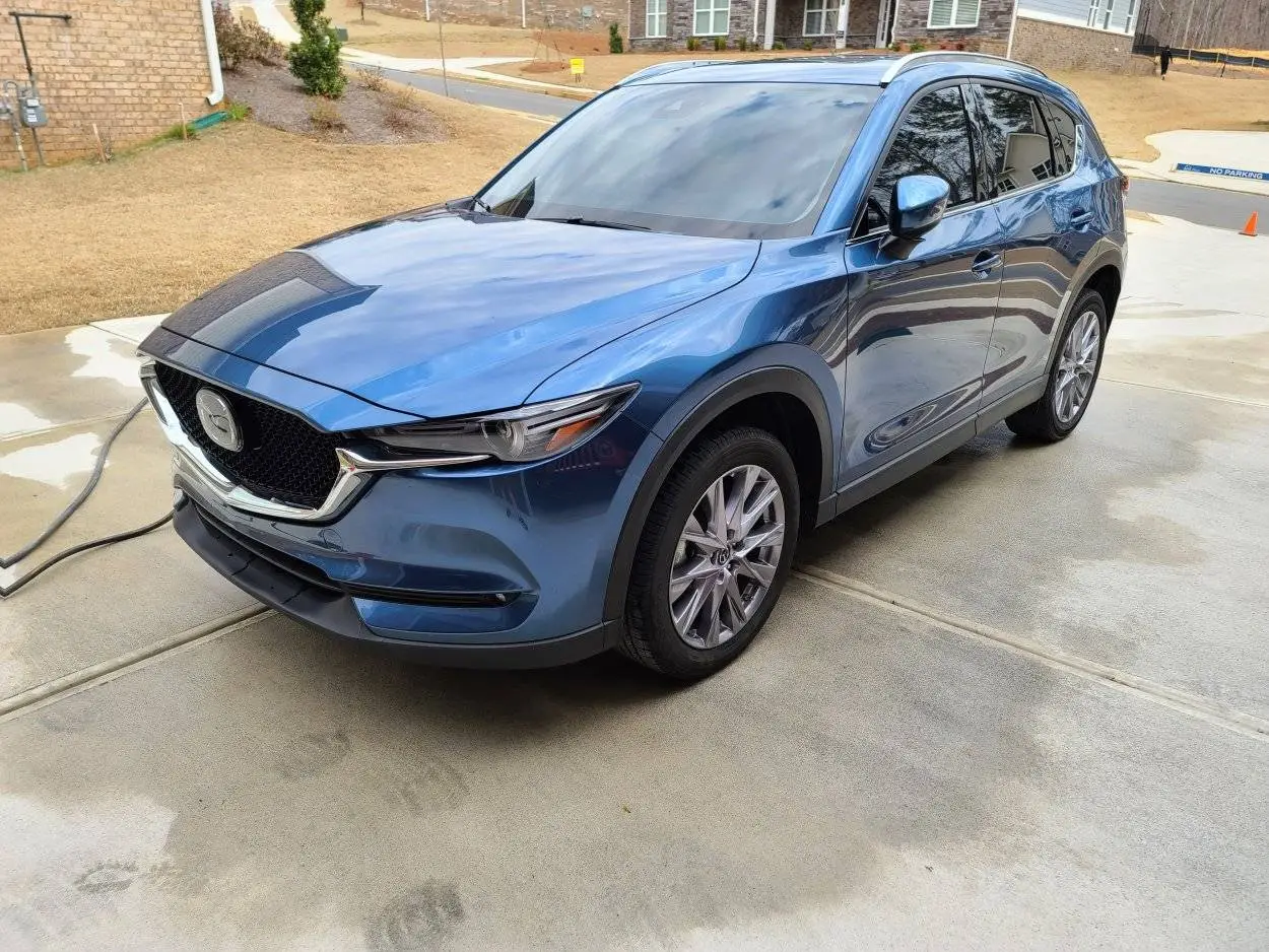

Today old Blu got the following
Washed
Hood struts
New Michelins - 255/50/19

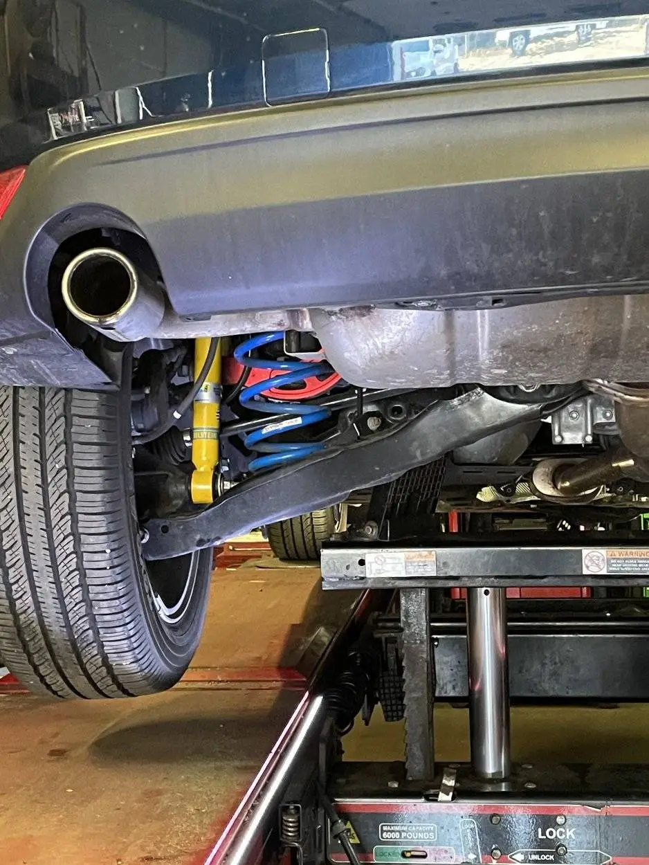

What kind of rear shocks? New rear springs too?
Do you need to separate lower control arm to install the rear shock on your 2019 CX-5 GT-R?
The Corksport drop springs and the Godspeed camber arms were previously installed...Today was a set of bilstein b6 shocks.
When removing the shocks, it’s easier to drop the control arm and take the spring out. Not sure if you can do it any other way.
