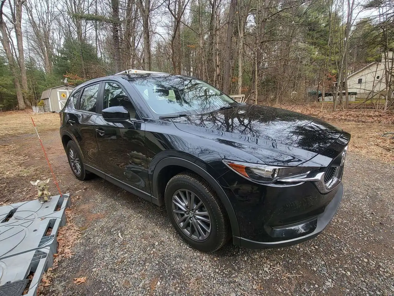

Took my black on black 2018 CX-5 Sport "Speedracer" to the Mazda dealer today for check-up since I just purchased it last Wednesday with only 31K miles on it. First time Mazda owner so I figured best to make sure all is well with it. Had a few OBD codes showing via my bluetooth OBDII scanner which they checked and were benign. Owned a '17 Jeep Cherokee Trailhawk prior but it was totaled in a rear-end collision. Body shop wanted $17K to fix and Allstate decided "NO WAY" and I don't blame them. They paid it off and gave me the balance which I used most of as a down payment on the Speedracer. So far am very pleased with the pep this little rocket has. Let's see how long this lasts me before someone decides to ruin my ride again.

This is the first time that I've heard of the CX being described as a rocket...
Glad to hear that you and Speedracer are getting along so well together.

I call it "Speedracer" because the design (at least to me it does) reminds me of the cartoon of the same name that I used to watch many moons ago....
