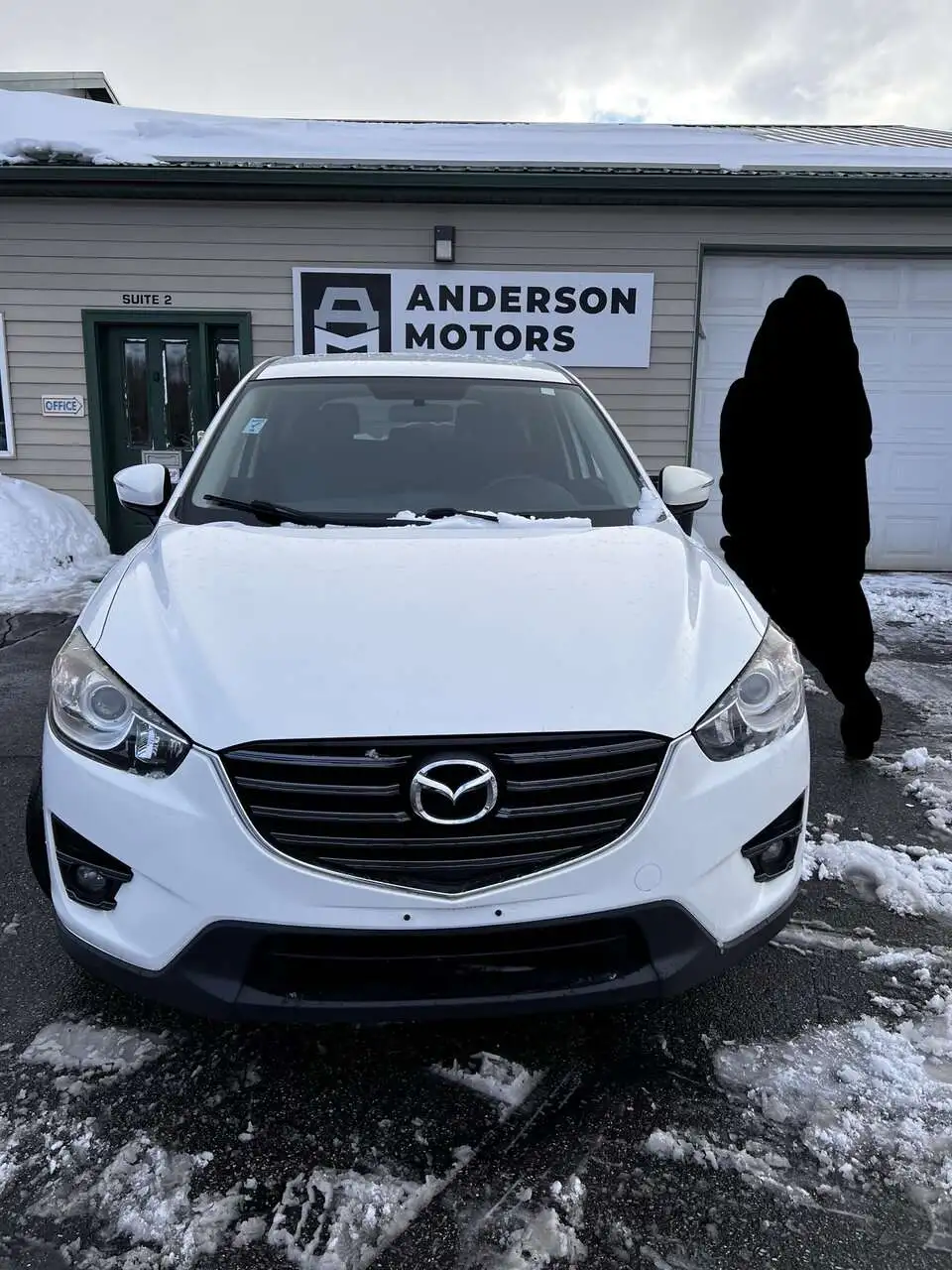

No, you have a 2016 CX-5 Touring; and the headlights are standard halogen. It’s possible the previous owner installed a pair of H11 compatible LED bulbs for the low beams so that the lights look like white.
Here’s what the optional factory LED headlight with LED Signature DRL looks like:
Agree with @yrwei52, they are probably LED replacement bulbs, or "xenon" bulbs as @HyFlyer mentioned. They could also be HID bulbs. When you check under the hood, if you can see a ballast attached to the wiring coming off of the bulb socket, they are HID bulbs.
