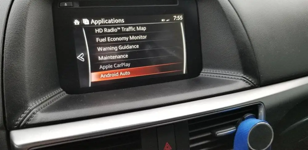

Had a warm but gray day yesterday so I installed the ACP/AA module and harness and am happy I did it myself, no need for dealer install cost, it was super easy thanks to youtube and info found here on these forums (thanks fellow members!).
