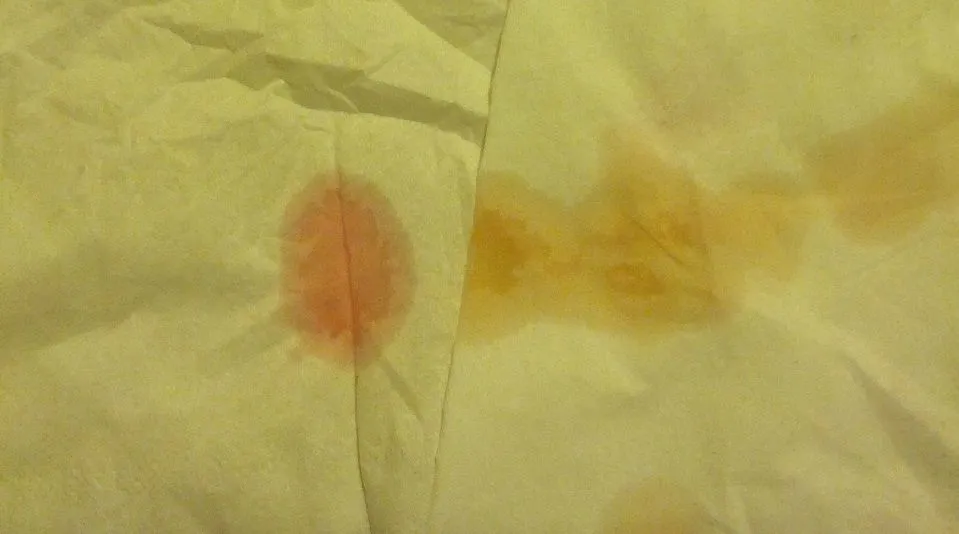

I recently bought a 2003 Mazda Protege LX 2.0 Took it to the mechanic for an oil change and he said the transmission fluid was a bit dark. Suggested I do an drain and fill. The car has 138,000 kms.
I checked the transmission fluid myself today while the engine idling in Park. (picture attached) pink is the new fluid....brown is my transmission fluid
I am not sure what I should do, just drain and refill the fluid or drop the pan, change the filter, gasket etc.
What do you guys suggest?
i know - but im just wondering whats best for the car at this stage
its never been done before
So i decided to do a drain and fill today
