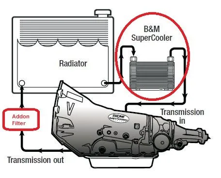

    Here's what I'm thinking.
    Fluid:
    Go straight to Amsoil ATF. Given the price difference of a few bucks per bottle, is it really worth using Castrol IMV? Amsoil ATF can be had for ~$10 a bottle. Will have to make a return and try to get my missing bottle’s worth back…
    Cooler:
    Going with B&M but a tossup between the 70268 or 70264, essentially the same except the *68 is taller while the *64 is deeper (cost more and slightly higher BTU rating). Reviews and pics show the fins seem to be MUCH sturdier than the cheap coolers while only cost ~$20 more. B&M is an old and reputable brand.
    http://bmracing.com/wp-bnmcont/uploa...er_techdoc.pdf
    Filter:
    I was leaning towards the B&M auxiliary filter ($37) but didn’t want the hassle of having to mount it and causing confusion by having two spin on filters below (I think it can use the same oil filter).
    http://bmracing.com/?wpsc-product=re...oil-filter-kit
    Instead I am going with an inline filter. Leaning towards the ATP JX-150 (magnafine) or WIX 58964 which is very similar (both w/ magnet) and only differ by ~$4. While WIX is great, it sounds like it is a lesser rebrand (as it the ATP), but most seem to use the magnafine with good results so I’ll go with popular vote.
    Here’s a Magnafine cut open. Seems to do a pretty darn good job!!
    http://www.bobistheoilguy.com/forums...81#Post2437581
    WIX spec.
    http://www.wixfilters.com/Lookup/Par...spx?Part=58964
    Total would be about $91 (Amsoil) + $59 (B&M cooler) + $18 (Maganfine) = $167 for total protection for a long time. These are all kits so I hope the included hoses are long enough. The only other thing I can think of is Dollar Store/Lowes for a funnel and foot or two of vinely tubing. Anyone taken these precautions? Too much or missing something?

    It could be that the Mobile1 in there is holding up + new flush/fill with the Castrol. I do think (purely my opinion) that the IMVs should be sufficient depending on your location (extreme heat or not), how hard you drive and on the transmission, and how frequently you do drain/fill. Mazda's 5sp auto is a Jatco transmission and is known to run hot. Heat deteriorates the fluid, which leads to little protection, which leads to accelerated wear, which leads to problems. Premium (full synthetic) fluids hold up better and offer more protection. Both Valvoline and Castrol IMVs are NOT systemic fluids.
    Here's an interesting read:
    http://www.bobistheoilguy.com/forums...&Number=936260
    Unless you live in a place where it is cold year round, I don’t believe an additional cooler will result in ‘too cold’ transmission fluid. It is enclosed and gets heated up to operating temperature quickly by all the moving gears/parts. General word of advice to those who do not know, letting your car idle in park (remote start) does NOT warm up your transmission fluid –only your motor oil. Always take it easy the first few miles until fluids are up to operating temperature. Also, you can get a cooler with a lower BTU rating :)
    Amsoil does cost a bit more but I believe it is a justified cost. Transmissions are damn expensive to repair so I’d like to protect it. It’s only $167 for triple layer protection shipped to my door, that’s damn cheap IMO. Shopped Amazon for the cooler and filter and I have a contact for an Amsoil jobber (their lingo for whole seller, PM me if you are interested) that sells it for ~$11.50 shipped per bottle, which is about equal to the Amsoil’s paid preferred customer price+s/h and tax. While Amsoil does cost more, I am more than confidant that it’ll last much longer to offset and make up the difference. I’m at 55K but with the Amsiol+cooler+filter I am confident it can last up to 100K (or next 45K) minimum before I need to think about it again. I can most likely last longer after that. It may appear cheaper to use the IMVs at first glance due to low initial cost per bottle but the constant drain/fill can add up quickly.
    Here's how I calculated my next 45K miles (100K) and came to the conclusion to return the Castrol.
    *Amsoil – $92 for 8 quarts per flush shipped to my door. One time flush affair.
    *Castrol - $18 for 3 quarts per drain/fill ($6 per quart and drive to Walmart). Multiple efforts and you never actually have clean fluid in the system.
    **In intervals of 5K drain fill with motor oil, 45K/5=9 changes. 9x$18=$162!! Spent by the time I hit 100K.
    **In intervals of 10K drain fill with motor oil, 45/10=5 changes (rounded up). 5x$18 = $90, which is equal to Amsoil from the get go without having to consistently doing drain/fill with an inferior product.
    **Or, I would do two full flushes with Castrol, 25K interval, $6x(8x2)=$96.
    The cooler and filter will only make both fluids last longer. Part of me do feel using Amsoil with a cooler may not be necessary. Either Amsoil alone or cooler and IMV may suffice but what that heck, it’s not that much considering I don’t have to think about it for a very long time; except occasional checks.
    The Amsoil came in yesterday, still waiting for the other parts. And yes, the inline filter looks like a no brainer considering it is protection for <$20. Install is very easy. You want to inset the filter in the line right where fluids comes out of the transmission case. The idea is to intercept the fluids as soon as it exist the trans case and filter it before it pass on to the next component. I'm not sure about the weight of these things once the fitler gets saturated as this will surly add some weight. Will likely need to find a fixture to zip-tie/clamp/mount to the filter base.
    This will give you an idea.
    Below is a good reference on doing a flush. Note that this was created back when there was confusion on Mercon V vs Mazda M-V. Do NOT use Mercon V ATF. Good to get an idea of the process invovled and where the hosese are.
    http://www.flex-innovations.com/atx_flush.htm
