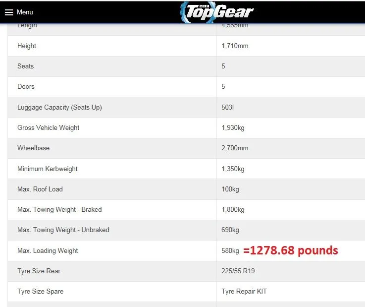

it was an old post, but yesterday I just carried about 921 pounds on my CX-5. And made me nervous, so I did a quick research. Post here for someone need it. ^^
Totally is about 1200 pounds.
Please check the attachment.
