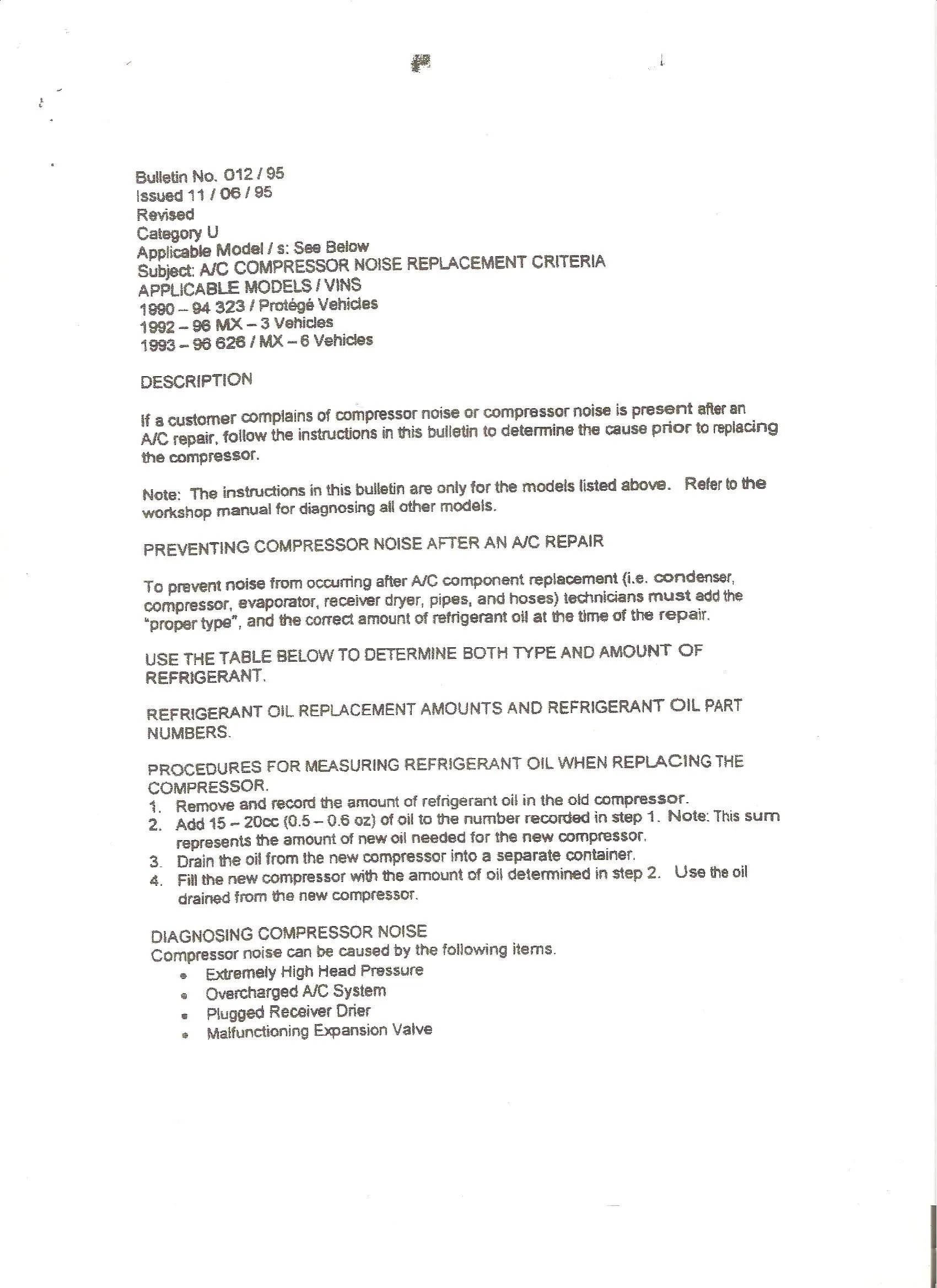

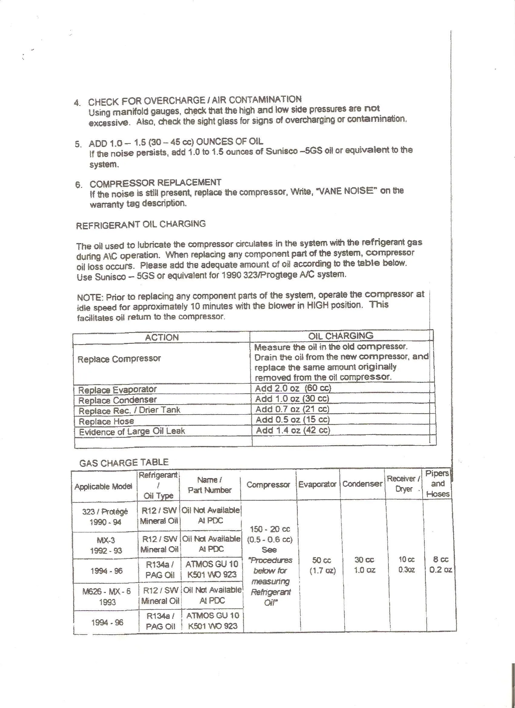

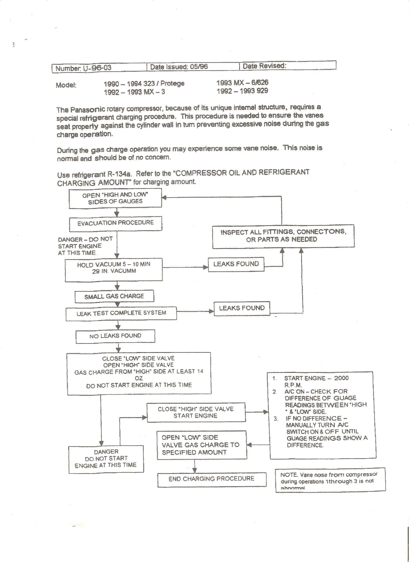

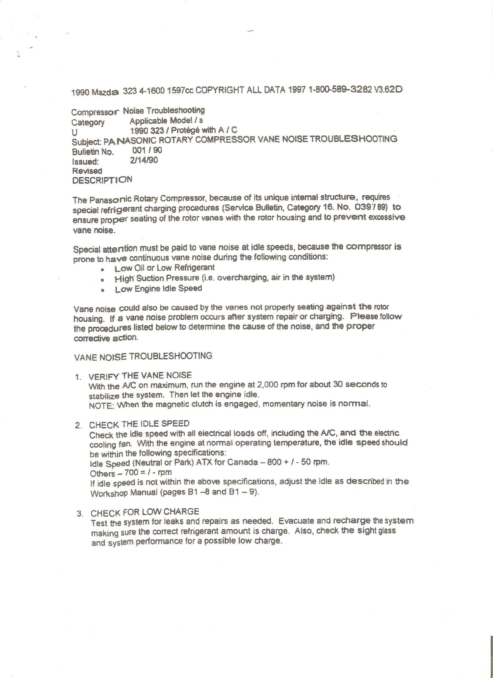

I've also encountered this issue of a loud ticking noise from the compressor. The noise has appeared so far on four out of the nine Mazda Protege's in service in our Maui car rental fleet, causing complaints from customers. Apparently, the vane type compressor used in these cars is susceptible to this kind of noise. An a/c tech sent me a TSB regarding this ticking noise. I am trying to upload it and post it here.
Once the noise starts, it progressively gets worse. At first it's intermittent, then over time it becomes constant and gets louder and louder. The procedure outlined in the TSB doesn't accomplish any noticeable improvement. Eventually it is necessary to replace the compressor. Even though the a/c still blows cold, the noise is just too loud for comfort, and disquieting to our rental car customers. We use re-built compressors, at about $150 a pop. One replacement re-built compressor was put in more than three years ago and is still running without any problem. The others are more recent and all running ok too.
