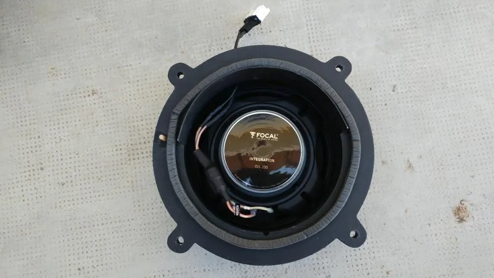

I did not go for great looks, just for the sound. When I close the lid, it is all covered anyway. I had to add the 2x4s and some other pieces to raise the lid. The speaker height and the excursion of the speaker, needed more headroom.
So, did you install the Lanzer 8" speakers and the speaker cups without having to use any mdf template? How did you go about installing these to the doors? And finally, are you guys just cutting the factory speaker clip harness off and wiring directly to the new speakers with some electrical connectors?
Plug Metra 72-5602 into door speakers then into CX-5 speaker harness, 4 pins for separates if coaxial speakers you jumper 2 of the pins.

If your concern is that you dont want to cut the wires in car harness to plug the new speaker, you can tear apart the old speaker (which is already broken), take the connector and solder it to the wires of the new speaker. That is what I did.
