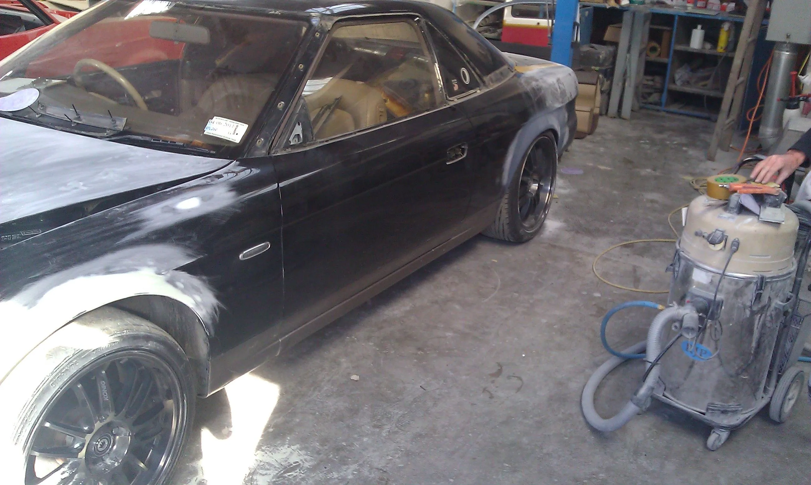

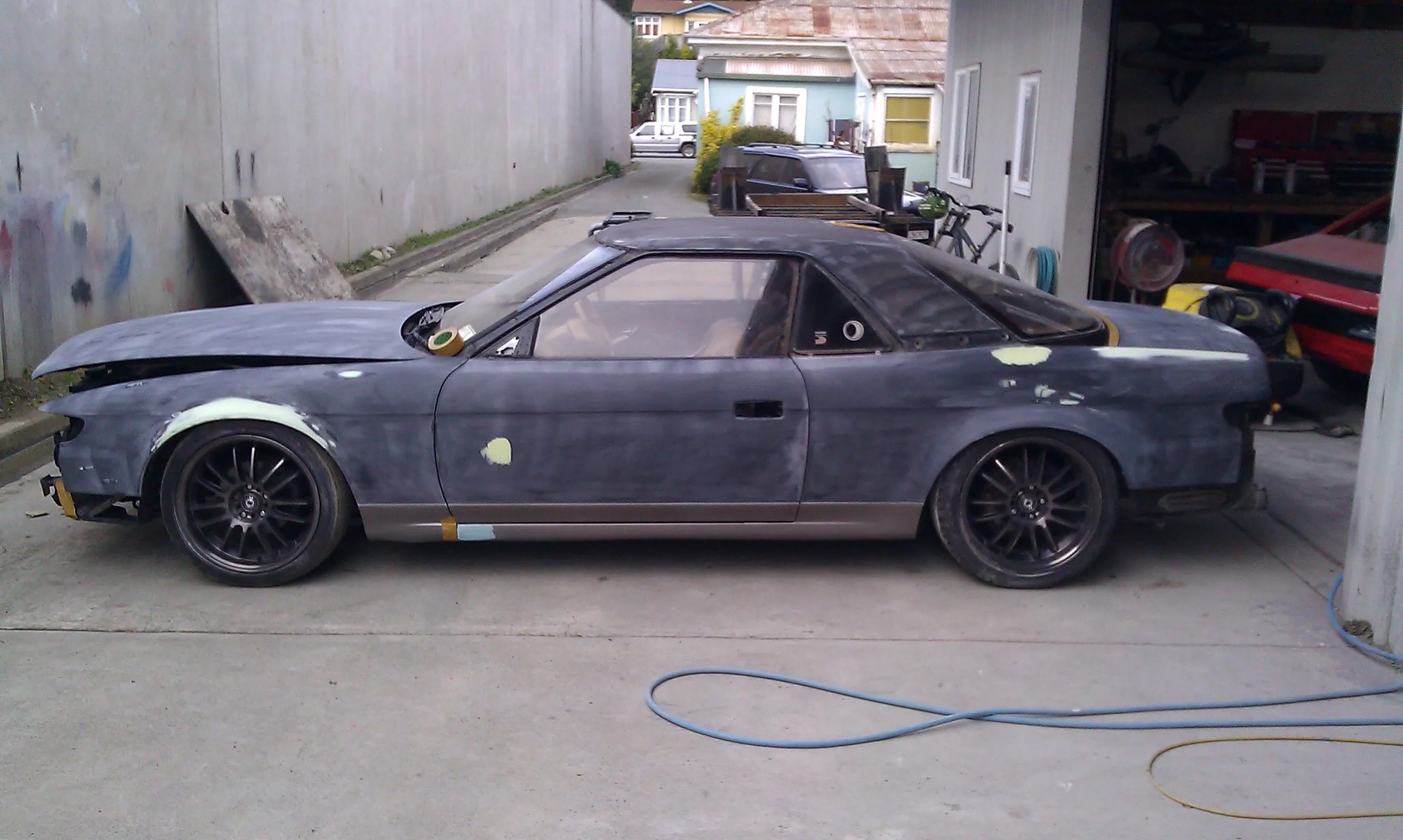

these seem to be the only photos i am able to up load at this time tim. the windscreen side trims did require a big bravery pill to remove. i wasn't keen on removing them, but my paint guy talked me around. i believe there is some screw at the base then its just use's little clips up the sides, with the right tool these came off fine.
as for the side trims, as mentioned there is a number of small screw's under the rubber which just pulls off over the top, but is mounted to the metal trim at each end.
its hard to see in the side shot pic but behind the rear quarter window the trim is bolted on, along with the trim strip on the rear pillar. you will need to remove the rear seats and interior trim to reach the nuts holding these on. hope this helps and best of luck
