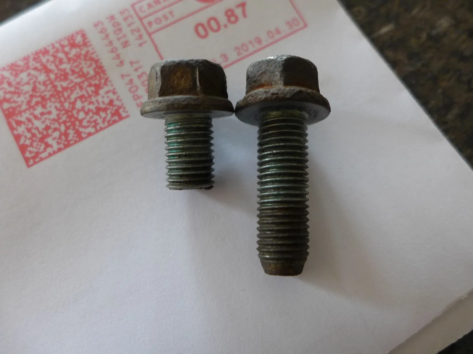

This is what i removed compared to a new one in the middle
Also note, these are the revised bushes so there is obviously a relatively short lifespan on these

Two sway bar bushing bracket bolts snapped when I tried to replace the bushings. The locations are rear driver side and front passenger holes. Accessing the bolts from the wheel wells was a struggle. Had to extend 1/2 inch socket with a pipe and unscrew one ratchet click at a time. They snapped when the entire exposed rusted portion contacted all the hole threads. I guess friction was too great.
Now there is a bigger problem of removing the Gr 8 bolts stuck in the subframe. Tried to drill a hole in the subframe directly below the bolt to reach it but the small 1/16 drill bit didn't make a dent. Any suggestions.

To finish the story, I drilled a 1.5" hole with a Lenox holesaw in the subframe below the broken bolts. Next I drilled out the bolts with some cobalt drill bits. Then switched to a 1/2" bolt and nut after the bushing change. No more annoying clunk.
