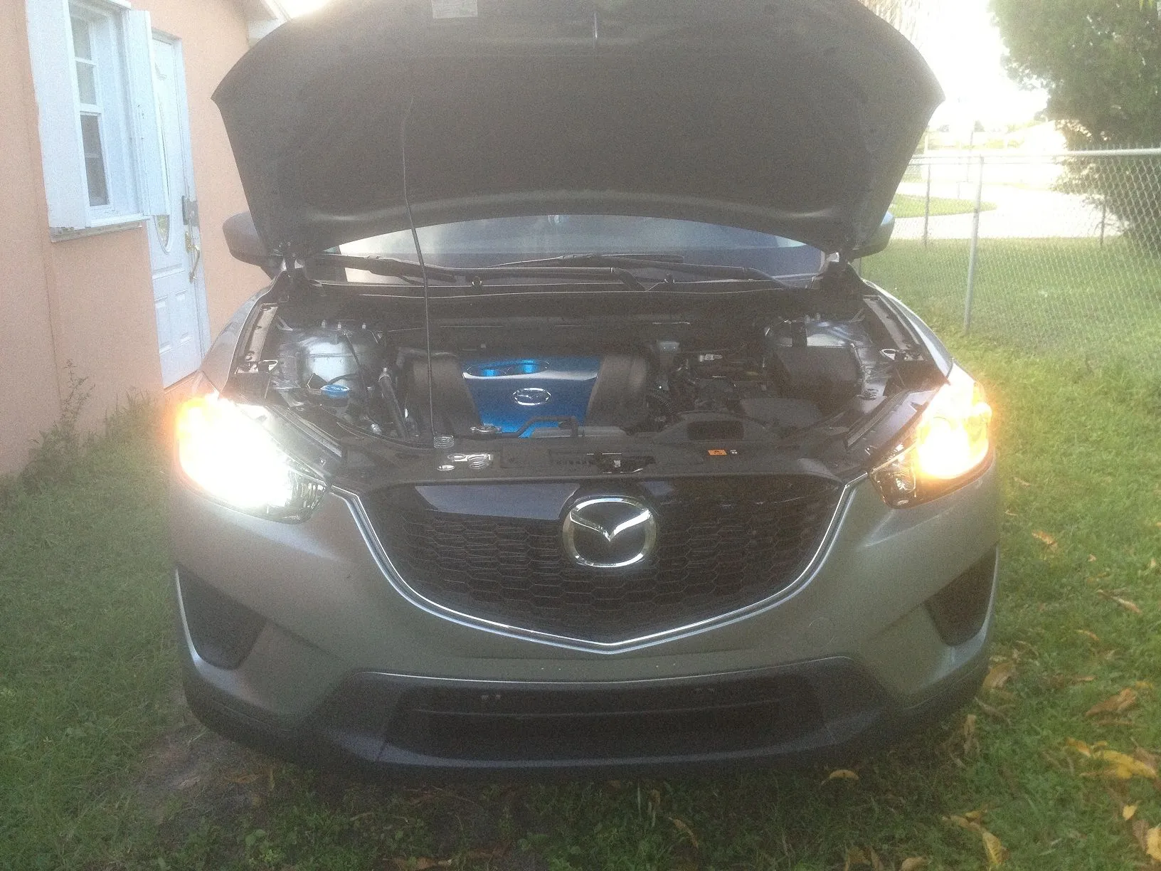

4500 ddm slim kit installed and I'm not impressed at all. Light output is less then stock. Were my expectations unreasonable or could these be a bad set? Red wires are matched to light green so I don't think it's an install issue.

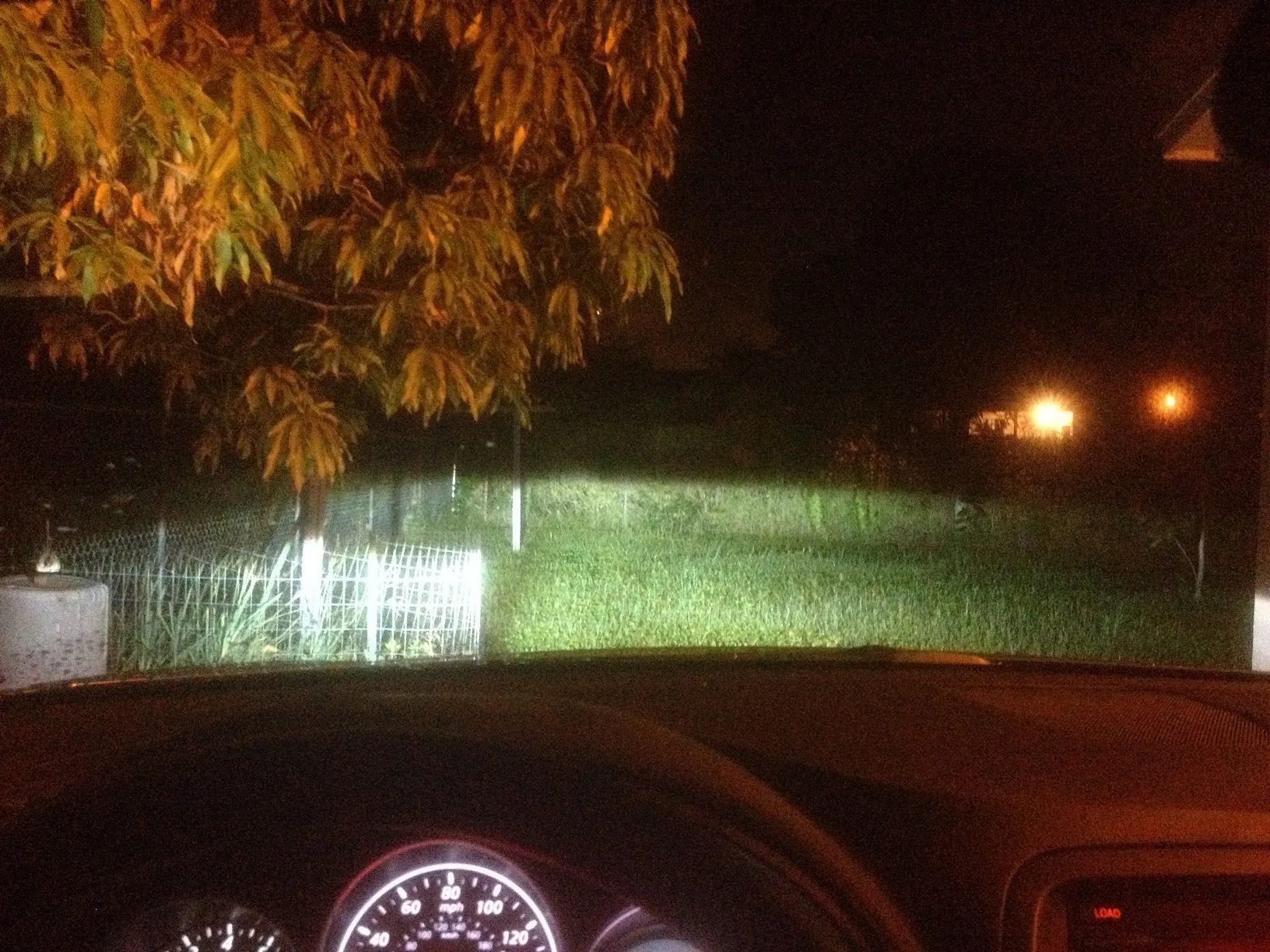

Sorry fellas completely forgot to do an update with my install...better late than never right? Heres my extended use update lol...
Pretty nice cutoff and color (white with a hint of blue)
Head on shot
Sorry for the crappy pics...verdict is I have not had people flash me their high beams and the cutoff is very nice and sharp. Very happy with the results.

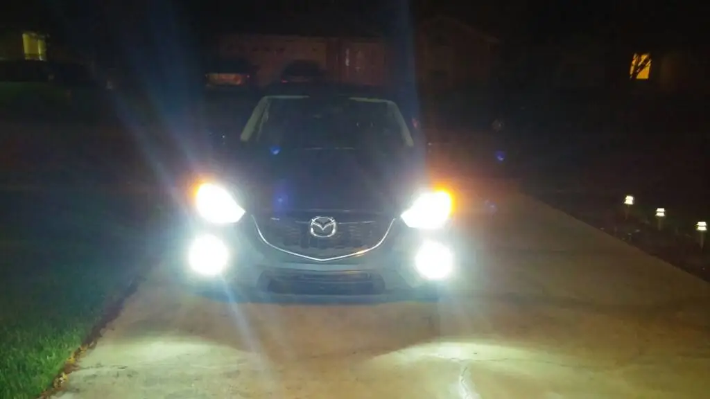

I actually ended up installing mine without the harness. I've had them installed a year now and zero issues. I even installed some LED fogs a few days ago, they're great as well.uploadfromtaptalk1458425250887.jpg
