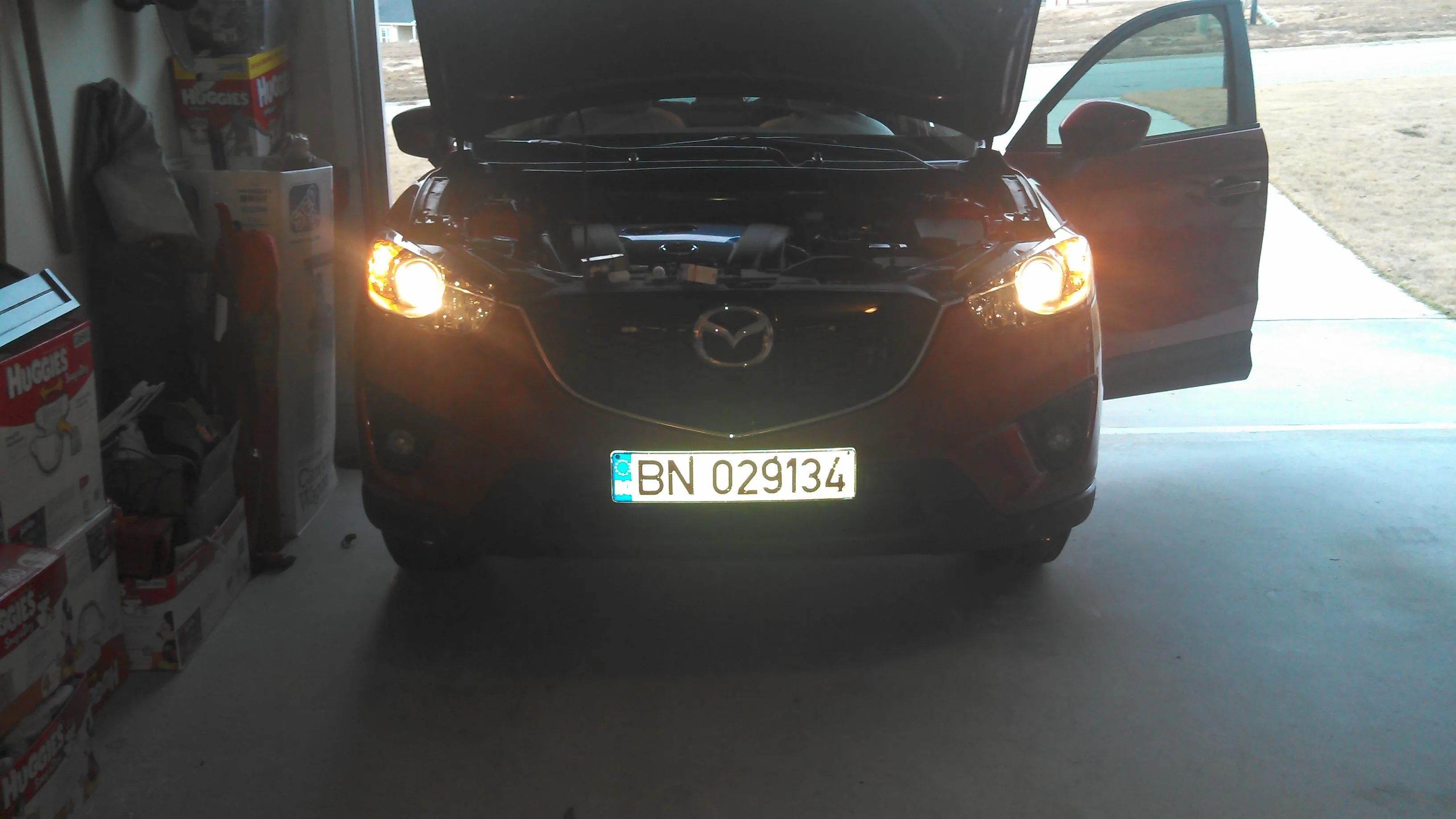

I got the same kit for the Speed3 but in 8000k and it was completely white, only a hint of blue when it was warming up. No one ever flashed their high beams at me, the cutoff was perfect. Having said that if I put it on the CX5 and its very bad I will take it out immediately. I hate when people's headlight blind me (I did lasik and my eyes are VERY sensitive to light). Like I said tho, no problems with it at all on the Speed3. Will take pics when I get them installed. (idhitit)

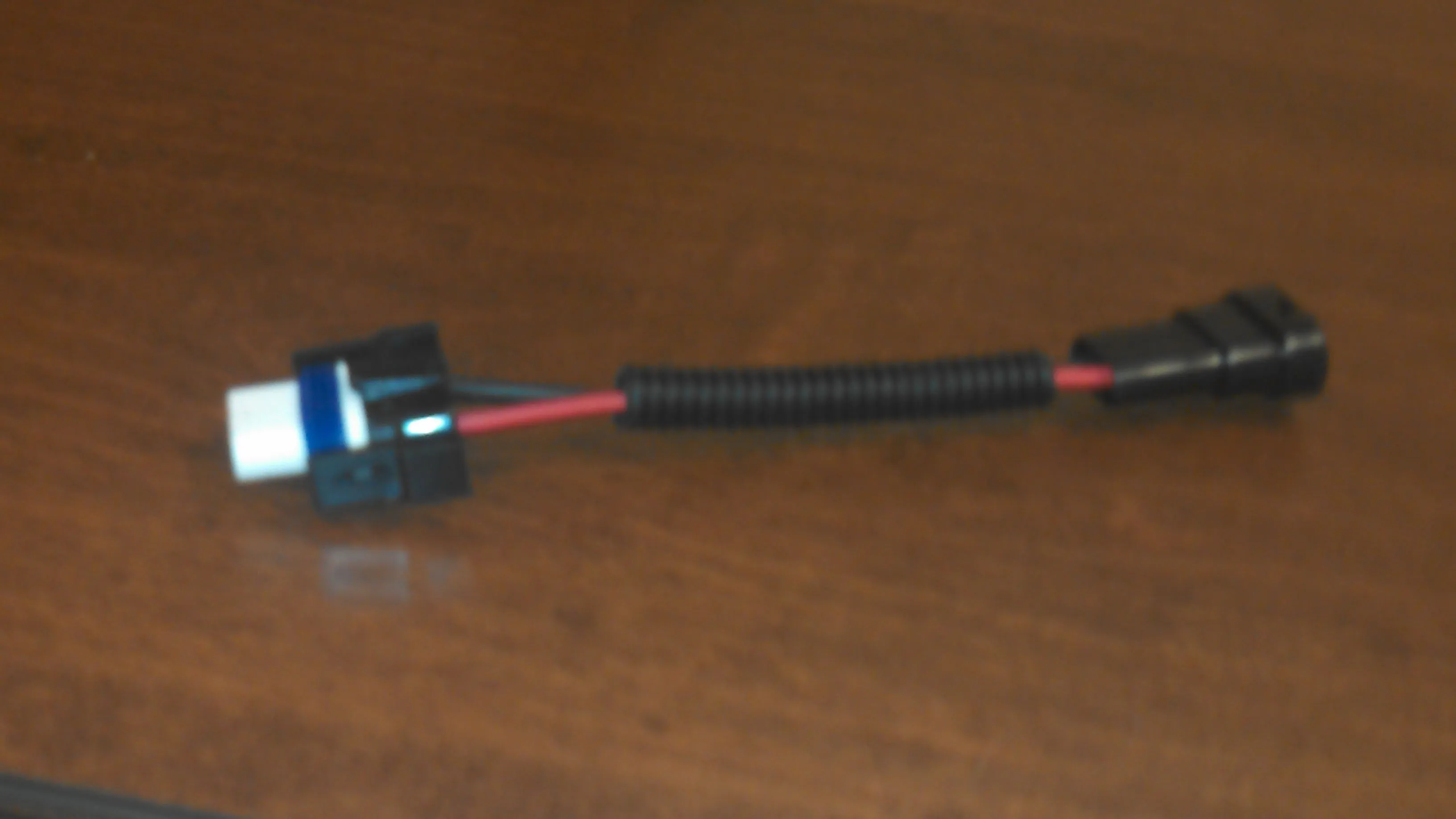

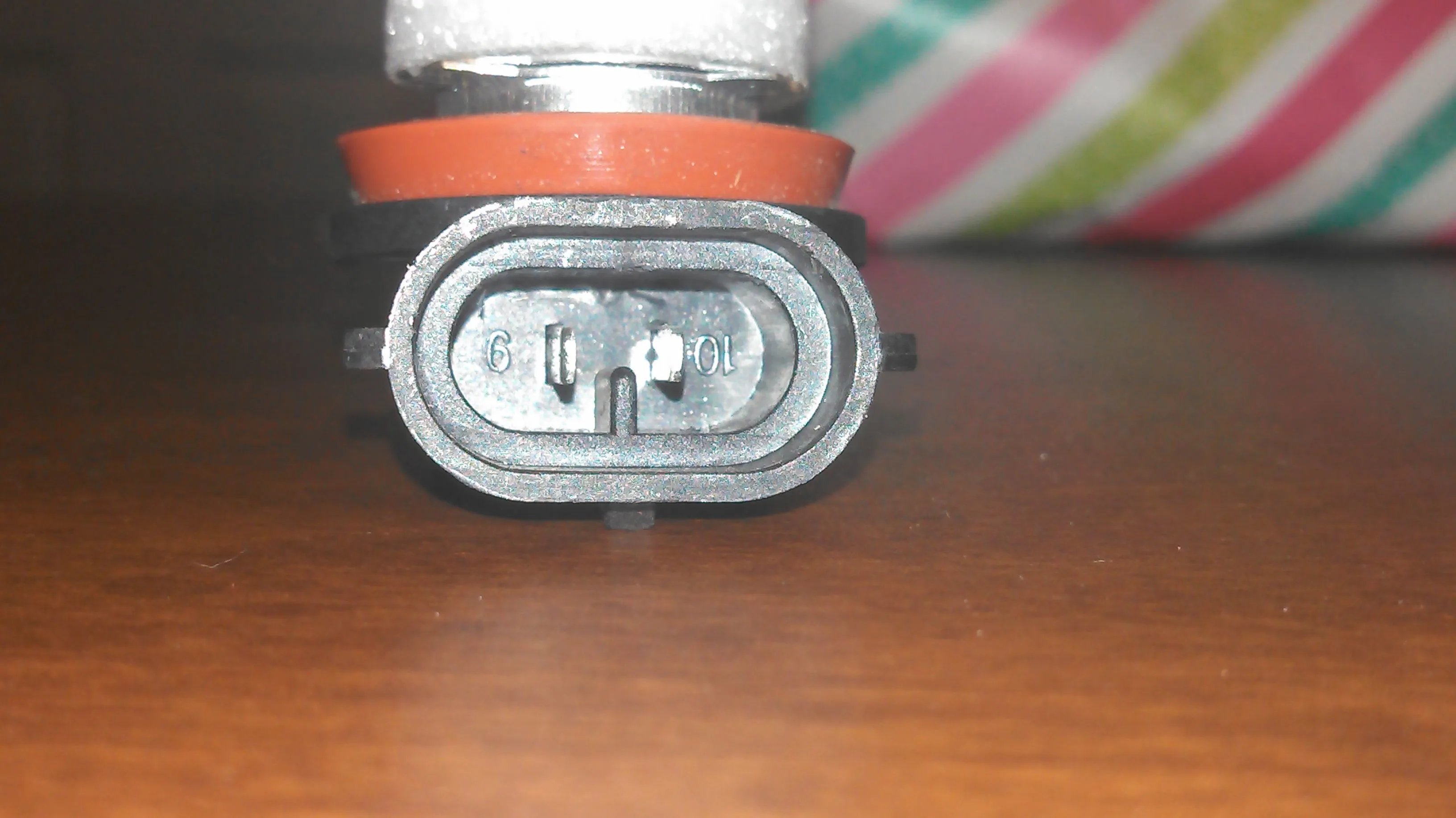

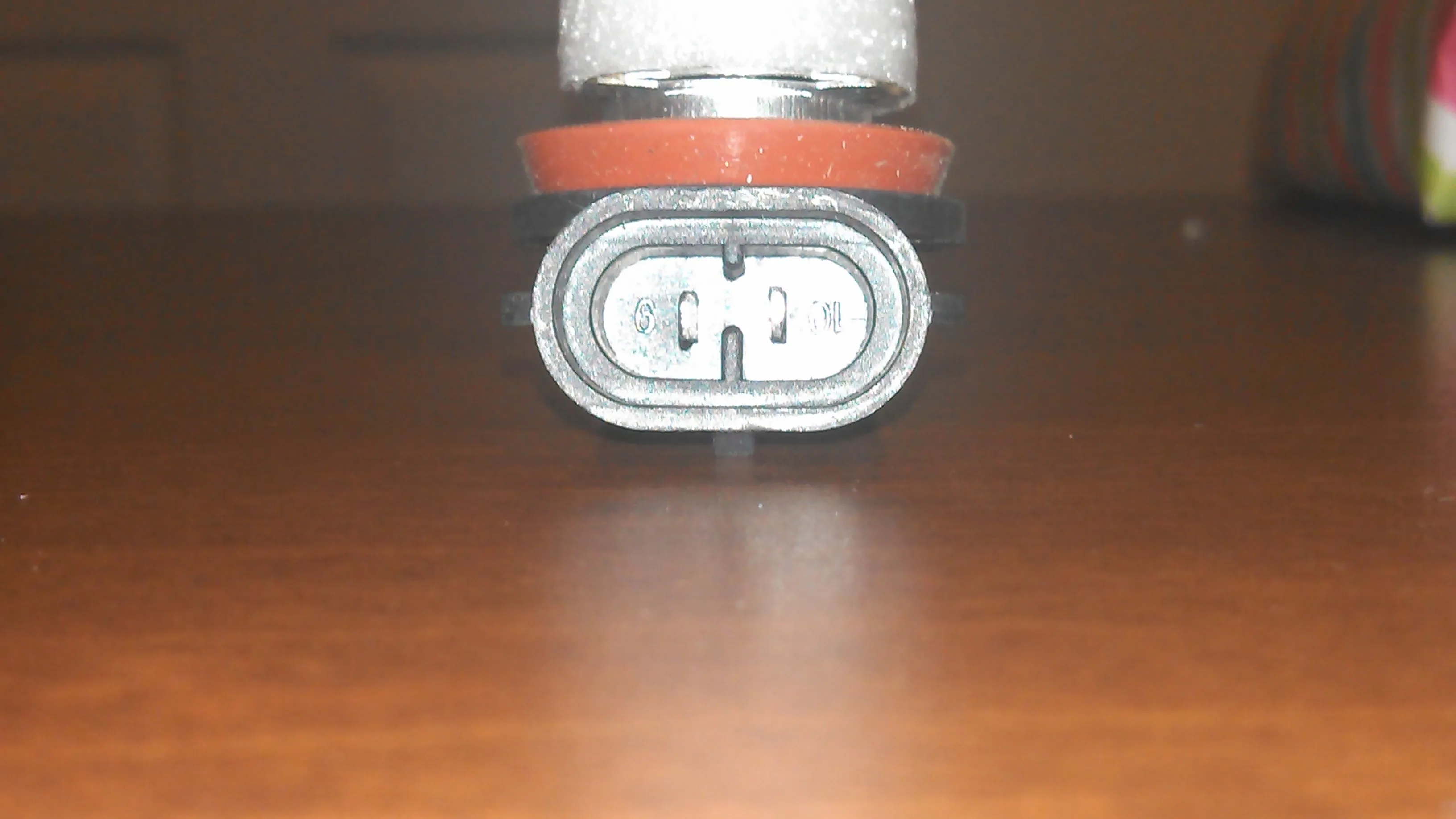

Ok so my parts came in, here are the pictures. All I had to do was cut one tab out of the H9 bulb, connect it to the ceramic adapter (don't want to melt my stock harness), then put them in the oem bulb. On paper I picked up about 900 lumens. I haven't driven it at night yet but will let you know what I think about it compared to the DDM kit. Fogs are stock H11 and I'm leaving them as that, I'm afraid the h9 would melt the stock housing. If anyone else is brave enough to try it let me know how it works lol.
Regular H9 Bulb
attachment.php
H9 bulb with the tab removed. I just used my benchmade to cut it out
attachment.php
ebay ceramic h9 wiring harness (10 dollars a pair)
attachment.php

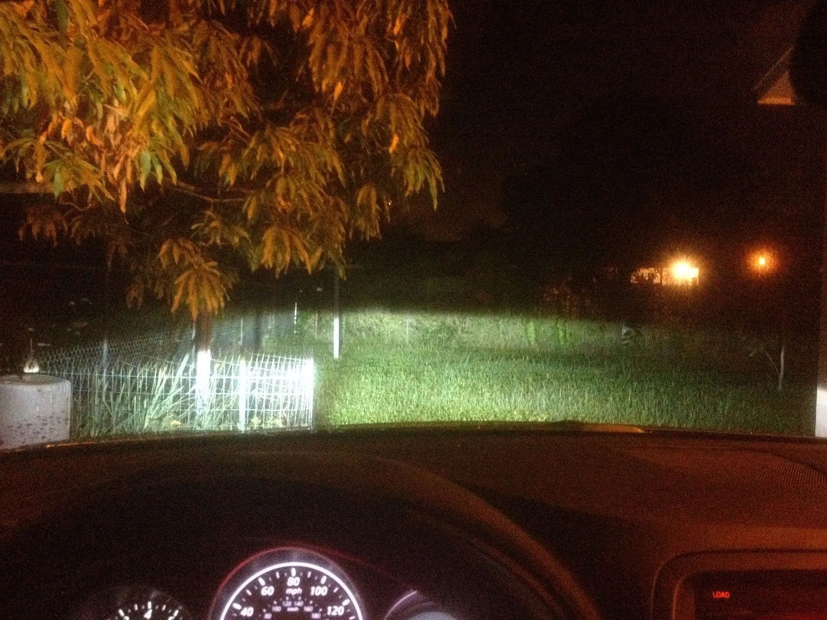

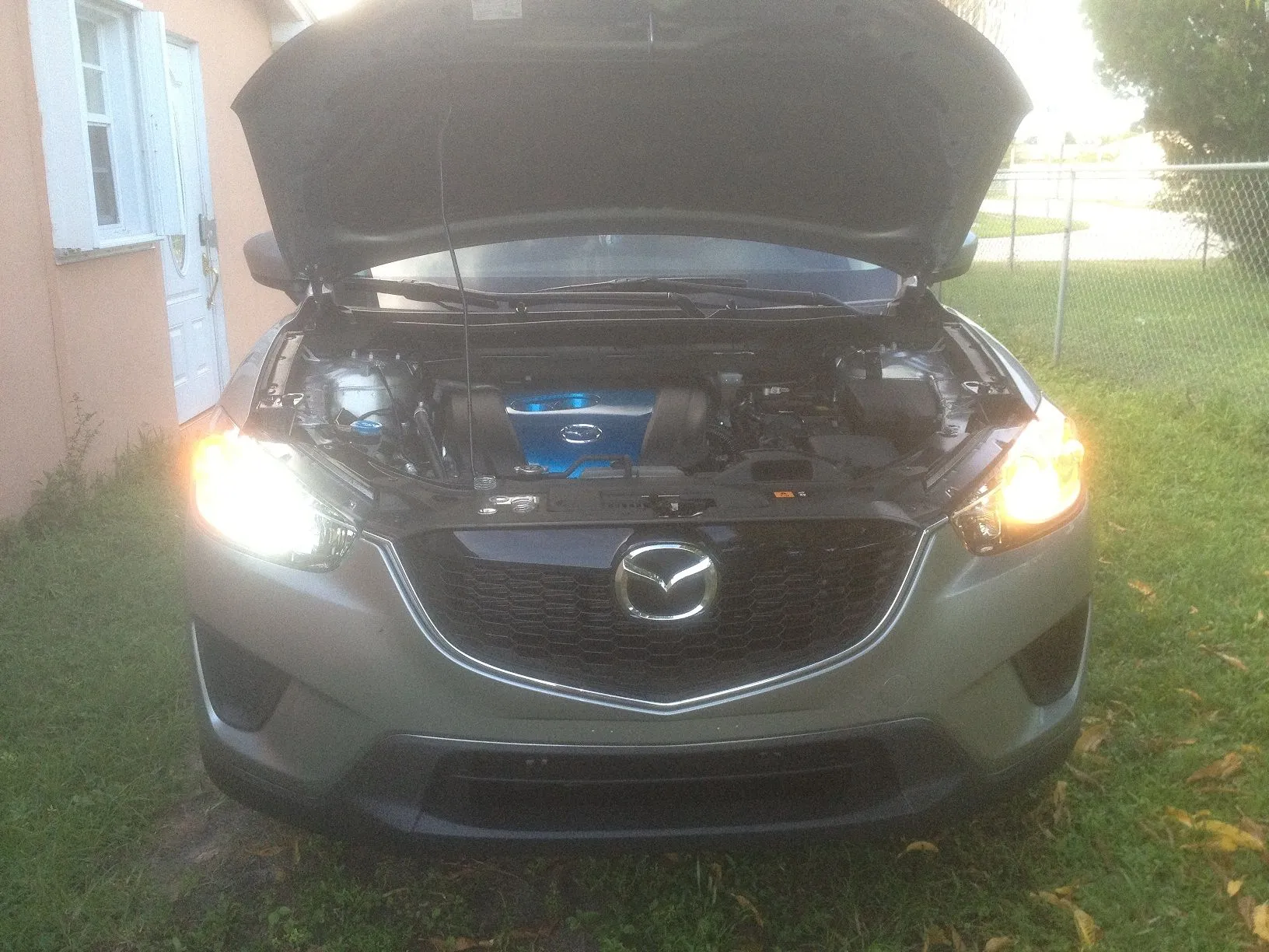

Sorry fellas completely forgot to do an update with my install...better late than never right? Heres my extended use update lol...
Pretty nice cutoff and color (white with a hint of blue)
Head on shot
Sorry for the crappy pics...verdict is I have not had people flash me their high beams and the cutoff is very nice and sharp. Very happy with the results.
