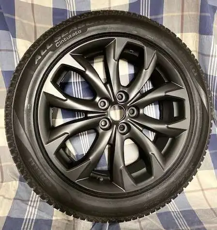

My wheels have arrived. I'm pretty excited and I want to get a coat of Gyeon Rim on them asap. But has anyone experienced wheel weights not sticking to coated wheels?
