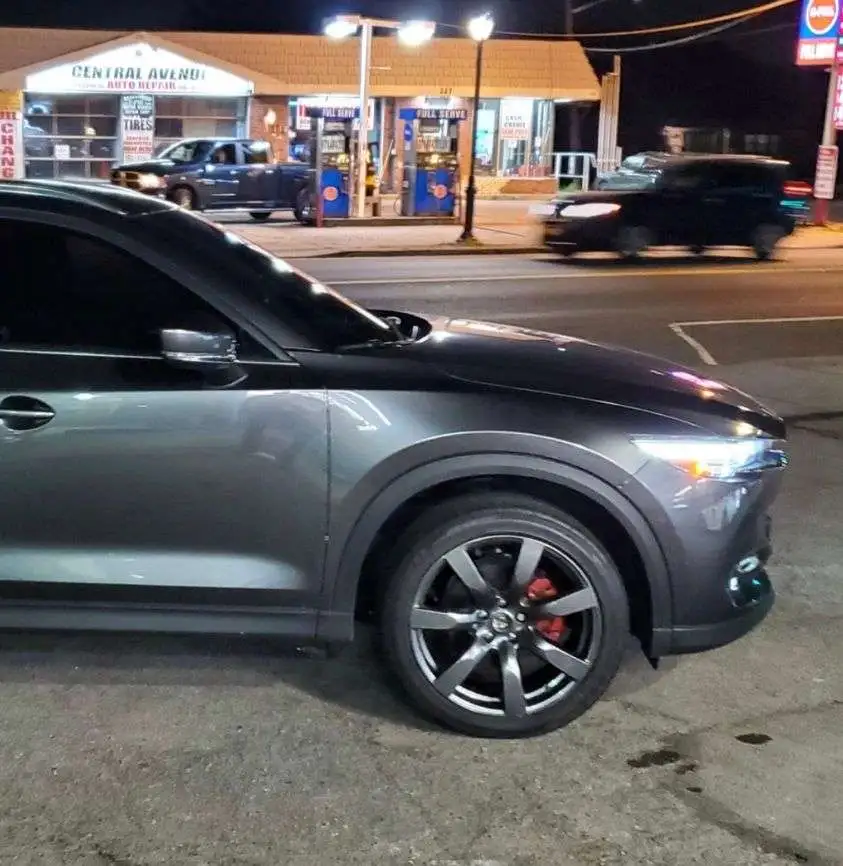

So i finally put on adaptors, 5mm in front and 20mm at the back. the front look good to me, but the rear still does not look the way i wanted it to be. i am thinking of changing them to 25mm at the rear to give me the look i want.
Do you guys think it will be excessive and too much strain on the suspension or will it still be fine.
Ok, so i'm thinking of getting these, but they a bit pricey
My current setup on Gen 1 2016 CX-5
20” 8.5J et45 with 255/45/20 RADAR DIMAX R8+ tyres
5mm adaptor front and 20mm rear
These cost US $1333
Front is 20x9.0|5x114|38 20" 790kg CB72.3
Rear 20x9.0|5x114|20 20" 790kg CB72.3
Difference from current setup would be 7mm further out in front (5J outer and ET2mm extra) and rear (5J outer and ET5mm extra. I don't intend to drop it, but concerned about rubbing and ride quailty. Is anyone running this setup, Front is 20x9.0|5x114|38 and Rear 20x9.0|5x114|20 with 255/45/20.
Would appreciate your opinion on expects on ride quality, rubbing, stance, turning and general ride quality. I think it would be a perfect setup with current tyres though, but just my opinion. I would not need the spacer anymore and i guess safer from that aspect.
Or i can just change my current rear adaptor from 20mm to 25mm to give me the look i want and costing only $115

Not going to comment on pushing it out further as I try to stay as close to stock spec as possible.
But in terms of benefits versus cost...
That's alot of $$$ to spend on new wheels for what's already 6 year old vehicle. Save that money to put towards your new ride.
If you must push it out further, why not go the inexpensive $115 way?

Thanks for your very honest opinion, i think you might have swayed me 👍👍👍
